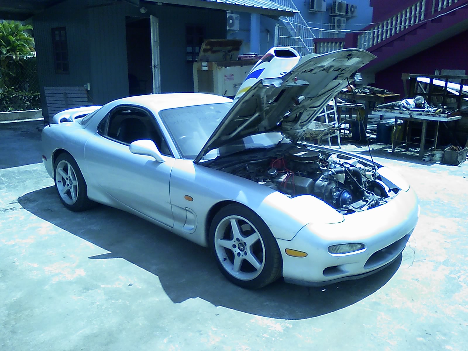

Anyways, pops and I have decided to "try out" the V8 setup before pulling it out. With that said, she was dropped off by V8 Boys on 12th July for some work to be done and come out as a potential daily driver/ gas guzzler. All amenities like A/C, power steering etc etc and a proper working V8 powerhouse.
Coilovers should be in hand within the next week or two to lower the back, stiffen the front and transfer some of the weight to the back, hopefully gaining traction.

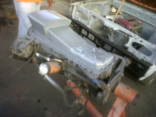

Safer to rebuild the sump, if you need someone to do the work, i can point you to someone, he does really good work, but is located in Pt. fortin
Here is a pic of a oil sump makeover for an rb25 in a van, did not want to mod the subframe or cut, so i just wanted a quick make over thing, nothing neat or fancy, so you can get work to perfection from him if u require it, but to me, nobody is gonna be looking at your sump anyway

Good work considering sumps are a touchy thing to weld

Postby TeamH2O » June 3rd, 2014, 8:43 pm
Yea it does take some time to figure out how to do it, but if you notice too, my one slightly bigger on the relocation as I wanted 2 more quarts to be held in there without flooding the engine, this was for heavy cornering (or drift) purposes

Postby Ted_v2 » June 3rd, 2014, 8:59 pm
How's did the oil pickup work with the mods? Extended or stock?

Postby GTR Fever » June 3rd, 2014, 9:24 pm
That sump looks good! Ideally I want the same thing, a quart or a little more extra since it will be pushed hard.
The oil pick up will have to be modified to lie wherever the deepest part of the sump is so it will have a easier job of picking up the oil.
