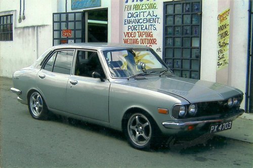

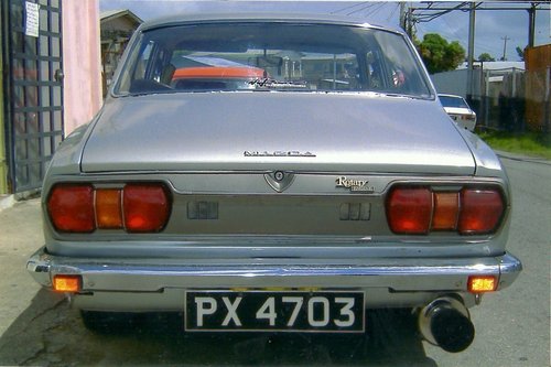

Take a look at this an tell me what if it is an rx2 or 616
gready123456
Posts: 332
Re: RX2
Postby gready123456 » May 17th, 2014, 2:16 pm
milkboyz wrote:Take a look at this an tell me what if it is an rx2 or 616
616 hehehe

The 616's seem to have a bit of a prominent point to the front of the bonnet and bumper, compared to a flatter faced front on the RX2's. The older REs have the rectangular headlights and the later ones the double circular ones, like the 616.
Whatever that is above, it looks fantastic!!
