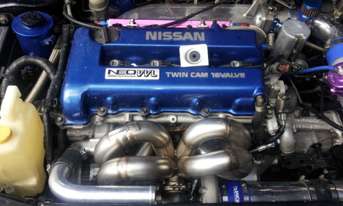

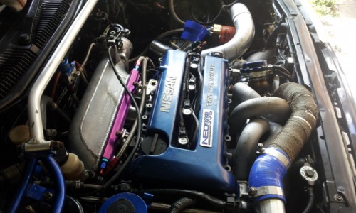

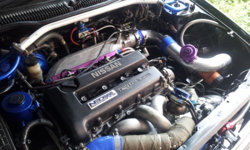

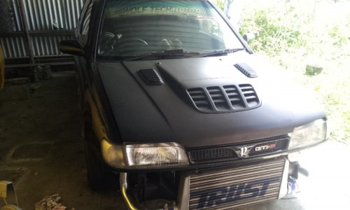

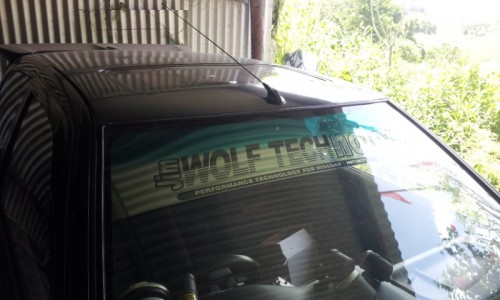

Yea tuners jus wanted to show a lil pics of my brother Nissan GTI-R Pulsar it's in the process of being put back together an should be ready for the tracks by early next year.This Pulsar is the fastest Pulsar that have ever run in Trinidad in a time of 10.84 sec at 111mph in full street trim. The car is fully powered i.e. mirrors, windows, sunroof fully functional with full interior it was also using a JWT ecu an airflow no standalone management also was using premium fuel with the assistance of an aem water/meth kit this car has never been to a dyno so cannot say what hp it was pushing the car was road tuned by our friend Lyndon aka Spartan Performance.This pulsar was also the first in Trinidad to be using a vvl head on a GTI-R block which all the fabrication was done by my next brother Narry which also did the body work an paint job.This car was also build from scratch by my two brothers they did all the work themselves on this car an still does an their profession is milking cows an selling milk lol.Alot of help an assistance also came from Stepfan aka Fugitives aka TTMN he was there from the begining of this build he might even know more about this car than me lol but here are some of specs that i could remember:
Foreign used Stock vvl head no head works whatsoever.Standard size block sleeved locally with forged pistons stock rods an oem crankshaft.Apexi metal head gasket ARP headstuds RC 1000cc injectors . A custom intake adapter was made to bolt on the 4 trottle intake manifold on the vvl head.JWT upgraded ecu with matching Ford Airflow
Custom turbo manifold T60-1 Turbonetics Turbo Turbosmart 44mm wastegate.PAR Engineering gearkit with Act six puck copper single disc clutch an Max Extreme pressure plate also Act.Large front mount GTI-R intercooler kit.AEM water/meth kit 4 fogger nitrous kit NOS brand Aeromotive fuel pressure regulator Bosch fuel pump.Stock fuel tank an fuel lines.Stock axels an rear end.3 inch exhaust from front to back.
ndard size forged pistons with rings

How much nitrous?

Was using 100 hp nos

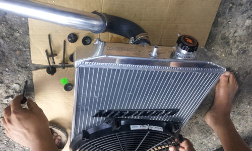

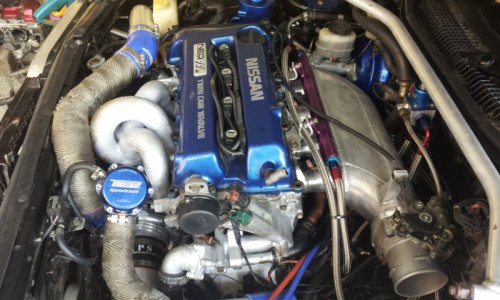

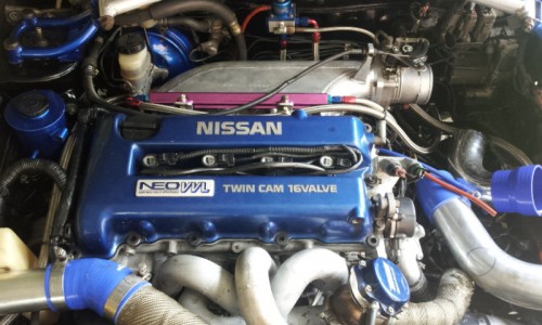

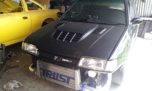

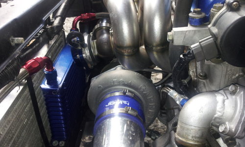

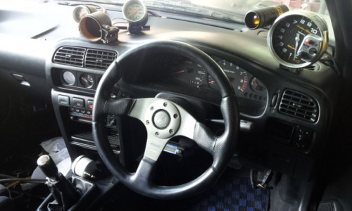

Took a couple of more pics today Tial 50mm bov installed an 3" intercooler piping fineshed on intake side.Godzilla was also wired up yesterday by one of the best electrician in trinidad that is Marvin from Point.The pulsar should be started up by the end of this week.More updates to follow

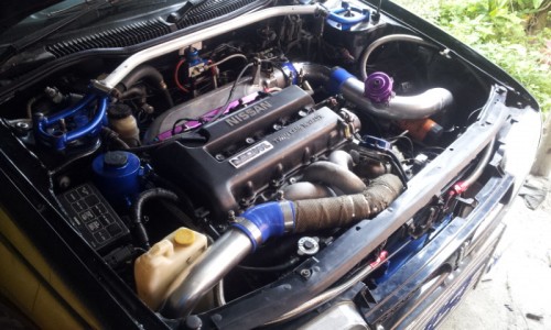

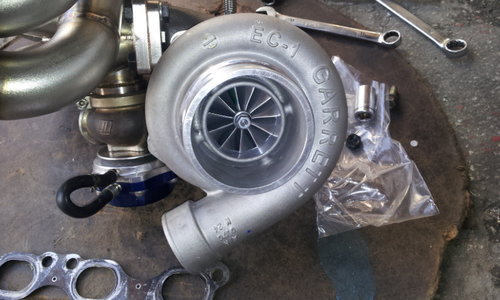

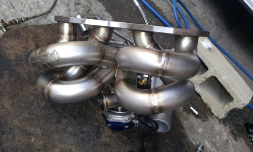

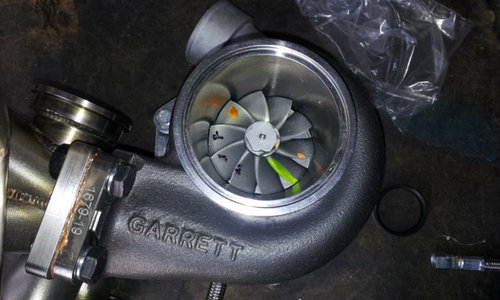

Some more items were purchased an already installed just trying to locate a good intercooler now.

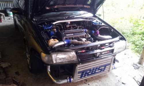

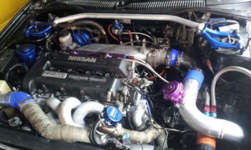

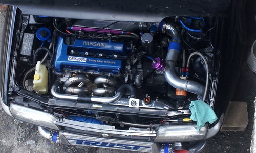

Postby milkboyz » March 7th, 2015, 9:24 pm
This is how it is now

love that manifold, cant wait to see it on the streets
