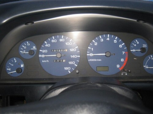

Re: A31 daily/project...
Postby Ted_v2 » June 25th, 2013, 10:02 pm
Rb25de is a pretty good daily. Easy on the gas and puts out decent power. You can try getting some S13 shocks and springs to replace the a31 set. They drop the car.
If your working inside the car the skyline R33 cluster fits in with little mods.

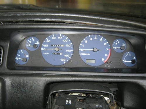

Postby Ted_v2 » June 25th, 2013, 10:19 pm
That's what you need. See in the a31 group on Facebook. They usually sell parts cheap and everyone is pretty helpful. I usually get some rb parts from the members
Postby Ted_v2 » June 25th, 2013, 10:34 pm
First pic is in a cifero. This is in a skyline R33
