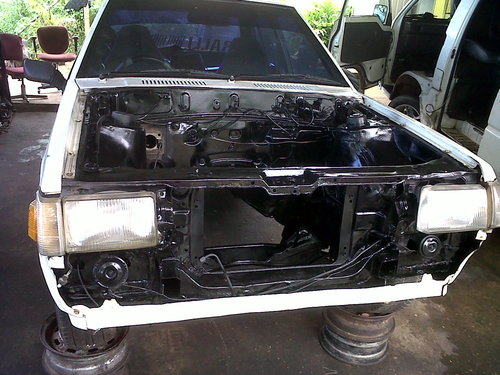

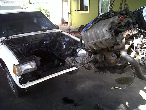

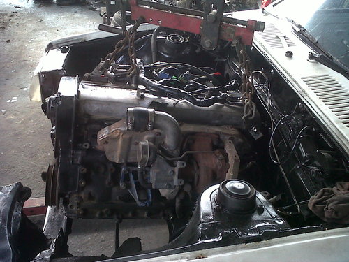

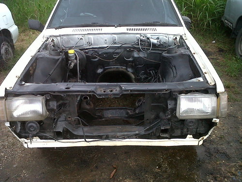

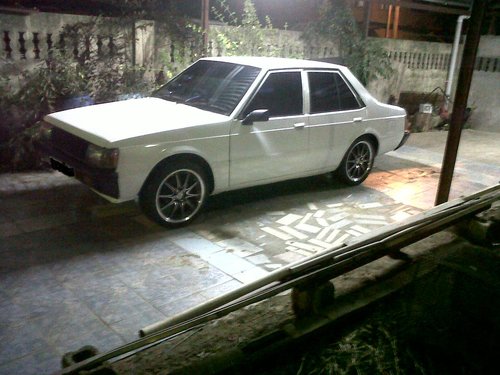

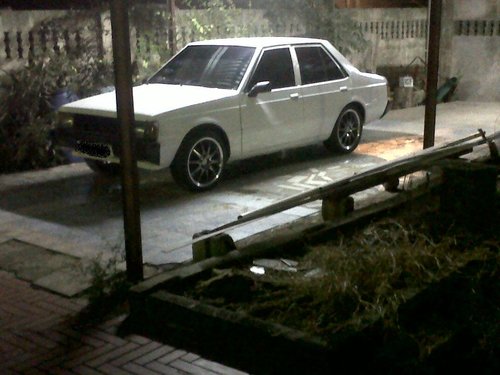

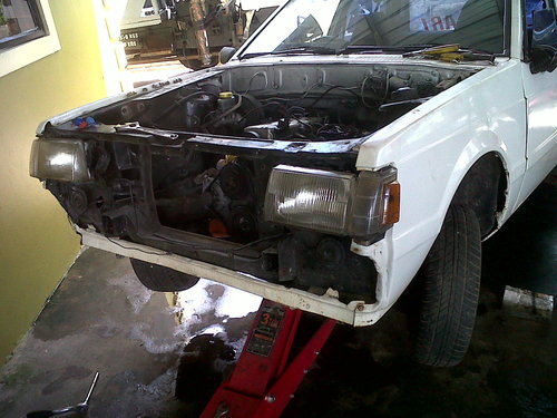

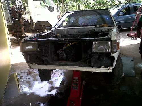

some pics have more to come
scrapping old engine
this is before i started the project
moti
Posts: 4812
Location: looking for Perry!
Re: can a entire s13 rear subfram work on a box lancer??
Postby moti » November 30th, 2012, 9:43 am
nice car dude
cookiemonstar
Posts: 110
Joined: June 21st, 2012, 1:37 pm
Postby cookiemonstar » November 30th, 2012, 9:47 am
cookiemonstar
Posts: 110
Postby cookiemonstar » November 30th, 2012, 9:54 am
measuring up to cut
