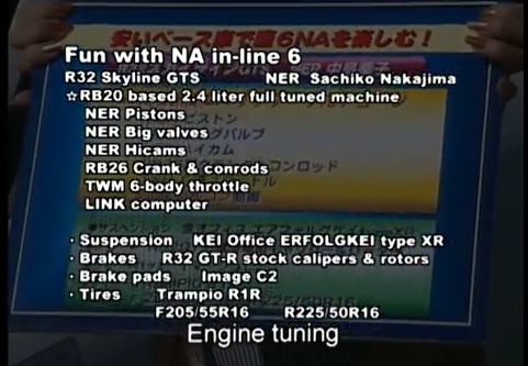

Bezman
Posts: 6635
Re: 240Z engine swap Polll
Postby Bezman » November 23rd, 2012, 10:46 am
The one and only option in my mind... you can easily find the parts and once tuned right it will sound like a mechanical orchestra..
Screen shot 2012-11-23 at 10.42.49 AM.png (230.66 KiB) Viewed 5678 times
you will see the engine in the first skyline in this vid.. instead of machining your own intake, use RB26 intake manifold on 48mm Jenvy ITB's ;)
But honestly, you can make anything fast and do any swap, depending on how you building it, a L28 with tripple side draft webbers would be epic too ;)

Bezman
Posts: 6635
Postby Bezman » November 23rd, 2012, 12:20 pm
Razkal wrote:^ent? the logic is flawed.
imo, it goes like this, sr is nice, but boring, end of story.
a 240z is a car full of history, passion and the envy of enthusiasts the world over...don't strip away it's essence with a hum-drum everyday 4 banger.
you said its gonna be a cruiser not a racer right? well i'd vote for an RB without hesitation, hands down its the best sounding jap 6 available, makes easy power, and is easy to work on.
handling isn't that compromised and as you aren't gonna race, i don't see why it'll be an issue.
a cool RB build will be a 25 with a 20 crank and a 30/71 or 76 snail...300 six cylinder ponies is way more fun than 300 4 banger giddyups. :P
i vote RB and modern F/R suspension gear!
RB20 block, RB26 crank (better oiling) ;)

Bezman wrote:The one and only option in my mind... you can easily find the parts and once tuned right it will sound like a mechanical orchestra..
L28 Carbs
http://www.modified.com/features/sccp_0 ... ewall.html
Stroked L30ET
http://www.superstreetonline.com/featur ... mport_car/
Oh snap, this dude know what's up.
Stroked 2.4 RB20 with model number removed off of the front cover to keep people guessing.
Fairly cheap and is a retro build keeping in theme with the Z's original straight 6/Nissan/2.4 heritage.
