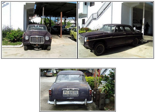

my old school project is moving on vey slowly .. but moving... check it out
http://www.cardomain.com/ride/3054676

Thanks x2...i know where u are so ill b in consultation..and im putting your project in the ttv8 thread also...if its ok.....good luck with the resto/mod

whoa son, that's alot o rust :!:
X2Board
Posts: 1014
Joined: April 18th, 2003, 7:53 pm
Location: working on this ^^^ project
Re: Old School Projects
Postby X2Board » July 29th, 2010, 9:13 pm
bigchief3679 wrote:whoa son, that's alot o rust :!:
yuh know they came from the factory with rust as an option right?
Posts: 23908
Postby MG Man » July 30th, 2010, 9:26 am
you had to pay extra for dat
