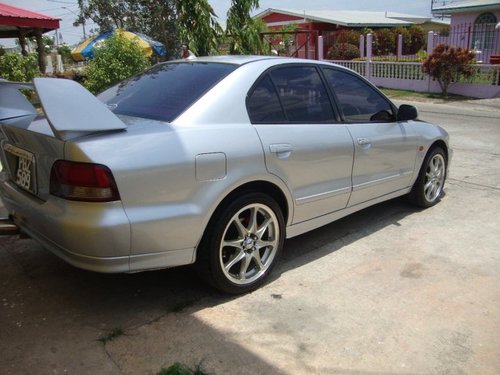

Ok fellas, i did a vrg to vr4 conversion last year and i am really pleased with the car's performance so far, really impressive. However, i cant help but be tempted to upgrade the car... Ive done some minor things such as installing a copper clutch, and a walbro fuel pump. I would like those who have experience/ knowledge with these builds to lend some advice to what performance upgrades i can do to the car you know, do's and dont's... The car has stock boost at 9 psi, never raised and stock vr4 brakes, vr4 suspension... Feel free to give advice. 8-)
Lets see where this goes... Thanks guys. Image Image

Postby tripplediamond » February 15th, 2010, 10:58 am
Two pics up fellas :D
Postby Monk BANzai » February 15th, 2010, 11:25 am
ohhhh this is the car i've been hearing about....ok ok....nice man.....

Postby tripplediamond » February 15th, 2010, 12:39 pm
Yea banzai... thanks, i didnt know your car was a conversion? Or is it?
Very helpful information there.

Postby Advil » February 15th, 2010, 9:03 pm
tripplediamond, ur engine bay looks really neat though, well done, no wiring hannging all over
