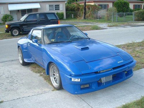

Don't listen to those fellas above... This kit if very rare and you seem to have the complete Mariah package with wheels etc. My advice to you is repaint the entire car, and redo the suspension. Leave the kit on there! BTW, everybody and dey mother have the ZG flares.. smh
Re: My First Generation RX7 Project
Postby eliteauto » January 25th, 2014, 7:28 pm
agreed, allyuh clearly eh see the pic
beautiful!

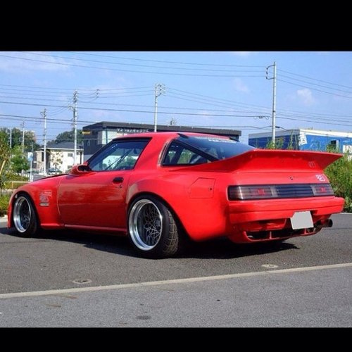

The trick to making a widebody FB look awesome is the wheel size/offset & the stance. You don't need to buy that expensive rear coilover kit you posted above. QA1 makes a kit for the AE86 that will bolt into the rear shock tower of a 1st gen Rx7. It can also be customer valved to suit your needs. Call Luis at ParadiseRacing.com and he will sort you out. Tell him I sent you
I don't think the rims you have now will do the kit justice, unless you add some spacers to bring it out a little. You might need to play around with different wheels to get the right offset. You want it on the edge, with a little tuck.

CCW's on this widebody.

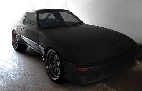

a lil time in the studio
had a lil time to think, research, talk it over and was thinking,
Swap to five lug using the FC TII front lower control arm, spindle, hub, brakes, shock/coilovers, steering/sway bar linkages etc and re-drill the rear to 5 lug..
Front: 17x9 ET+0 5x114.3 - 225/40R17 Toyo RA1
Rear: 17x10 ET-15 5x114.3 - 255/40R17 Toyo RA1

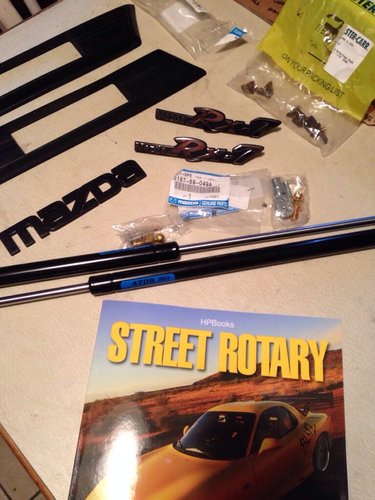

Got some side trim. A few of the decals, the complete interior plastic trim, the rotary tuner book and random clips.
Still got lots to come in... More books, interior trim and switches. Small things.

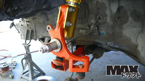

I think I am going with the FC knuckle, spindle, hub, brake, shock strut swap.. like the photo below:
This is the way allot of JDM SAcc2's are done over there, I am even thinking of getting the Techno Toy Tuning FB/SA adjustable lower control arms and using those for more adjustment. Very close to piecing all of this together.. will post updates when I start to put it on the car.
RoTaRyBoYz
Posts: 2127
Location: NYC
Postby RoTaRyBoYz » February 3rd, 2014, 12:16 pm
Yep, the FC subframe swap requires you to drill 2-4 holes into the frame rails. I don't remember the exact details as I did it 6-7yrs ago, but it wasn't anything overly difficult. I only did it bcuz it allowed me to easily expand my options if installing different motors (RE, 20B, etc.).. It also got me away from the old steering design that might cause a problem to find parts in the future etc.
If you go with the route you suggested, how do you plan to work out the location of the tie rod attachment points? IIRC, the FC knuckles have the tierod positioned forward & the FB positioned towards the rear.

Rotaryboyz. They swap them left to right. So the tie rod is at the back instead of the front and mounts the opposite way. Iirc. I had to do the same for my datsun 1200 using s13 knuckles/hubs etc
RoTaRyBoYz
Posts: 2127
Location: NYC
Postby RoTaRyBoYz » February 3rd, 2014, 1:00 pm
Hmm got it.. Keep an eye on your Ackerman angle bcuz that's very important for a street car. A lot of race cars & drift guys can get away with it being off but it tends to be more noticeable at low speeds. That's why I'm a bit cautious about swapping knuckles left to right.
