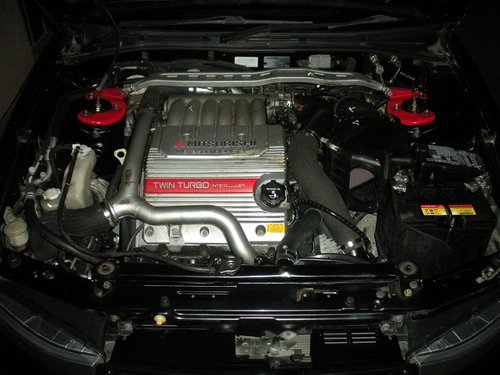

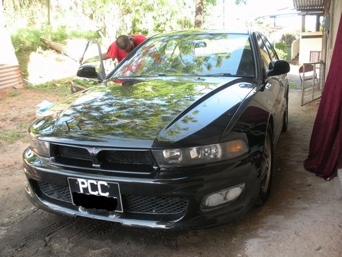

this is my project..finally got after so long, still hadda do d exhaust so it eh finish yet.
d engine still need a lil cleaning but it gud for now.

Postby Monk BANzai » June 25th, 2010, 10:45 am
nice man....tiptronic or manual?
when you ketch yuhself, conisder redoing the dowpipes to 2.5 inch into a 3 inch collector, and if you can, reposition th battery so that you can work on the intake and get a more fluid flow of air (and colder) from the front of the car. Key is to make the engien breathe better. You'll be quite pleased with the simple work to get the air flowing in and out of the air pump (engine).
What spring/shock setup you using though? car looks lower than stock..

Postby ralliartvr47 » June 25th, 2010, 11:41 am
its manual. im planning on putting d battery in d trunk so i cud get room for d intake. i wanna change d intercooler later on, but first i wanna put in a boost gauge.
i got a set of tein shocks and springs with d front cut but it not adjustable. d back is more-or-less d original height but d front lower and it riding nice still. i get a lower arm bar wit d front cut also and it blue but i dnt think is cusco.
if u want i cud get d part# on d shocks for u.

Postby Monk BANzai » June 25th, 2010, 12:50 pm
boost gauge and A/F meter....get an O2 sensor....doh mix matters with that...esp if you plan on playing with boost levels...stock is 12 or 14lbs i think....
