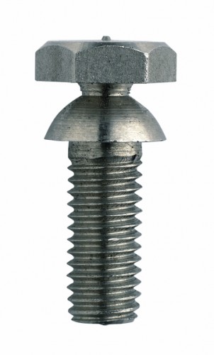

You changed the ignition because you not taking chances, but you cut a groove in the security bolt to use a screwdriver, and showing everybody? Why not buy two of the original snap off bolts(shear bolts) and really secure your ride?

Robert whereabouts can I acquire these 'shear bolts' I will gladly get them and also what is used to run them up good and tight? Please enlighten me. Once I know it will be an easy swap, I know you should know being in the repair business.

Check CJ engineering or N&M ,I got them by N&M. already.. If not You can make them. How I do it is to put a nut over the bolt head, and weld inside the nut hole, you then tighten until it breaks off..this way nobody going to remove your ignition lock with a screwdriver.

Ok thanks, will check Neal and Massy and see what they say.

If you don't get through, pass by me i'll make two for you.

Yeah, saw some here as well, will check Massy first.
http://www.ebay.com/itm/NISSAN-MICRA-NA ... 19d7102317
