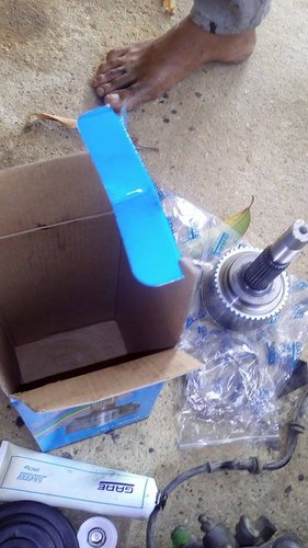

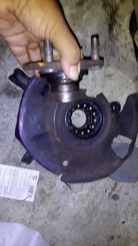

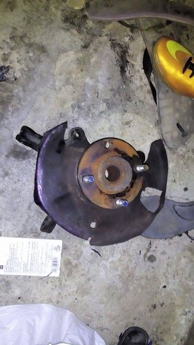

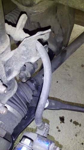

Postby avimadvibez » April 2nd, 2016, 11:18 pm
Got to doing some serious work this easter week. Knew i had a bearing problem, so I decided to gut out the front and and start fresh, meaning new joints, hubs, bearings, ends, bushings etc, and installed the new control arms and brakes.
The car is now basically back to 100% working order in the front, meanwhile as for the back, still have to change shocks but coilovers should arrive soon, and I also got my hands on a pair of original OEM rover 200 rear disc brakes, just to install.
Plenty pics to upload but tuner is currently undergoing its v4 update so pics arent loading right now, will post them soon

Postby avimadvibez » April 7th, 2016, 9:23 pm
some pics from the front end work

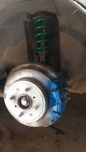

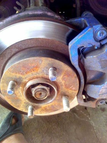

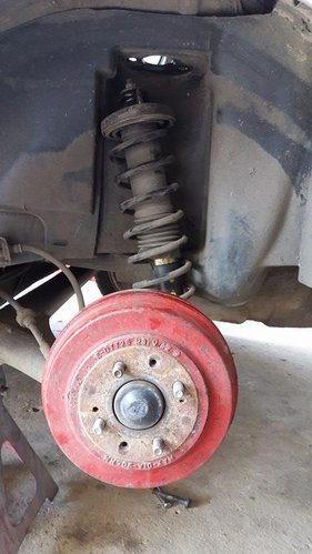

Postby avimadvibez » April 8th, 2016, 9:36 pm
Got to installing the rear disc brakes and rear coilovers today.

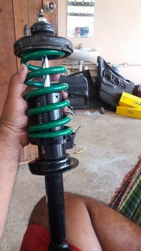

Postby avimadvibez » April 9th, 2016, 4:25 pm
BANzai Rastafarai wrote:Rear coils?!?! do tell good man!!! from whence did you procure such goodness?
lol dont mind me. Its just coilover sleeves on tokico b14 shocks. The height of the b14 shocks allows for a drop with the coilovers without compressing the shocks too much since they're shorter than the original rover shocks. Just used back the original strut mount and came up with that. No rough ride no cut springs no bottoming out, and an automatic 2" drop to start with. can still go 2" lower.

BANzai Rastafarai wrote:share the details her eif you want... or inbox me. Prepping the car for track/street use.... so yeah it will help...
i eh want everybody to be rocking my secret na....lol jk. so long as allyuh interested lemme shoot out some info.
i not sure about allyuh suspension, but mine carrying b14 shocks and spindles in front to use original axles n joints etc, and i use the b14 back shocks with the original rover 200 shock mount, as its basically a mount frame with a double pieced bushing in it.
Since the b14 shocks in the back are shorter than the original rover 200 shocks, the coils didnt have to set too low to bring the fender down to the tyre. eg8 shocks are also an option but they are a bit longer.
for the front, im not sure what the original lenght of the rover 200 shocks are, but with the b14 shocks, the coilovers were set at the same increment and magically the front was level to the back :lol: :lol:
for the coilovers i used a cheap pair from DNA Motoring as i was a bit skeptical on them since they had so many mixed reviews, but I know now it depends on how you use them. obviously if you set it very low, you are going to end up with a seriously stiff ride, especially if you're running on stock shocks, but its very comfortable for me, while also being very stiff so rough roads and potholes are definitely your enemy.
heads up when buying the coilover springs, they are heavy so expect shipping costs to be in the higher hundreds
