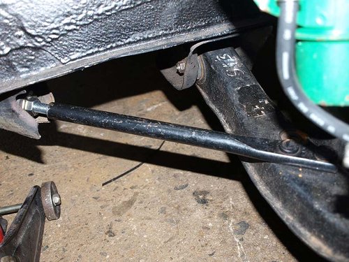

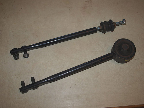

Custom Adjustable S13 Tension Rods
Got some S13 tension rods, cut off the ends and got a buddy with a machine shop to drill and tap them, replacing the bolts with some grade 8 hardware and will be back on the rd! These are adjustable so i can add or remove as much castor as i need.

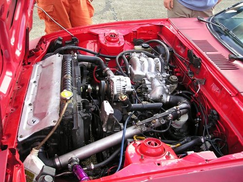

a photo of the engine
but these fender flares of the photo are not rubber?
or fiber?

I need your help
my ca18det non starter
I just got this installation and those parts that are in the photos I turn everything to turn the engine but not enough battery power candles
Anyone know please help me?

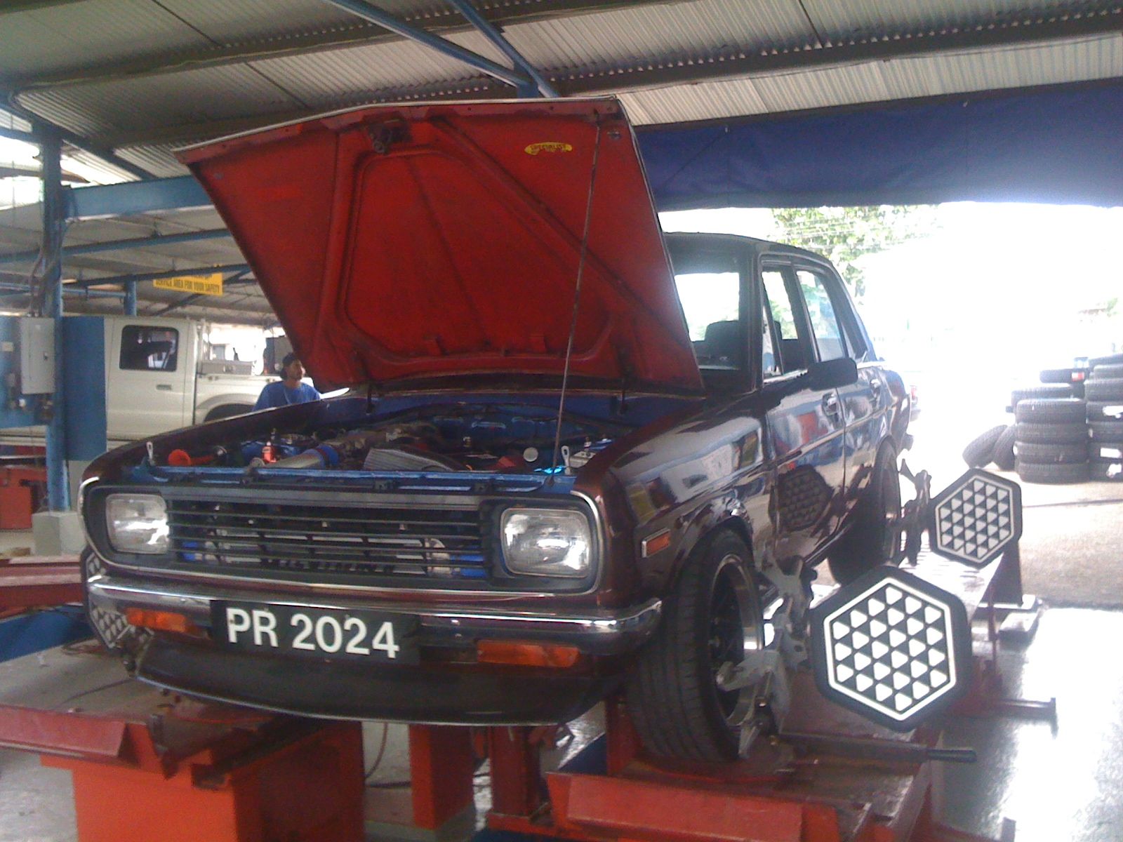

Postby Bezman » December 15th, 2010, 8:37 pm
Bezman
Posts: 6635
Re: CA18 Datsun 1200 Sedan - New Footwork!
Postby Bezman » December 15th, 2010, 8:49 pm
Took her for an alignment yesterday and she is driving like she is on rails now, still not confident enough to go throwing it in and out of corners on the new suspension i installed in my garage :lol:
