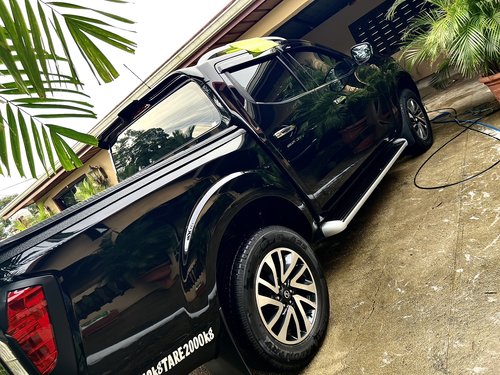

this is the current state of my paint after correction and ceramic coating
to keep it swirl free; buckets with grit guards, different cloths, drying towels, wheel woolies, brushes, never reuse the same cloth either
Nerta active diamond for soap, Air Cannon for touchless drying, ceramic maintenance spray to keep it slick
real simple and effective

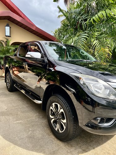

Havent posted in awhile. Worked on this one today. Paited last week by a guy in diego. Want to get his info because the work is better than moat that i see.

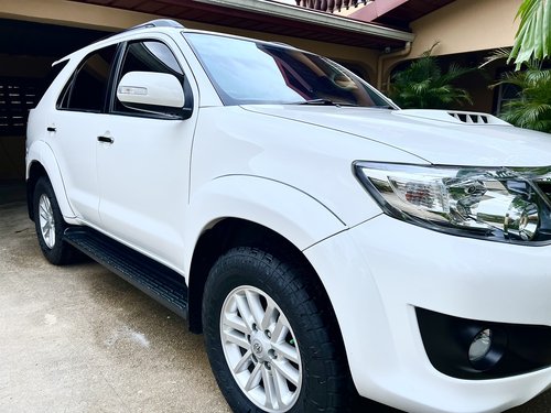

Postby nick639v2 » December 10th, 2022, 6:45 pm
Straight out the camera. the cloudy sky lighting did magic lol
Nerta diamond touchless wash
3d car care Spray wax contact wash
3d wash and wax
(Trying this brand out since my Adams stuff are running low)
Still have some repairs to do before I paint correct this but I can still get it to pop with minimal effort.
Last edited by nick639v2 on December 10th, 2022, 6:45 pm, edited 2 times in total.
nick639v2
Posts: 2754
Re: The Official Car Care Thread
Postby nick639v2 » December 10th, 2022, 6:57 pm
Update on this, 8months in the ‘free’ adams graphene advanced coating done by me
3week interval of wash maintenance
Adams megafoam pre wash
Adams wash + coat contact wash
Adams CS3 drying aid.
No real degradation of coating so far with regard to beading and water repellents, the water spots are what’s killing me because of work I have no choice but to leave it to bake on sometimes.

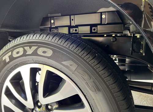

This was my test vehicle for my personal comfort of alkaline soaps, the work van, 18 month of nerta touchless washes followed by monthly cheap spray waxes etc. No touching and 30mins to finish. This van is heavy use and uncovered most times. Still comes out ok but due for paint correction
Verdict: I’ll keep using touchless products, I notice no real degradation so far

Anybody ever used Chemical Guys Barebones undercarriage dressing? Looking for feedback on durability.
nick639v2
Posts: 2754
Postby nick639v2 » May 19th, 2023, 12:28 pm
NR8 wrote:Anybody ever used Chemical Guys Barebones undercarriage dressing? Looking for feedback on durability.
Cheap tyre shine from interchem does the same job. The secret is proper cleaning of the undersides first
NR8
Posts: 1872
Postby NR8 » May 19th, 2023, 1:59 pm
How long does the Interchem shine last?
nick639v2
Posts: 2754
Postby nick639v2 » May 20th, 2023, 7:57 am
NR8 wrote:
Because under my fenders is thoroughly cleaned I’d say monthly reapply is needed or when you clean just hit it a spray with a fine mist sprayer. Obviously when the rain comes it’ll deteriorate faster
Nerta touchless wash on wheels and under places I do monthly.
This is my np300
