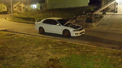

My build
Engine : 6A13 single turbo conversion
Garrette GT35R
Custom exhaust manifold
Custom intake manifold
Tial external waste gate
Aem water meth kit
Custom intercooler piping, evo 7 intercooler
3' down pipe and exhaust with HKS super dragger barrel
Forge motorsport recirculating valve
Hallman boost controler
Competition stage 3 clutch
Prothane engine mounts
Spal radiator fans 3 core radiator
Walbaro intank fuel pump
Suspension:
Buddy club coilovers
EVO 8 brembos front and back
Project MU disc pads
5zigen rims 18 × 8 1/2
Maxis tires 245 40 18
Energy suspension bushings back and front
Interior:
Rallyart seats front and back leather
EVO 6 MOMO steering wheel
Defi boost Guage
AEM wide band guage
AEM turbo timer
V@lLz V@G

Postby V@lLz V@G » July 5th, 2014, 11:18 pm
Re: Offer your VR4 project build tips here...
Postby Monk BANzai » July 6th, 2014, 1:38 am
^^ rouse....single turbo!!!!
how are the initial reactions to the conversion? lag?...
Postby Ted_v2 » July 6th, 2014, 5:33 am
Didn't see anything about injectors and fuel pump upgrade
V@lLz V@G
Posts: 18
Joined: July 22nd, 2009, 6:39 pm
Location: Vaskin VIlle
Postby V@lLz V@G » July 6th, 2014, 9:58 am
Ras d response on this is amazing ..... tort in would of been laggy but no ...... full boost 4300 rpm, pulls hard straight to the red line ..... did I great job matching the backend of the turbo with the long runner manifold.....
Have some ID 750cc injectors to install .....
