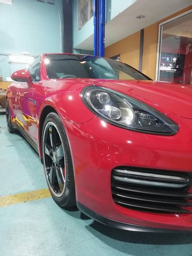

Using Jet Renu And Finish Renu products,meguiars wax though. Going to start learning CSI's brand soon. Actually thinking about getting an old bonnet to treat like sh*t so I can practice using Ceramx on it. Did this panamera last week.

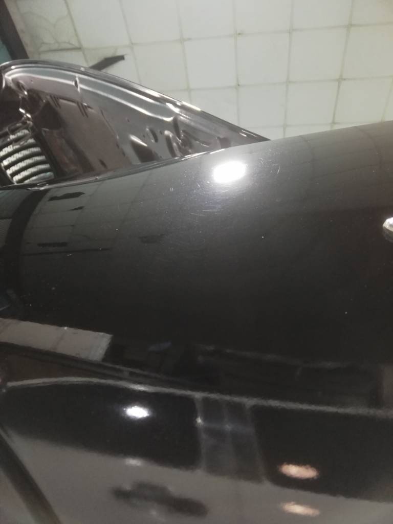

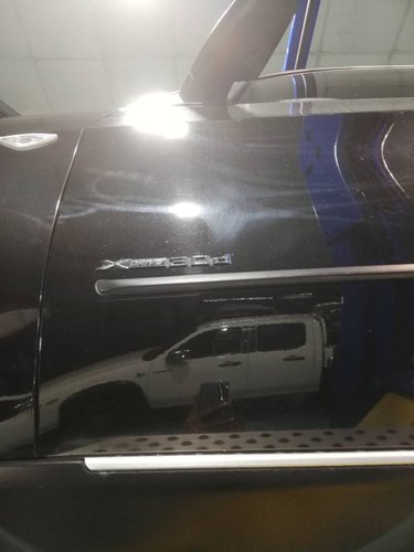

Currently working on this x5. Years of incorrect washing and nothing to protect the paint. Polished the front to test and it removed about 60% of the wash marks. I like to shoot for at least 70% - 80% removal so I'll mow it down with compound then polish it. Don't think a good soap was used either as the paint looks ( dry. ) Interior is in good shape so I did minimal cleaning and dressed it to protect leather. Charged $300.00 as I'm building clientele and my reputation. Results later today

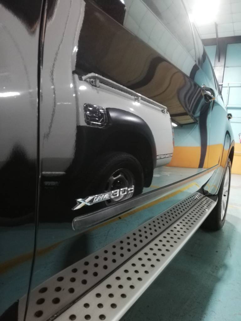

Got kept back. This is how it looks after the mowdown. Will finish in the morning

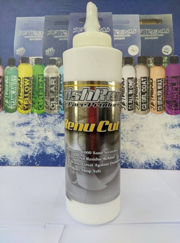

What compound you used by chance?
FineToothDetailing
Posts: 100
Joined: August 6th, 2021, 10:54 pm
Re: Ask A detailer
Postby FineToothDetailing » August 16th, 2021, 8:05 pm
Brad32 wrote:What compound you used by chance?
My dad is the authorized distributor for finish Renu and jet Renu. This removes anything that's 1000 grit and higher. It costs 180 per quart. I used a DA on the X5. But it works with rotary as well. Wipes of easy but dusts at high speed. So I wipe the wash the vehicle afterwards.

It works really well. Just have to be patient. It doesn't have fillers or anything. So ur just cutting. Takes more time on a Da. Trying to organize an old bonnet so I can practice using a rotary.

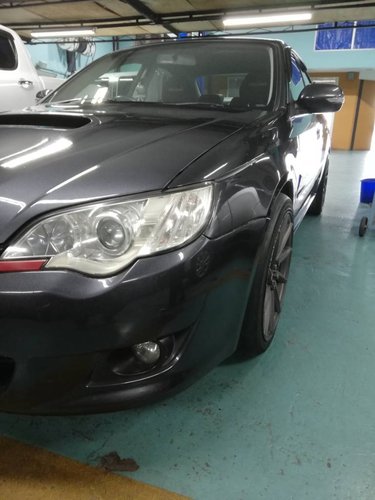

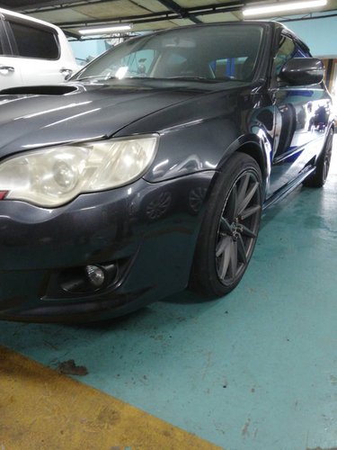

Took video but not pics. Things got hectic. Working on his other vehicle now already buffed. Ready to polish after I do the lights.

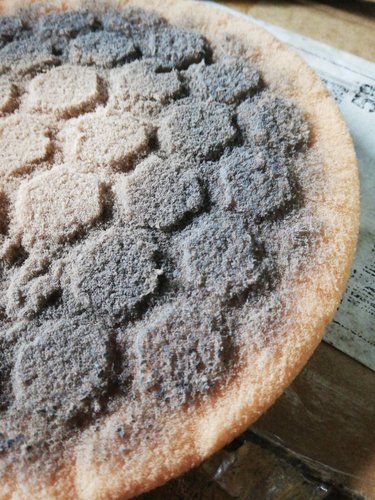

Residue from the x5

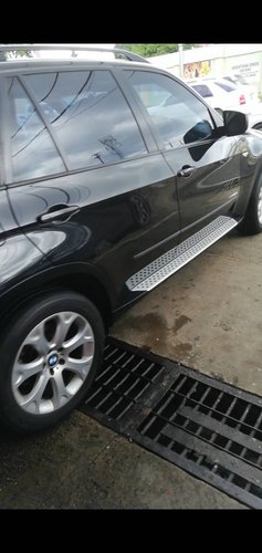

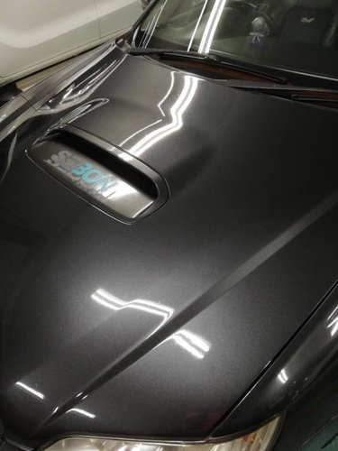

Just finished

Did u clay the X5 before?? Is it necessary if I'm doing a 2 step compound then Polish?
FineToothDetailing
Posts: 100
Re: Ask A detailer
Postby FineToothDetailing » August 17th, 2021, 5:47 pm
Clay removes the stuff bonded on top of the clear coat. Put your hand in a plastic bag and gently rub the paint. If it's feeling really rough you should clay the vehicle. What happens otherwise is you remove a little more clear coat than necessary and you clog the pad with things that can introduce scratches to the vehicle ( dried contaminants, dried compound, clear coat.) . Also when the pad gets clogged it will not cut like it should which slows you down. It Isn't needed Everytime but if the paint is rough after you wash it, claying will make life easier.
What worked for me was buffing from the good areas to the worst. Claying is great but not always needed. Unless it's high lvl work where there is no room for error.

No I didn't clay. Lol forgot to answer that part. Waiting on clay to come in from amazon.
