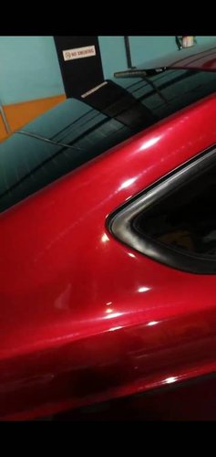

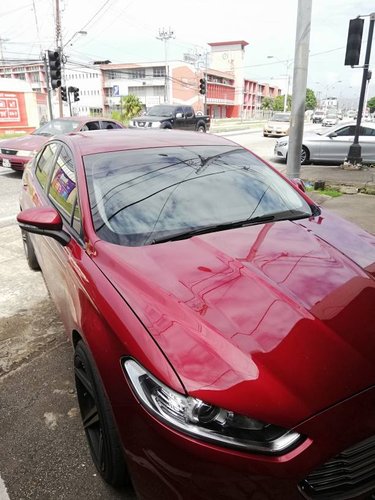

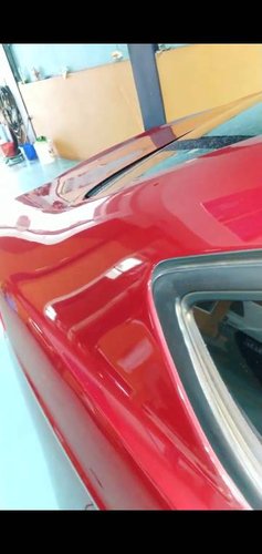

Had to buff this today. The customer drives through mud often and whoever used to wash it started in the middle of the car. The mud stuck to the mitt and scratched the entire vehicle. Even while I was buffing mud that stuck to the paint was coming onto the pad so I had to change pads to get the work done. Trying to upload a video with the scratches but it's not working.

The darker picture shows the scratches. Look at how the light is not focused and is reflecting in long lines with a scattered look.

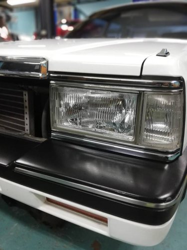

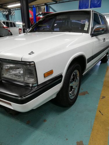

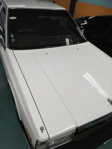

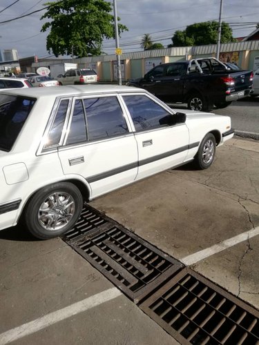

Love up this old thing today. 1985 Nissan laurel GL
Interior in good condition so just cleaned it up and dressed it to protect it from sun damage. The paint doesn't have clear coat. But it behaves like the paint they use on Vans and taxis. Polished it with a soft pad because I felt buffing raw paint would be too risky. Polished up the Chrome, cleaned up the lights. Steering wheel take too much lix so I couldn't do much, cleaning couldn't do anything. Ended up just polishing the little emblems and such.

Old school spotters stuff.
More pics?

Can do more tomorrow. What you guys wanna see?

Interior...engine...full front/back.

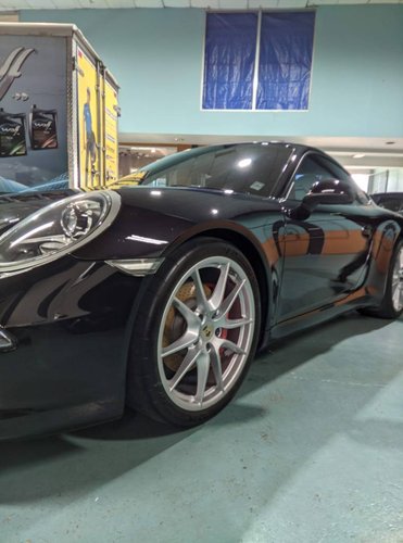

Uploading vids rn. The porshe 911 black and the white Nissan Laurel Gt.

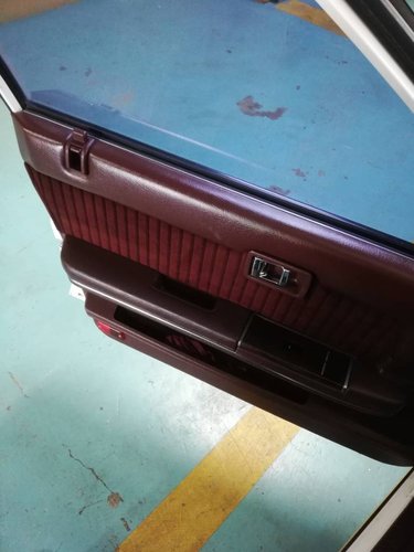

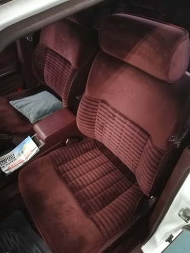

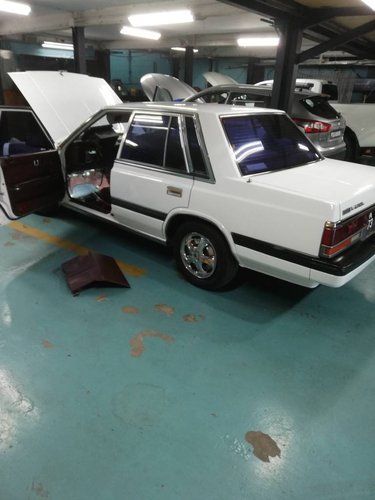

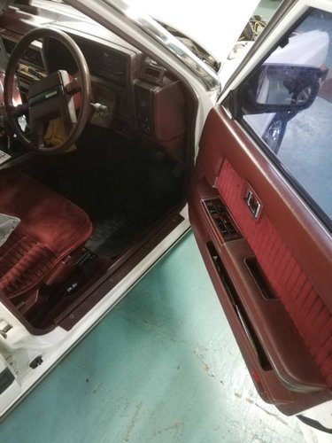

More pics of laurel.
They fixing something with the AC so can't dress the engine until they are finished. Will find out if it's for sale.
Posts: 8838
Re: Ask A detailer
Postby timelapse » August 11th, 2021, 10:29 am
Original upholstery?The owner did really good
if it is
Posts: 18414
Re: Ask A detailer
Postby Dave » August 11th, 2021, 10:37 am
Local ones came grey and the foreign ones red interior.
Either way was well preserved.
Plate is PB??????

timelapse wrote:Original upholstery?The owner did really good
if it is
Yip original.
FineToothDetailing
Posts: 100
Joined: August 6th, 2021, 10:54 pm
Re: Ask A detailer
Postby FineToothDetailing » August 11th, 2021, 2:38 pm
Dave wrote:Local ones came grey and the foreign ones red interior.
Plate is PB??????
Yip pb series. The impressive thing is I didn't have to do much cleaning on the inside.

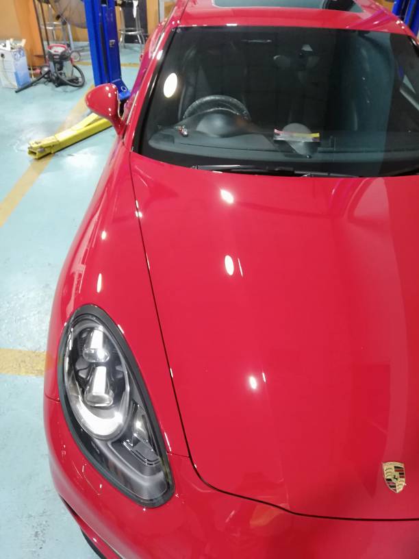

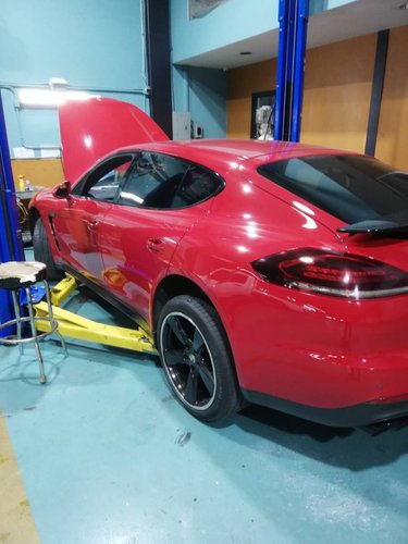

Last one. Customer just left

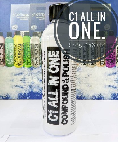

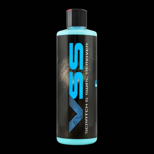

Any one step product that can do polishing and remove scratches that you recommend?
FineToothDetailing
Posts: 100
Re: Ask A detailer
Postby FineToothDetailing » August 13th, 2021, 7:55 pm
I use both of these. My Father sells the c1 compound and polish. And well chemical guys should have the VSS.
Depending on the situation one might outperform the other.
The vss is more user friendly but has fillers, meaning after a couple washes the deeper scratches will reappear. Its an apply and remove procedure.
The C1 is more what u see is what u get. A bit harder to learn when u start. But with practice it performs really well. I use it when I'm doing headlights or when Im NOT under time constraints. You use it like compound with a cutting pad then have to use a polishing pad with a lower speed
My advice would be to have a clear idea of what u wanna do.
I used the vss to polish a black vehicle then I applied wax. Because the customer didn't have time for a full paint correction. The only way the finish can be undone is if the car is washed with dish soap or intentionally removed with isopropyl alcohol. But the car look amaaaazing In the sun.
Had more time on another vehicle so I used the C1 alone. The results were great and even if it's washed with dish soap the no scratches will reappear but will look dull because the soap took shine out the paint. Posted both cars

Wow both vehicles looked amazing really top notch worked, appreciate the advice, was already looking into the VSS, so you cleared it up for me. Thanks alot for the info appreciate it alot
