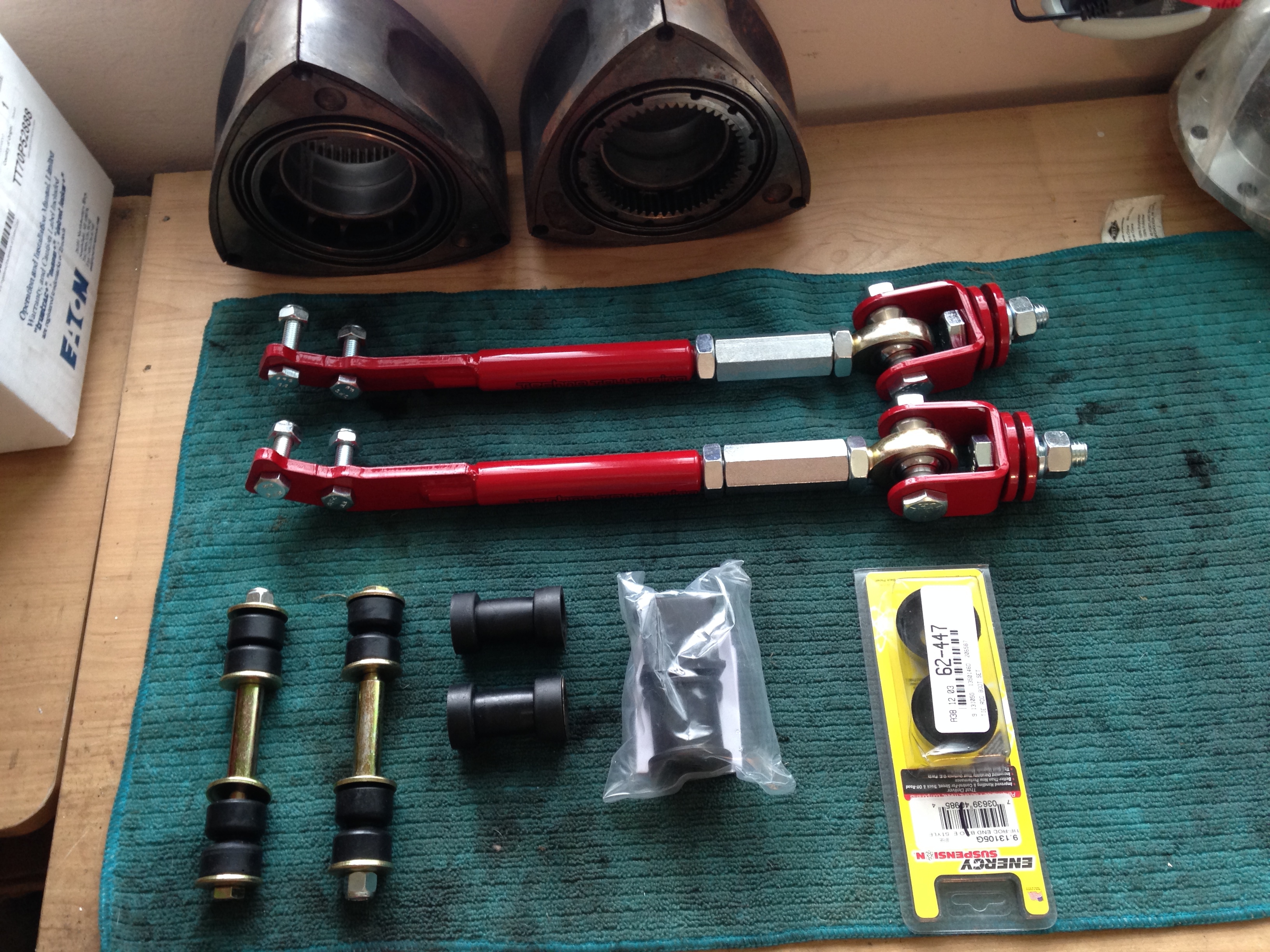

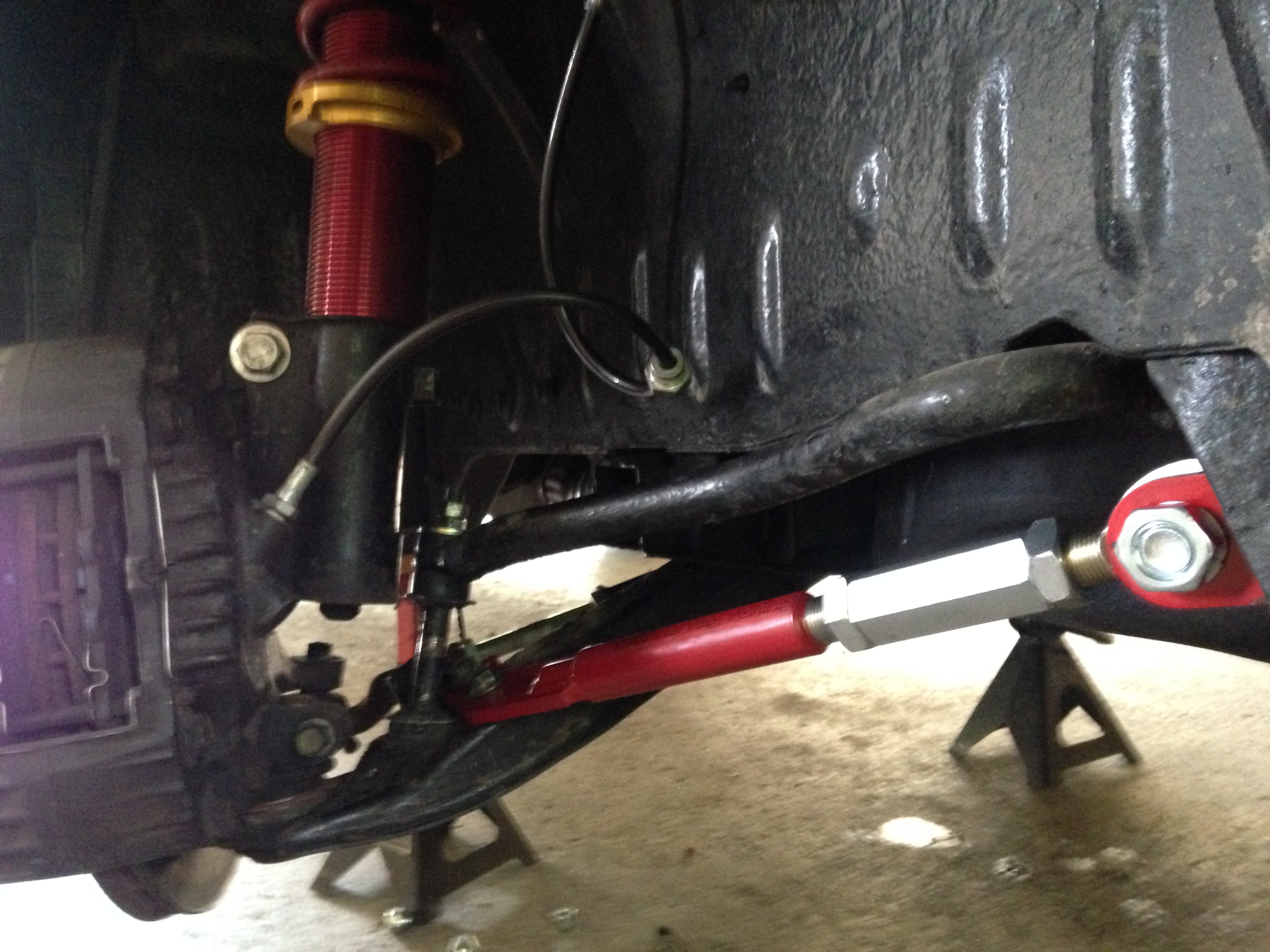

Ready for the diff swap to commence, got all the bearings, seals and gaskets to install the new LSD
Also installed the Techno Toy Tuning adjustable tension/castor rods and Energy Suspension front poly bushings

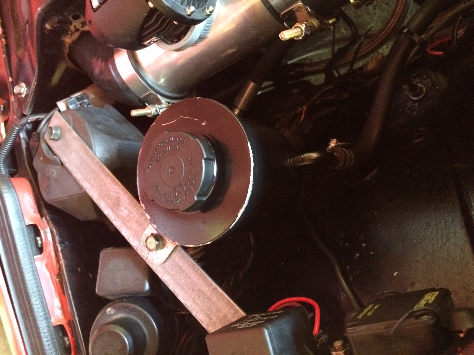

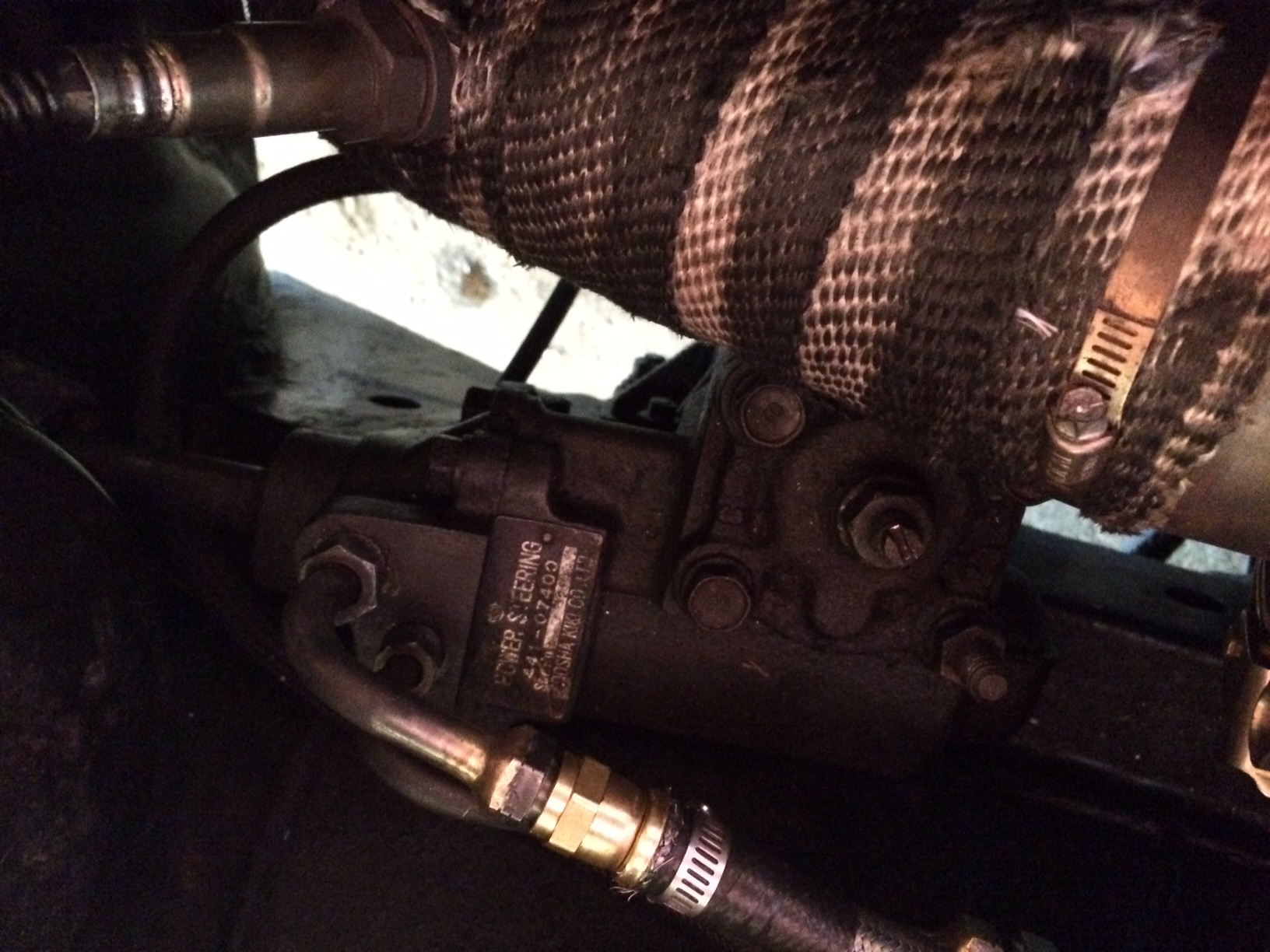

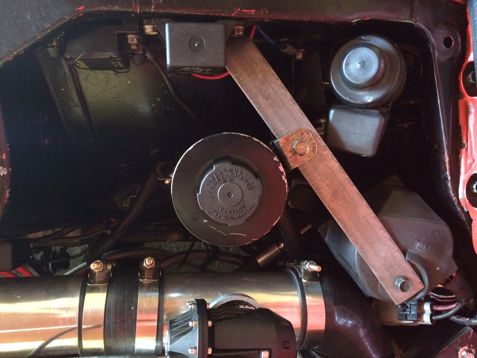

recently I installed a MR2 electric power steering pump to work with my factory installed power steering box and i think that has been the best bang for the buck modification i have done yet. one forgets how awesome power steering is and how much it improves the quality of the drive.
the pics below show the pump installed and reservoir mounted to a bracket a crudely made to stabilise the pump.. the photos are the lines to the steering box. currently it's just just wired to the ignition via a 80amp circuit breaker, need to take it to an electrician to wire up a switch so i can turn it off in traffic etc. it's loud.. very loud, but so is the car i guess..
