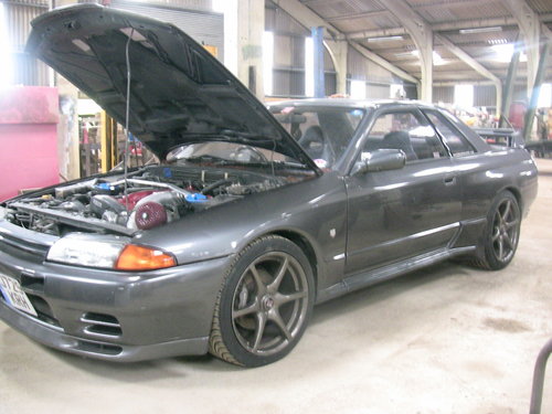

TriniGT wrote:Alright back on track, these wheels are 18X10.5 +12mm, mine currently are 18X9.5 +12mm. I will need to add a 1" spacer to make up the proper offset, will get the proper spacers with the added studs and I already have Nismo extended studs as well. I want the wheels to be fitted exactly like this. The good thing with having narrower wheels is that the inside of the wheels does not touch when on full lock.
Pretty sure you'll need half inch spacers to get that result, not 1 inch. You'll need a final measurement of 18x9.5 +0mm offset to match those 18x10.5 wheels. Worth double checking....

^he's correct. I plugged it into an offset calculator to be sure :lol:

Oh sheit you are correct, thanks man, totally was not looking at the offset and thinking the width :lol:. Then that should be an easy job.
