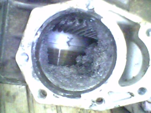

Postby xtech » November 27th, 2010, 11:53 pm
my 2WD center diff
ralliartvr47
Posts: 97
Joined: August 31st, 2009, 7:23 am
Re: Offer your VR4 project build tips here...
Postby ralliartvr47 » December 4th, 2010, 11:04 am
:shock: wth!!! torque like wow! :mrgreen:
