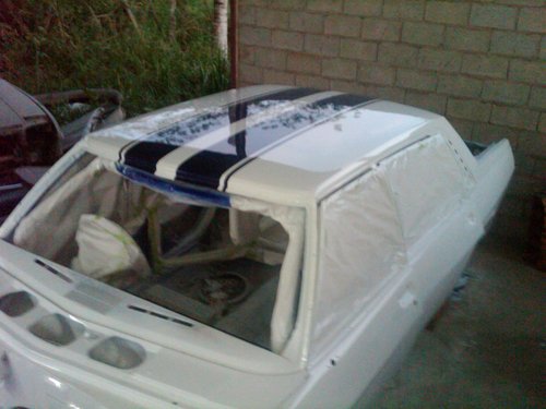

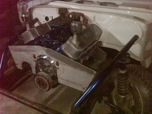

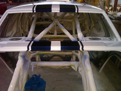

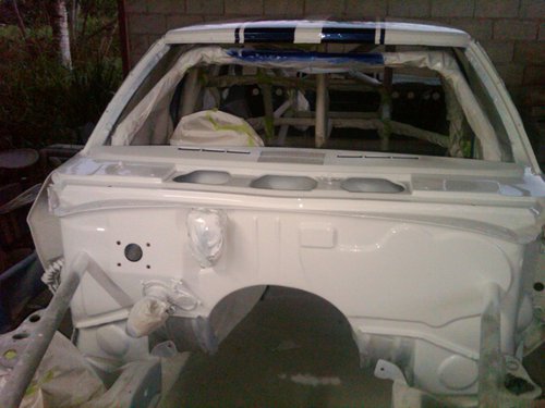

Postby rspann » January 4th, 2013, 9:14 pm
fatts wrote:spann wah goin on wit yuh car bro pics pls
All the tubs and aluminium work done,next step is fuel cell,brakes,lines, electrical,then is time to close up.The mechanic broke his foot and wasn't working for a few months so hence the delay.Don't worry,it soon be done.BTW,I bought another one to make the mould for the one piece front,so I selling it when I done use it.the body real good.

Spann, you have more photos of the cage without the paper around it? Also, who did it for you?

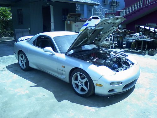

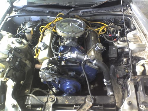

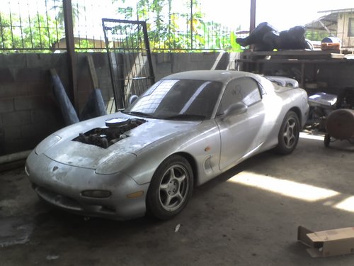

Postby GTR Fever » January 7th, 2013, 10:48 pm
been working on this since 2007..car is legally registered, fully street legal, just don't have much time to work on it as I'd like..
its a FD3S RX7 Body, 350 SBC, 4 bolt main crank, Edelbrock high rise intake manifold, OEM Chevy "fuelie" heads (ported), Holley 850cc carb (4 barrel), MSD Street fire ignition, high compression pistons, forged rods, half race cams, turbo 400 transmission rebuilt with shift kit and upgraded clutches and valve body, full exhaust (2.5" per side going to one 3.5" pipe)
Need some assistance (been contacting roadracer) with regard to installing power steering and air conditioning...will see how i can get the time..
