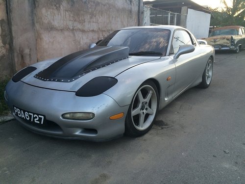

That's a "cowl induction" hood-scoop guys. Water doesn't fall in, around or near the engine. Google it in case you may have never seen one or installed one....or driven a car with one...or owned a car with one.

Postby GTR Fever » September 23rd, 2014, 10:57 am
GTR Fever
Posts: 277
Joined: August 14th, 2011, 7:42 am
Re: My FD3S drag/ street project (Chevy V8)
Postby GTR Fever » September 23rd, 2014, 10:59 am

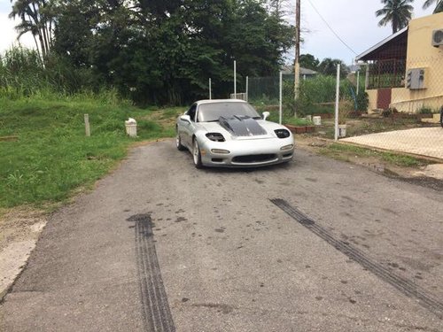

Sooooo finally an update!
Car is back in my hands with a few bugs to sort out...but I was finally able to drive it!!
Coilovers feel really nice on the road, feels well planted
LOVE the shifter..makes it feel like a race car
Hood scoop allows good visability
Exhaust is super duper loud but sounds like it should
Exhaust (resonator part) is way too low and drags everywhere, will need to fix ASAP
One of the Flex-a-lite fans has a short somewhere so it cuts off, causing the temp gauge to climb
Carb needs alot of fine tuning, definitely biggest issue so far
Kickdown cable was not hooked up (did not think about it really) so that made the drive a little boring
Alternator is iffy to say the least...volt gauge keeps fluctuating (could be the belt)
Power steering works but belt needs a tensioner to keep the pump working
Power steering hoses needs to be altered for my preference
-Pressure hose touches the radiator top hose
-Return hose is a very random looking blue hose that it super soft
But hey, she drives!! was driving through traffic on the main road as normal with everyone looking to see what was causing the noise lol

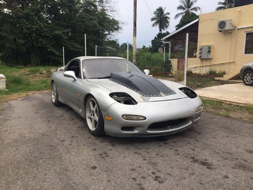

just an updated pic..
