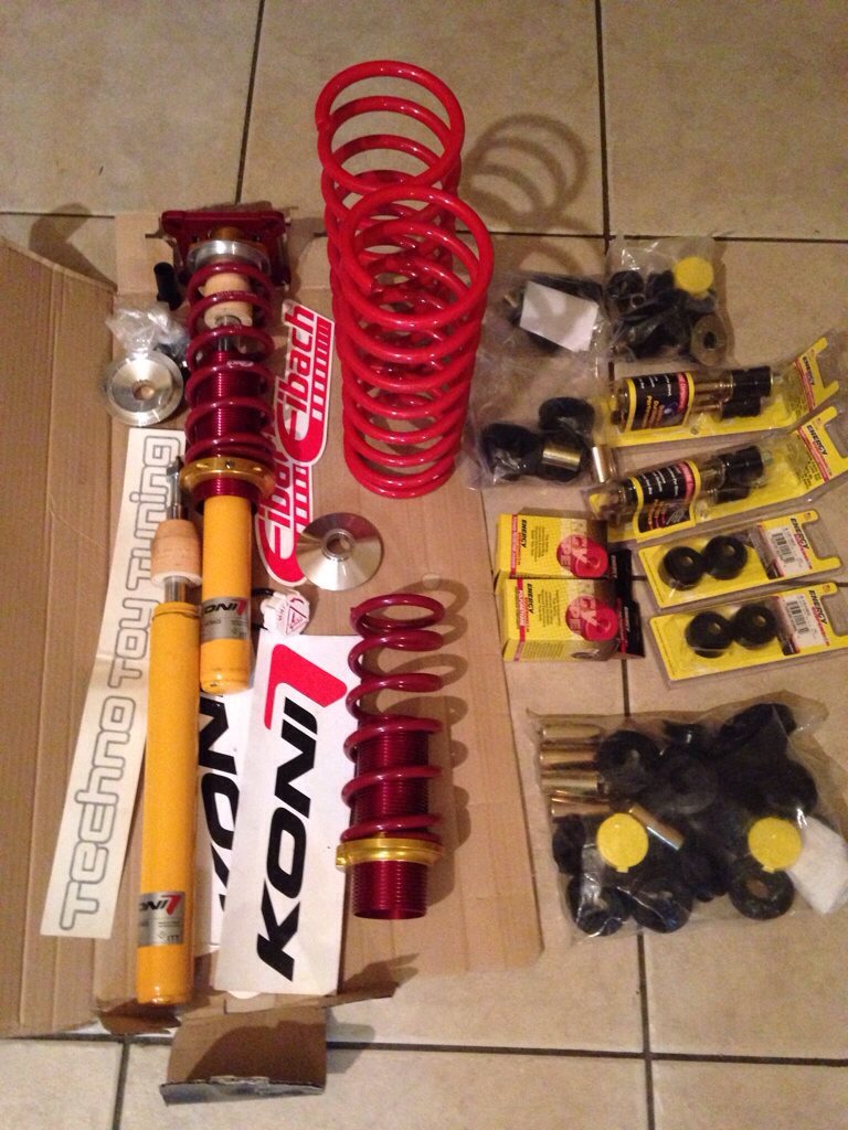

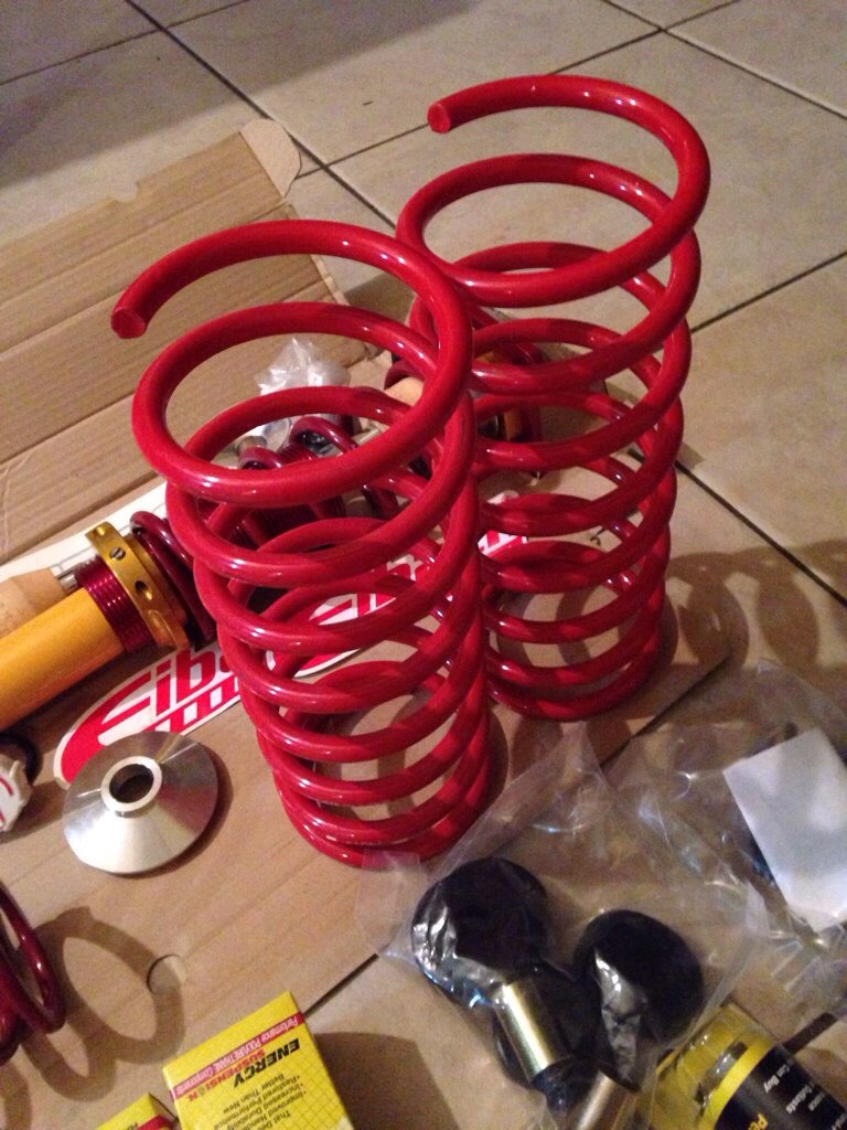

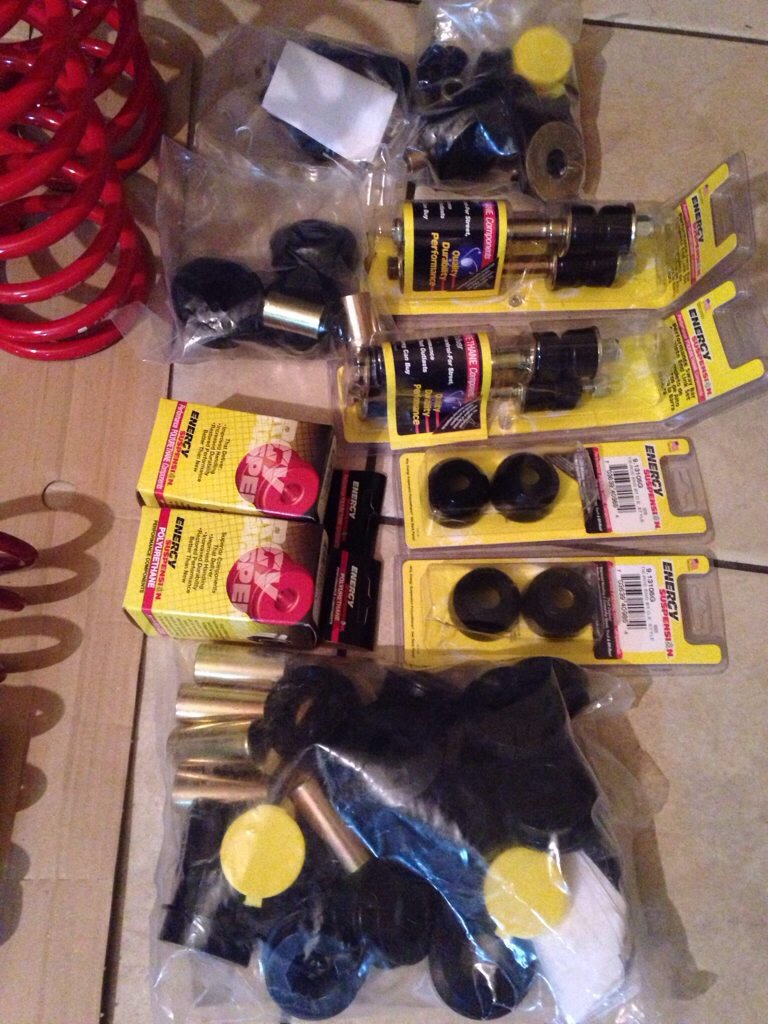

Koni Adjustable Race Struts
Energy suspension full polyurethane kit
Racing beat rear springs (-1")

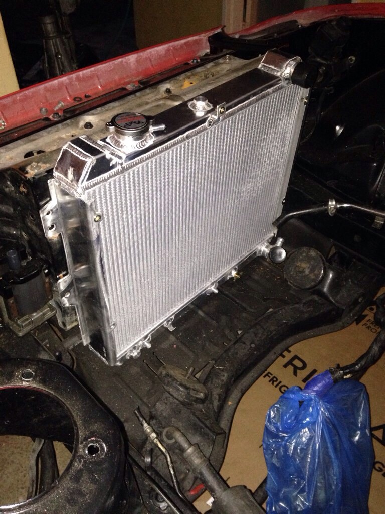

Solid corner seals, springs, side seals & springs, Rotary Aviation Super Seals and mazda springs. Oil control ring springs etc
New aluminum 3 core first gen racing radiator

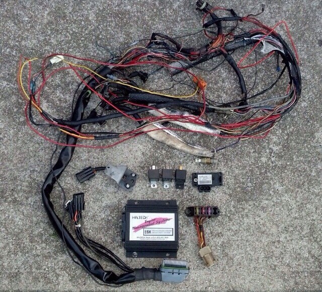

Haltech wired and tuned for pretty much my exact setup..
And lots done to the interior too.
Pretty much have piles of parts and no time. Looking to drop the car off to paint and then by a rotary mechanic to finish off. Wanna drive this before the year end.

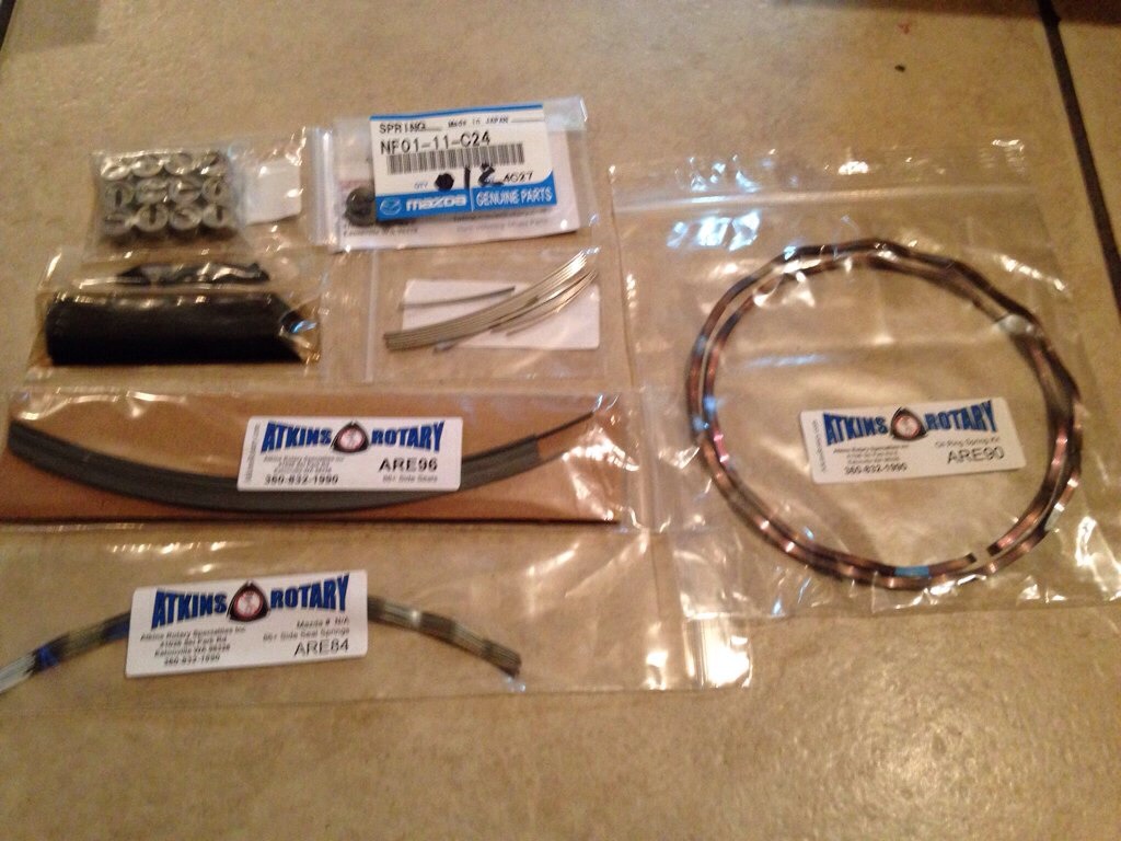

Short block/Engine assembled.
13b series 5 turbo II
Street ported & match ported intake/exhaust
OJ performance 2mm RA Super Seals
Mazda apex springs
Atkins solid corner seals
Mazda corner springs
Mazda side seals and springs
Atkins water seals
Viton oil control rings
New Mazda oil rings
Series 8 stationary gears and bearings
Modified oil system (90 psi)
New Mazda seals and gasket kit
New Atkins water pump
Engine prep, porting, cleaning and assembly by Stephens Rotary Garage.

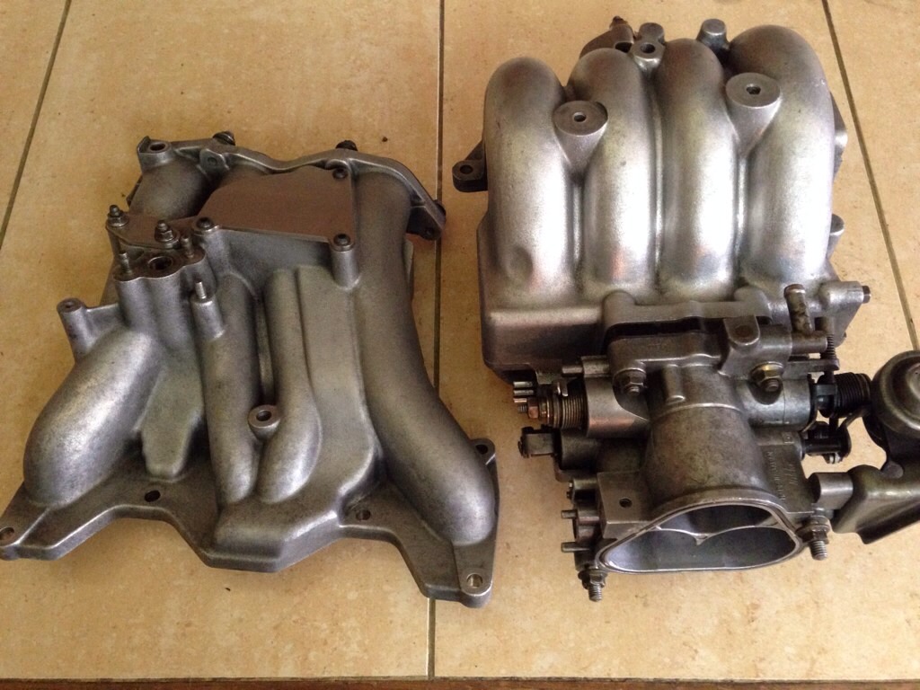

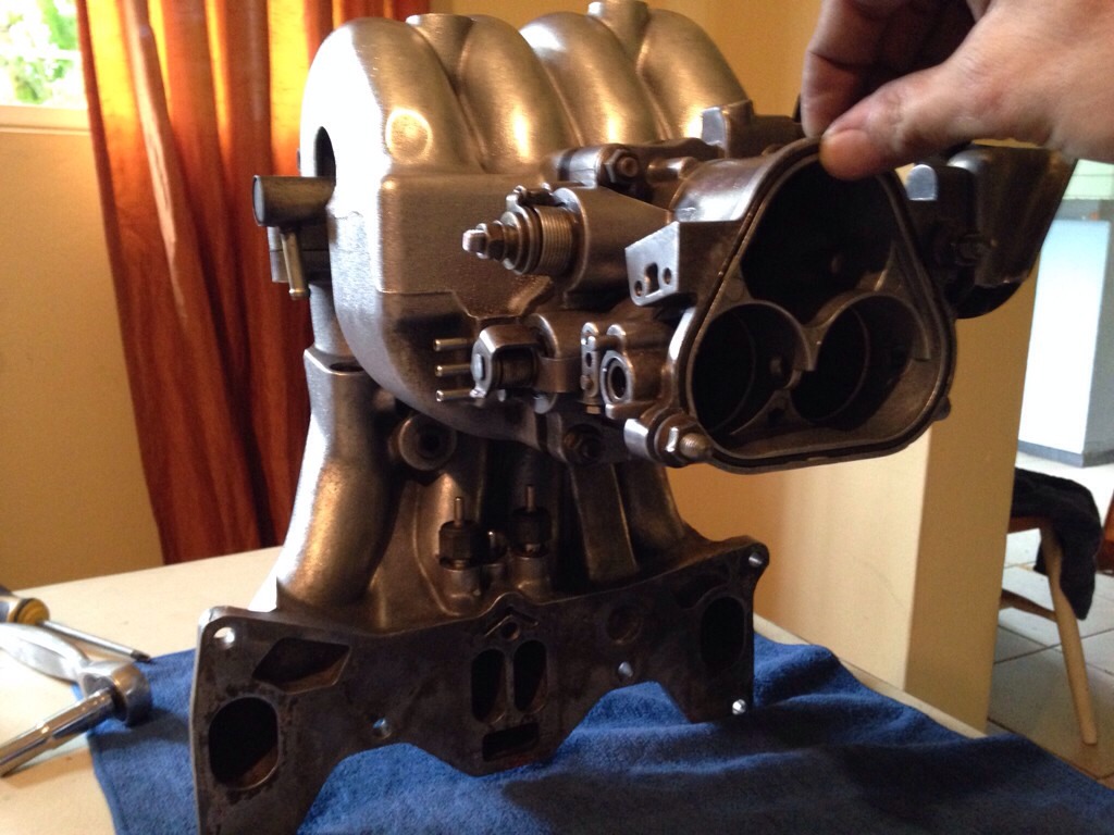

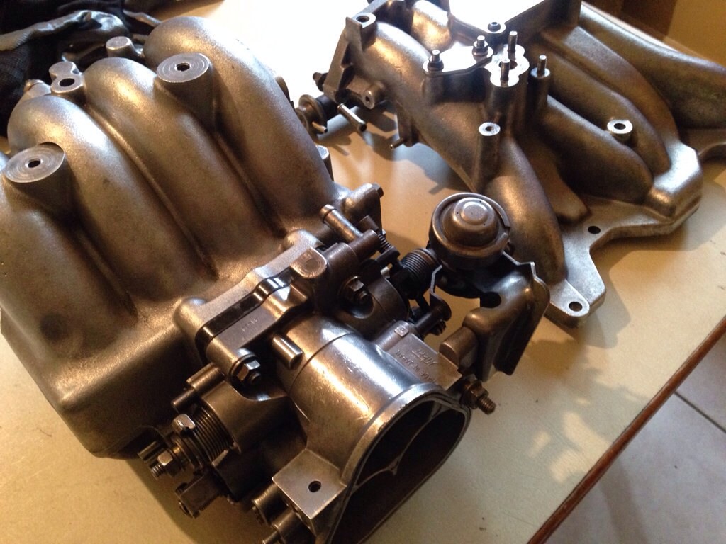

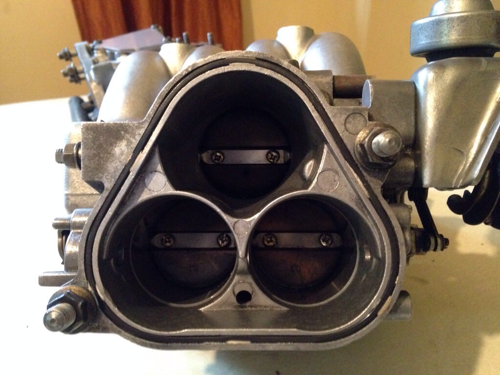

Cleaned up the intake mani and removed all the emissions and water cooler etc. Removed the secondary butterflies from the throttle body and getting everything ready for the install.
Still have to get my fuel rails and regulator and I should be all good with the intake and fuel systems.

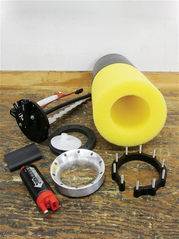

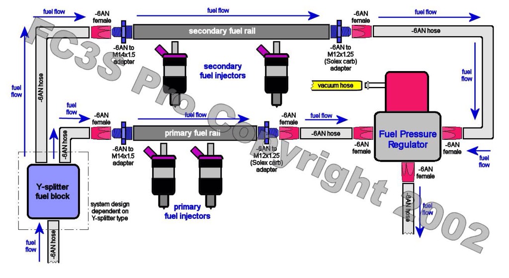

More on the fuel system. I'm going to be running an Aeromotive Phantom 340lph Intank pump with sump/baffle
Very impressive piece if kit. Check out some youtube cubs of it if you have time.
Above is how I'll be running my fuel system with the new rails and regulator. Slowly but surely coming to come.

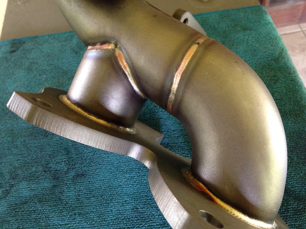

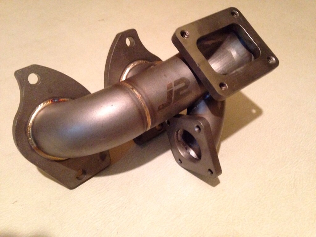

Postby Bezman » September 13th, 2014, 12:40 pm

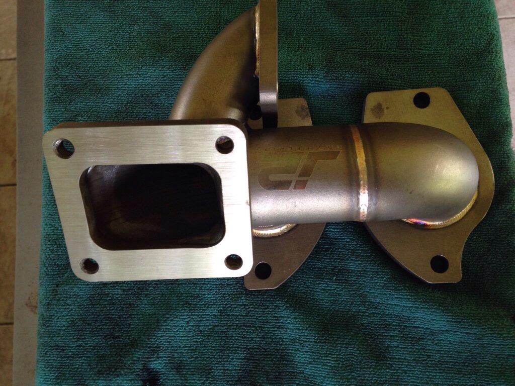

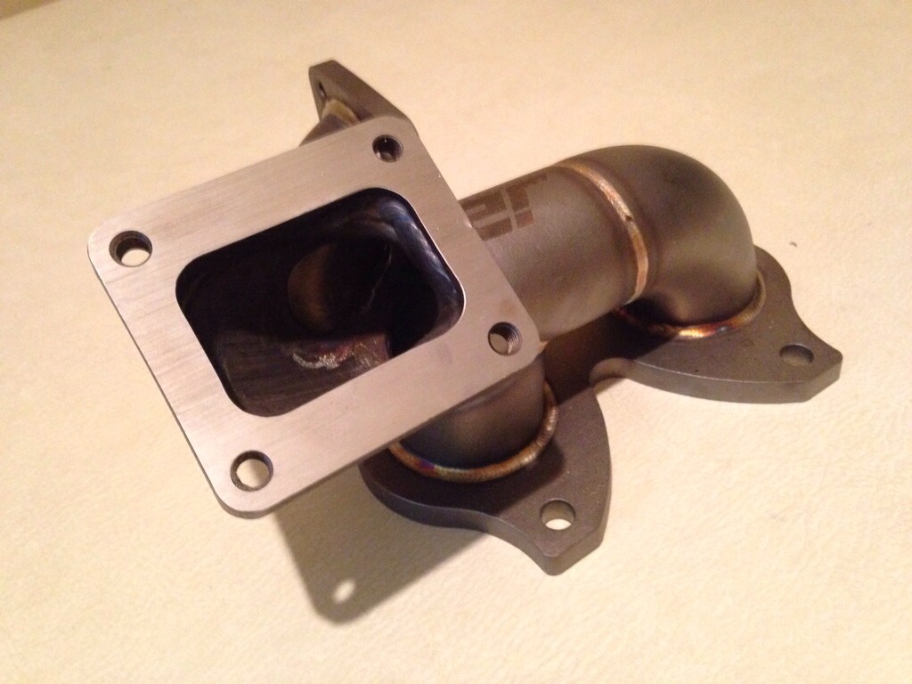

Turbo porn!! J2 13b manifold. Amazing build quality!!
paparazzi
Posts: 1109
Re: My First Generation RX7 Project
Postby paparazzi » September 13th, 2014, 1:03 pm
Bezman wrote:I think I'm leaning towards something more like this as far as paint is concerned.
Lol you mean Reece ent want you paint it blue just like his? Lol
paparazzi
Posts: 1109
Now that's what I call proper welding
