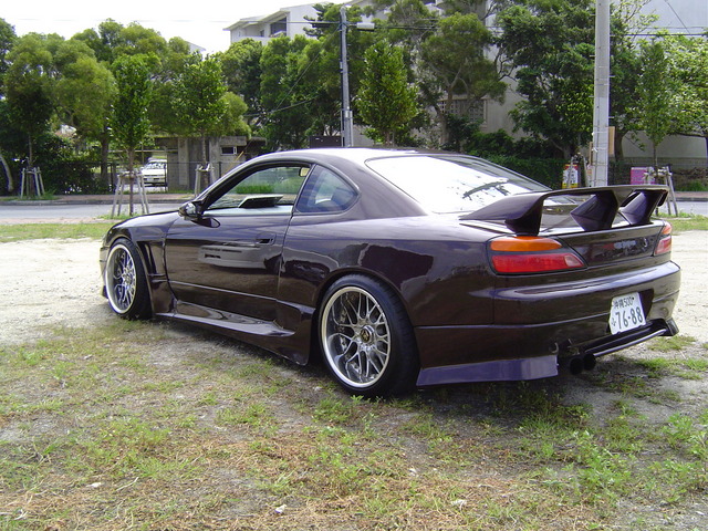

Conrad
Posts: 4126
Location: 3NE2NR
Postby Conrad » April 21st, 2009, 10:52 am
Graphicless, wingless, with some seriously dished rear, 10" should suffice:
Dark Purple
Carbon grey???
Pearl white with strategically placed, "discreet" driftworks graphic (probably rear windscreen).
If it were mine and I had the muula, Bayside blue with gold TE37s

robbieg
Posts: 120
Joined: February 12th, 2007, 1:21 pm
Postby robbieg » April 21st, 2009, 11:13 am
Midnight Purple is the sheeit
TriniGT
Posts: 4293
Location: Home Playing DIYer
Postby TriniGT » April 21st, 2009, 12:09 pm
Hmmm ..........
Blue.....

Postby TriniGT » April 27th, 2009, 8:13 am
Well Friday I got a slip in work from TTPost to pickup up a package, item description was Auto Parts. My Driftworks suspension parts arrived. What I did not realize is that they didn't invoice my stuff properly and I had to pay the full brunt. I went there and the officer was very uncooperative and I left the place with no items and the price charged was almost the value of the items. I decided to try again when the shift changed and was able to renegotiate and in the end on Saturday morning came out with my two packages in hand and some money still in my pocket. Items are exactly what I paid for and I am more than happy with my purchase. Got my camera somewhat working so I will take some picks of my parts thus far.
The colour code has been narrowed down to three colours, pearl white (WK0 or QX1), Midnight Purple as seen on the R33 (LP2 Midnight Purple (no Chromalusion, has 2 pearl tinters Violet & Red) or R34 GTR (LV4 Midnight Purple II (Chromalusion Tinter KK760 Absolute Purplene & Vilot Pearl) or LXO Midnight Purple III (Chromalusion Tinter KK700 True Blazberry Prizm & 2 pearls red & Violet) and lastly Graphite (KH2 or KN6 or Dark Gunmetal Grey from the R35 GTR # KAD), not sure on the code as the WV2 S15 gunmetal is a little to light, I think the blue is a little too played out and every subaru I see is sporting it with gold wheels.

paint it pearl white. you really think all that tubing and stuff necessary?? why? with the right offset and coilovers/track arms/steering knuckles etc you should be able to slam it and keep excellent geometry etc.
