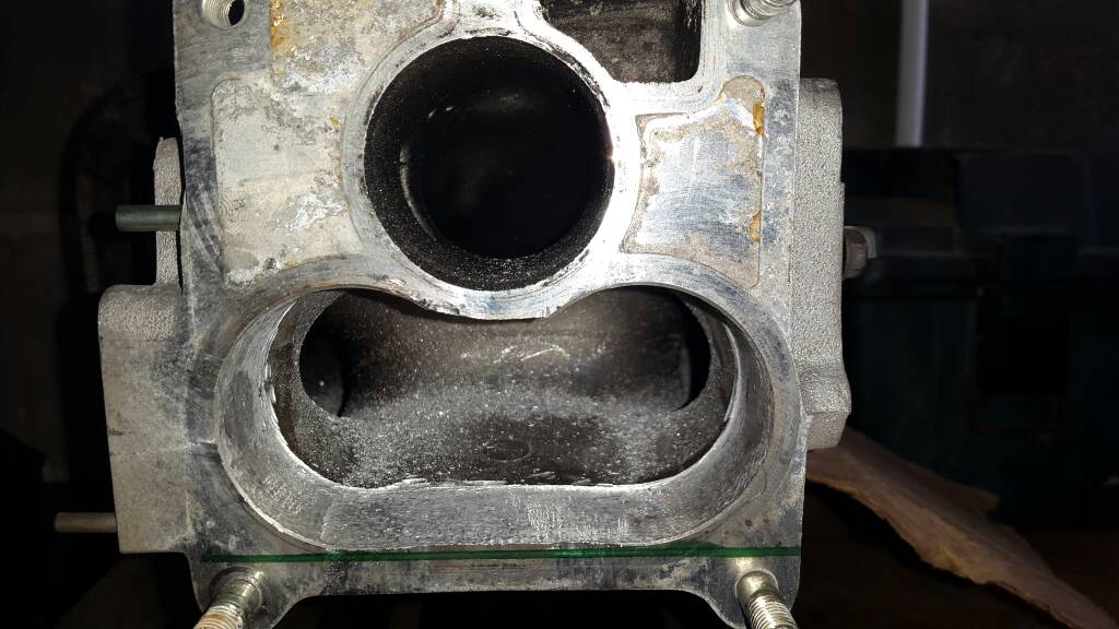

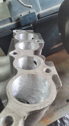

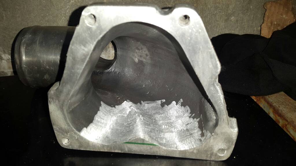

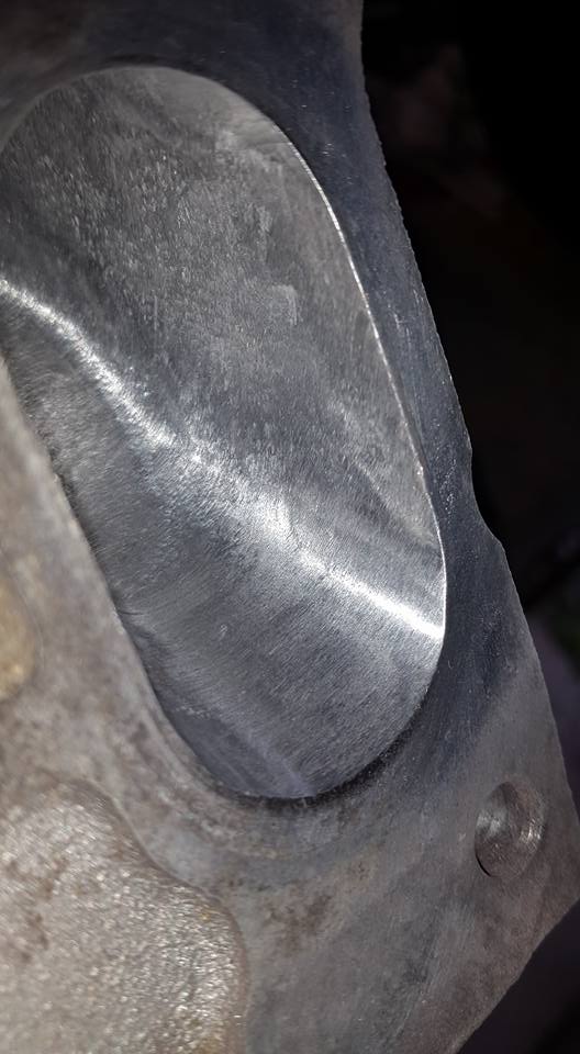

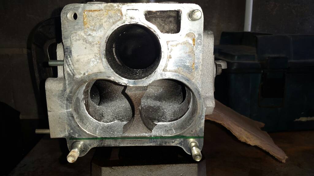

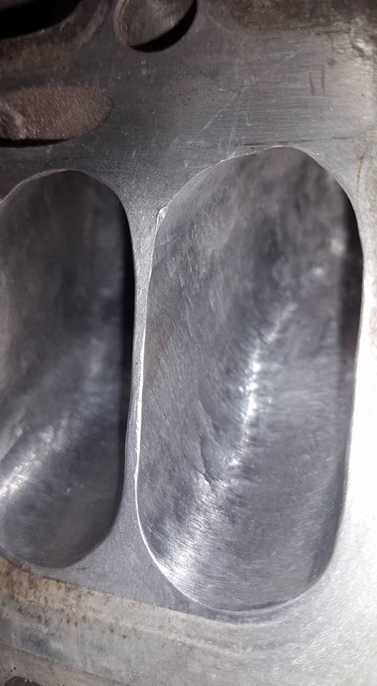

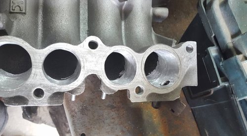

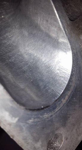

So back @it again did some port an polish on the intake manifold ImageImageImageImage

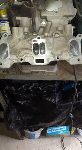

did some more porting to day

polishing up not finished more to come

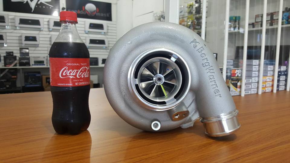

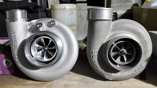

Postby jason-x » August 5th, 2017, 7:53 pm

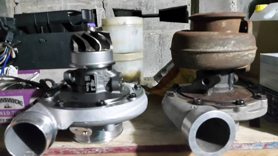

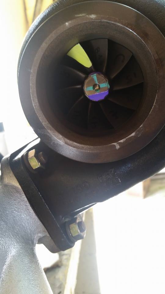

look what come to day :D :D :D :D :D :D :D :D

Postby MrSennin » August 5th, 2017, 8:33 pm
Big boost, big boost, big boost

Postby matthew2730mvp » August 8th, 2017, 8:54 am
finally......

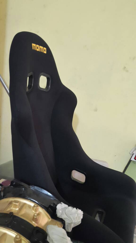

Postby jason-x » August 12th, 2017, 6:39 pm
Needs to be comfortable toImageImageImageImage

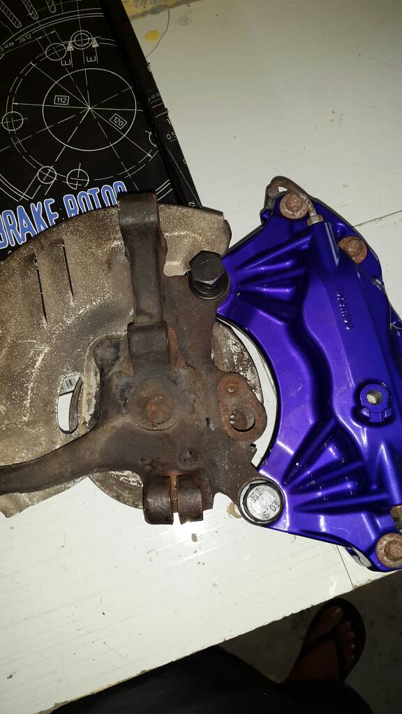

Working on the brakes ImageImageImage

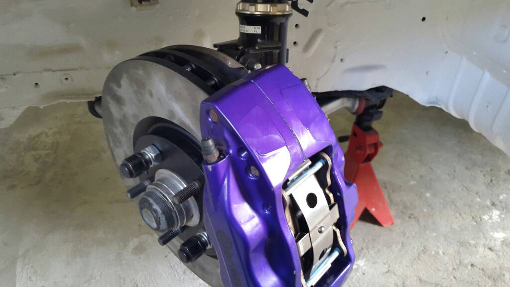

Now finished the back brakes how it looking ImageImageImage

Looking nice and clean could clean and paint the knuckles and control arm

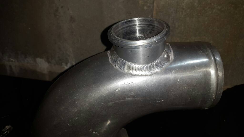

At it again organizing to paint soon cut the back bumper install hood pins an air vent for the turbo ImageImageImage

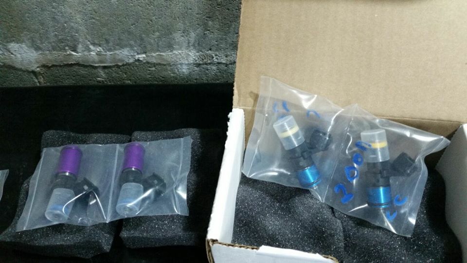

Postby jason-x » October 27th, 2017, 10:55 pm

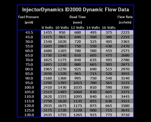

finally parts reach............ injector dynamics 850cc & 2000cc
The ID2000 has set the standard for linearity and control in a large injector. Flowing in excess of 2000cc/min at 3 bar, the ID2000 will also provide a smooth stoichiometric idle on E85, and it will do all this while maintaining strict linearity up to 95% duty cycle at 9000rpm. With a pressure capability of 9 bar this injector can flow as much as 3700cc/min with excellent low pulsewidth linearity, and has the broadest operating range of any injector on the market.

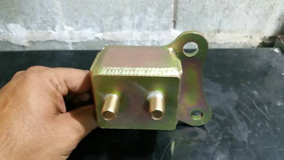

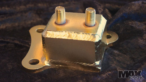

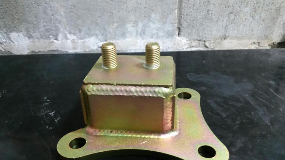

all fc3s rx7 aka 2ng gen have a problem with it,s stock diff mounts so found a good upgrade mount :D

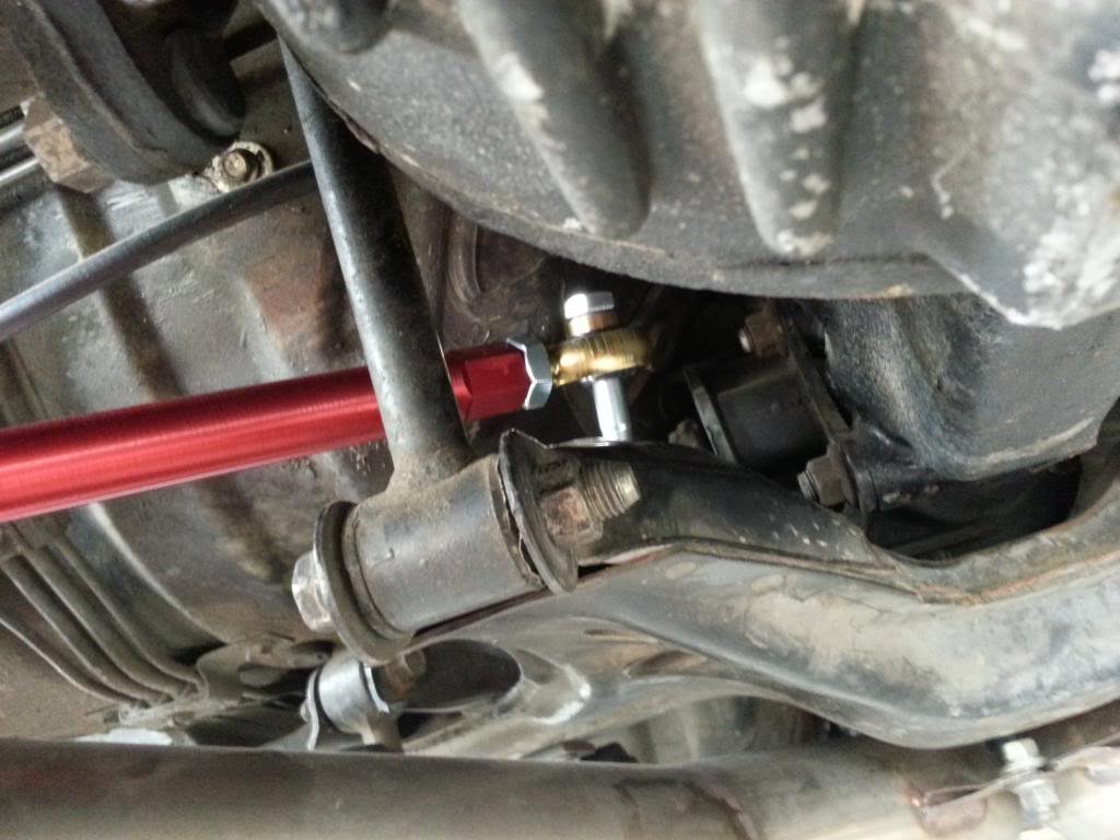

Postby jason-x » October 27th, 2017, 11:36 pm

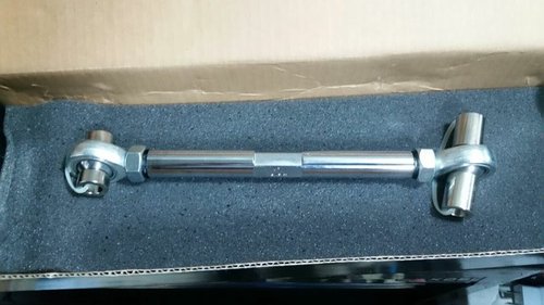

rear camber good or bad ? changing out the stock one with an aftermarket one
By pulling up or pushing down on the rear subframe where the original equipment vertical link is located, negative camber can be reduced or increased. This method changes both wheels an equal amount. The rear camber arm allows adjustment without having to remove the link by incorporating heim joints, left and right-hand threads, with jam nuts.

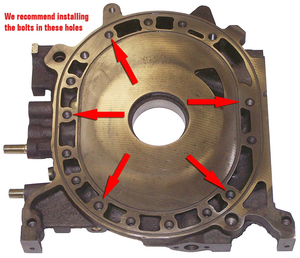

Postby jason-x » October 27th, 2017, 11:43 pm

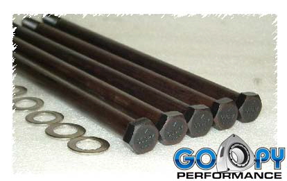

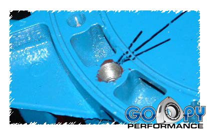

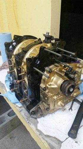

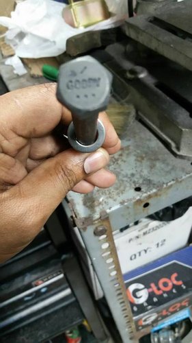

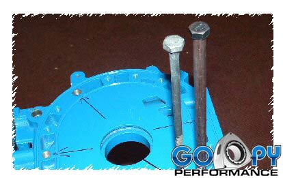

And now time to build the engine with goopy by my side
Goopy Performance’s Oversized Main Engine Bolts provide a better alternative to the usual dowel pinning method of strengthening the engine.
These have been extensively tested on race engines producing in excess of 900 Horse Power, and are completely reusable.

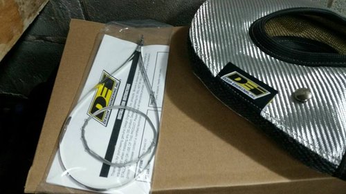

need to keep the engine cool an my foot so what better than DEI turbo blanket
Made from pulverized volcanic rock then strained into a fiber material, Titanium Turbo Shields can withstand direct heat up to 1800 F and 2500 F radiant heat. This means retaining more heat in the turbine and less damaging underhood heat. The result is a cooler air intake temperature and a boost in horsepower!

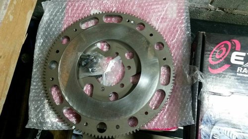

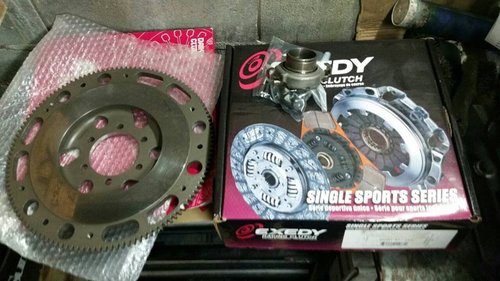

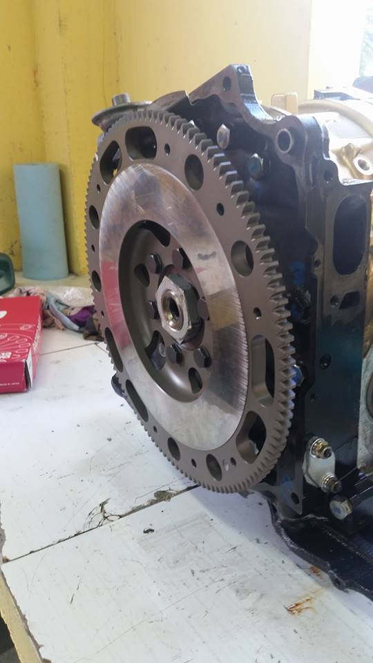

then we need something light like an exedy super lite flywheel on a super single clutch setup
EXEDY cerametallic clutches are designed to handle the abuse of high power modified engines. Our cerametallic friction material can handle much more abuse than stock type disc assemblies without slipping and fading.
All EXEDY Stage 2 cerametallic clutch discs have sprung center dampers to reduce the impact and shock loads transmitted through the drivetrain. We offer two types of cerametallic discs, “thick” and “thin” along with a cushion button disc.
jason-x
Posts: 230
Joined: February 20th, 2011, 6:59 am
Re: My 2nd gen Rx7 race car build post updated 10/11/2017
Postby jason-x » October 28th, 2017, 12:03 am
EXEDY Lightweight Flywheels combine low weight, low inertia and high thermal capacity. They are designed for light to moderately tuned racing cars for drag racing, autocross and rally events, as well as street usage. They are made from solid one-piece billet chromoly steel or chromoly steel forgings. They are specifically designed to reduce weight and inertia for better engine response. Most incorporate special design features to enhance the airflow which improves the cooling of the clutch.
The ring gear teeth are integrated onto the flywheel unlike an aluminum flywheel where the ring gear is pressed onto the flywheel and has the possibility of separating from the flywheel due to the different expansion coefficients of aluminum and steel. Newly available are lightweight, solid replacements for vehicles fitted with OE dual mass flywheels. EXEDY lightweight flywheels have passed engineering tests to 15,000-18,000 RPM. They are guaranteed not to fail to the said RPM, and are all SFI approved.

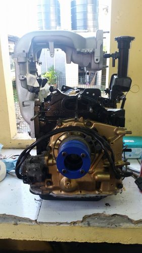

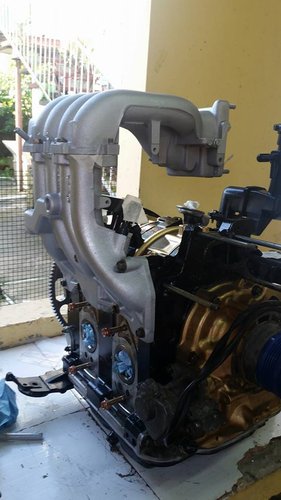

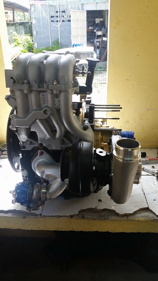

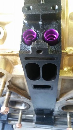

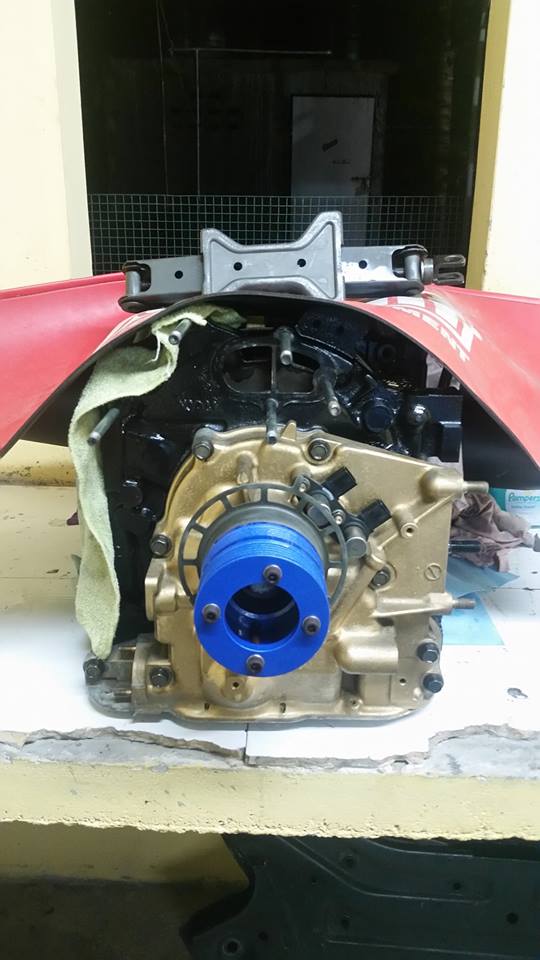

Engine finished full bridge port :D

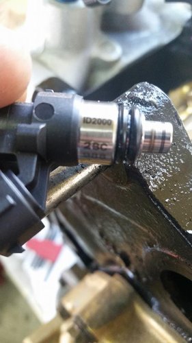

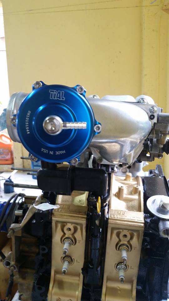

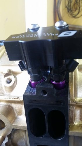

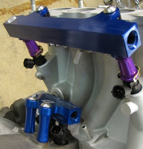

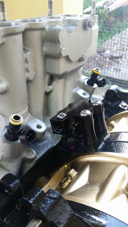

installing injectors an fuel rail :lol:

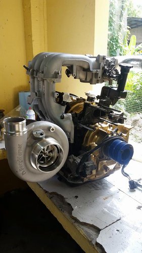

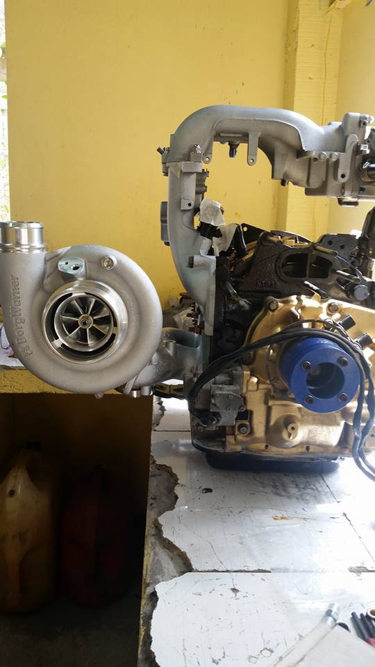

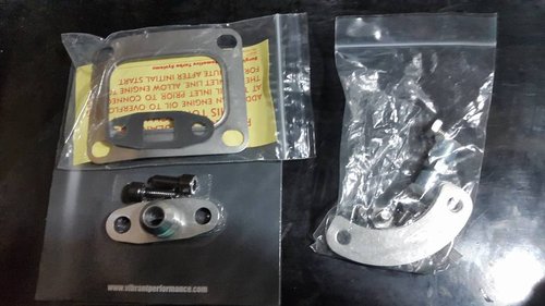

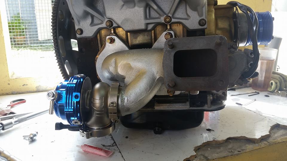

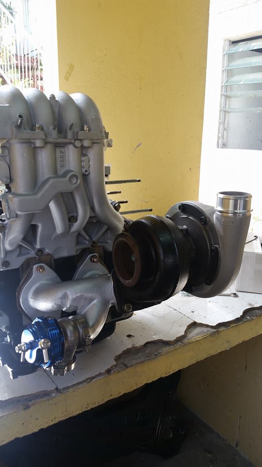

finish bolting the engine to the turbo lolllllllllll who's ready for some big conch & roti :D
