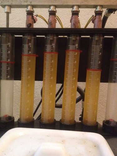

Aaron 2NR wrote:well I'm a victim of it...the IAM was on 16
Aaron's motor blew (shitty but it happens). He believes the cause to be bad gas and aggressive tune (reasonable claim but based on what he says doesn't make sense)
BANzai Rastafarai wrote:Wouldn't running Meth nullify any problems with octane? Regardless of tune?
Banzai Questions claim of bad gas being culprit. This makes sense because not only is he running water/meth injection which effectively raises the octane and cools the mixture but since Aaron said the ignition advance multiplier was 16 it proves the failure was not due to knock. Since octane is a measure of knock resistance it can be established that in whatever capacity the meth was operating irrespective of the quality of the gasoline - it was sufficient for the tune. IE it doesn't matter what the trigger point was...it had nothing to do with the engine failure.
16 cycles wrote:^ depends on your trigger for the meth to start spraying...
At this point you say that meth and therefore the octane could be a culprit depending on the trigger.

As I stated numerous times on this forum and others, I don't know everything about tuning, auto mechanics etc but I learn as I go along.
This was the conclusion based on the events of the day, maybe we are wrong but I will post pics when the engine is scrapped.
After my tuner pulled a live view I filled gas later that night and parked the car up until Sunday. Again in a gas station I never filled at before.
My mech said based on his tests the car began to detonate and the main variable in this is fuel, since injector duty cycle etc remained the same from what they saw....
Maybe we are wrong but the explaining made sense to me but I'm not a mechanic or a tuner...

Aaron 2NR wrote:My mech said based on his tests the car began to detonate and the main variable in this is fuel
Did he say what tests he performed in order to determine this?

What was the outcome of the tear down?
Aaron 2NR
Posts: 6476
Re: The Truth Behind The Subaru EJ-Series Engines -
Postby Aaron 2NR » October 4th, 2015, 9:12 pm
Injectors leaned engine and melt a piston, cracked another
