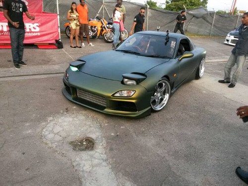

Posts: 33212
Re: Need help understanding the
Postby shake d livin wake d dead » April 13th, 2015, 7:47 pm
this was pretty impressive

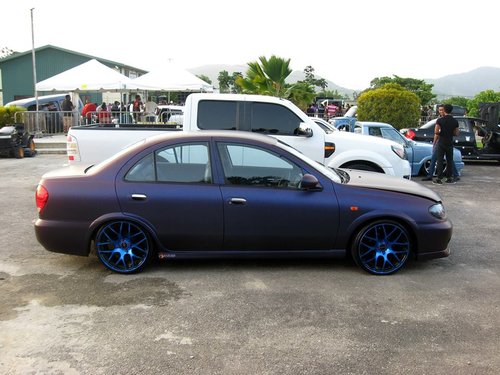

Posts: 33212
Postby shake d livin wake d dead » September 14th, 2015, 6:35 am
V2NR 3.0 wrote:So any references on who does these matte jobs ?
almera posted above was done by Chop Shop Customizing
rx7 was done by Street Vision Customizing
