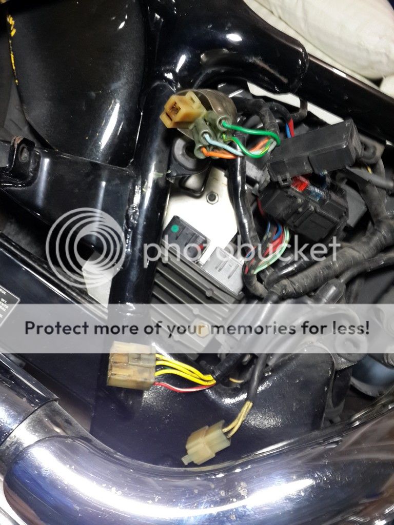

3stagevtec wrote:From my research, the stock regulators on the older VT Hondas are not mosfets.. i'll get the part number to verify when I get home
Progress?
3stagevtec
Posts: 9622
Re: Motorcycle Riders
Postby 3stagevtec » November 30th, 2014, 2:27 pm
The regulator that came with the bike was a SH633-12 which as far as I can find, is not a mosfet type.
http://www.hondashadow.net/forum/72-technical-discussion/107378-charging-system-upgrade.html
Then, I read about so many members having to install a new stator as theirs had gone bad, and was also going to install an after market, higher output stator to keep my battery charged with more power. Mine charging system was only sending 12.5 or so volts to the battery at idle and even less when reved up, so I thought the stator was bad...WRONG. My stator tested just fine.
It's also suggested on some sites to replace the voltage regulator when replacing the stator, so I figured my regulator was the problem and I was right. The stock regulators are not very good regulators and don't work very well. They get way too hot and don't send enough power to the battery, and not only that, they make the stator run hot, eventually burning the wires on them, taking them out.
So I did some research and found the answer to our charging problems. It seems it's not the stator not putting out enough power, it's the voltage regulator not sending enough power to the battery, running too hot by it's very design and from the stock wiring harness using too thin gauge wires between the regulator and the battery.
I found the Mosfet type regulator to be alot better regulator. It runs cooler and sends alot more power to the battery. It's found on the Yamaha R1 sport bikes, as well as some Roadliners, ATVs and snowmobiles. The part number is FH012aa, which shows it's a Mosfet style regulator. Our stock regulators are SH models and send the extra power to ground, which is why they run very hot and don't work very well to keep the battery fully charged. That's is probably why they eventually take out the stator from over heating too.
Now, the FH012aa is a mosfet shunt design, which is not a very efficient design.
There is a Shindengen SH775, which is a mosfet series design, which is far gentler on the stator..
http://www.triumphrat.net/speed-triple-forum/104504-charging-system-diagnostics-rectifier-regulator-upgrade-2.html#post3056170
Here is the SIGNIFICANT difference - this new R/R is SERIES - not SHUNT!!
Why is that of benefit?
The difference between Series & Shunt is that:
Shunt - the Stator always has to apply maximum generated current - when the R/R is in regulation it shorts across the winding to 'shunt' current away from the load directly back to the stator. In an SCR (OEM) Shunt Regulator the SCRs get extremely hot and they ultimately burn out if that heat is not adequately cooled - that is why OEM needs to up front directly in the cooling path.
Because of the way it operates, if you reduce the system load (e.g. turn off the lights) the R/R will actually have to shunt MORE current and will run hotter - but the stator load is the same regardless of whether the current is going to the load, or back through the SCR's.
Series - this is fundamentally different in that in a Series design, instead of diverting (shunting) excess current back to the stator to control the output voltage, the regulation works by interrupting the current path to the load. This means that the Regulator ONLY supplies current demanded by the load itself, and no excess current parallel path through a shunt. So the net result is that this type of Regulator is MUCH kinder on the stator because the stator is always supplying much less current! So the stator does not get so hot and its reliability increases significantly.
The fact that it has SCR's is not quite so problematic as in the Shunt application, because they are flowing less current and for a shorter duration. So they will not get as hot as when used in shunt mode.
This particular unit is a Shindengen SH775 regulator and is used on Polaris models.
It is VERY inexpensive - brand new -
e.g. $73 shipped!!!! ($60 & change plus shipping)
http://polarisparts123.com/partnumber-search/ (enter 4012941)
Polaris REGULATOR-3PH,35A,SERIES,105C for 2011 Polaris R11HR76AG/AR RANGER 6X6 800 EFI 4012941
(or wherever else you can source Polaris parts)
If you are interested in upgrading your electrical system on your bike, please read through the links provided and do additional research before purchasing..
http://www.roadstercycle.com/
Sells the two mentioned mosfet type regulators, they come pre wired as a kit if your choose to go that route, which makes for install / upgrade a breeze. I purchased the SH775 kit from them and their shipping was very fast. (The harness on my VT750 is in a mess, and I was feeling lazy to wire things up myself..
Those are the wires from my stator!
Now, if you do decide to upgrade to a series type mosfet regulator, see here:
http://www.vstrom.info/Smf/index.php/topic,20426.msg194890.html#msg194890
They have a ton of data on operating temperatures and other benefits posted.

Postby 3stagevtec » December 7th, 2014, 10:34 am
(I am copying this post I made on another forum and posting it here)
Electrical Upgrade - Series type MOSFET Regulator / Rectifier upgrade
This is a kit I purchased from Roadstercycle.com.
Below I will show the install process on my 2000 VT750 ACE via pictures.
The Super Series Kit SH775
This regulator is much bigger than the stock SH633-12 on my Honda Shadow.
Nice sized wiring
Beefy looking connectors
Test Fit
Bike, Bunnies and Bed!
:mrgreen:
Stator wires
Wiring with heat shrink wrap. Factory connector removed and a direct connection was made.
Final location
Voltage checks at idle. This is with the headlight off
Voltage with the headlights on at idle
If you are having stator issues, or regulator running hot issues, I would strongly recommend upgrading to a MOSFET type regulator. There are lots of information available online on this topic
