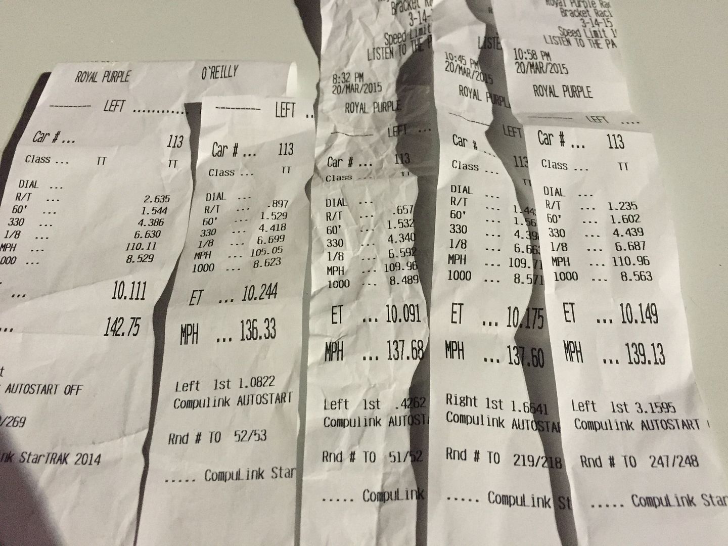

kjaglal76v2
Posts: 2214
Re: The Truth Behind The Subaru EJ-Series Engines -
Postby kjaglal76v2 » April 19th, 2015, 4:38 pm
Aaron 2NR wrote:
this the same one that did 9.77?
SUPERMAN2
Posts: 450
Joined: November 23rd, 2004, 3:07 pm
Postby SUPERMAN2 » April 19th, 2015, 6:55 pm
I dont think it made that
kjaglal76v2
Posts: 2214
Postby kjaglal76v2 » April 19th, 2015, 7:07 pm
Postby nervewrecker » April 19th, 2015, 7:11 pm
Posting so I can find this thread easy
Aaron 2NR
Posts: 6476
Postby Aaron 2NR » April 19th, 2015, 10:09 pm
same car

Postby 16 cycles » April 21st, 2015, 7:51 am
Treadstone hot parts rotated kit
Treadstone fmic
Killerb Header
Forced Performance HTA3582
Id2000s
Walbro 485 rewired
P&L/CompClutch twin disk
Cobb AP
P&L Brakes
Stock 17" STI wheels with M&H drag radials
axles popping...
http://forums.nasioc.com/forums/showthr ... 069&page=2

Postby Aaron 2NR » April 22nd, 2015, 9:40 am
Really impressive I'm not that brave
