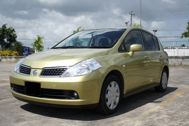

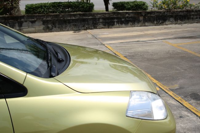

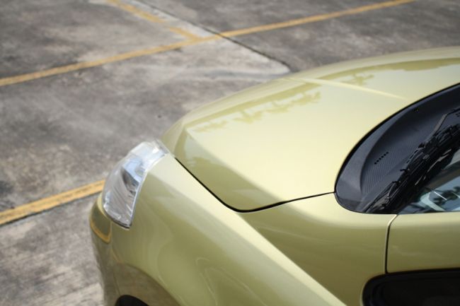

Almost forgot: managed to secure this pictures last night. These are from one of my few attempts at someone's car oterh than my own.
Items used:
Pinnacle Wash Mitt
Mothers Cal Gold Car Wash
P21S TAW (used as a stripping agent)
Mothers Clay kit
Megs Ultimate Compound
M205 (will explain later)
PC7424XP w/ LC white and green pads
MOthers Pure Carnauba Wax
I worked on this car at the owner's garage (had to trek all the way to south :lol: ) and used what lighting I could get + my brinkmann. Car didn't seem to be in too bad shape, apparently someone had tried to detail it before. After claying and stripping (not in that order), I found that some panels seemed to have more swirling than others. The bonnet had lots of fine scratches, almost like if soeone washed with rocks or steel wool :lol:
My approach was to find the "system" that worked. So I tried two different test spots on two different areas- one small area using Megs Ultimate Compound (4 passes), and another with M205 (4 passes). I found that on the bonnet, the M205 did little, but the Megs was amazing. ON the doors and trunk, M205 seemed to give decent results after 4 + 4 passes. Both were used with the white LC pad as a trial.
Here are the results - all pics taken in direct sunlight:
Close up of the paint - tried my best to show that no swirls existed after the detail.
Anyway, that's it for me folks. Cheers!

Also, how you find that M205 is on cut? (If you still here)
The Menz 4500 much lower.

ζђίΰД™ wrote:Done using DA Buffer, Meguiars ultimate compound & Auto Glym SRP. Wax still to be applied.
Car looks gud dude!
