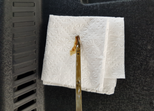

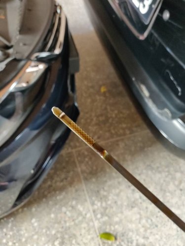

agent007 wrote:For all the Tucson turbo owners out there, observe the photo attached. Vehicle in question is a 2017 Tucson turbo 1.6 T-GDi with 7DCT transmission. The vehicle is doing 41,200kms and has been strictly maintained by Massy Motors. It has been through 8 service cycles.
Observe the color of the dipstick which shows the internal carbon and gum built up as a result of having direct injection with a turbocharger. Also observe the oil color. The oil smells burnt and 66% of the oil is gone. There are no leaks. So what's wrong here guys?
Massy claims they have been putting 5W-30 in the Tucson.
So are these issues attributed to the cheap oil they are putting inside the engine? Is it our heat and dust and stop and go traffic? Is it our fuel?
I would like owners of vehicles equipped with small turbocharged engines to pm me with pics of oil level and indicate make, model and year of the vehicle in question so that we can see what are possible trends etc, thanks.
Cruze 1.4t
About 61,000km.
Serviced at lsm every 6 months, used to be every 3 but since covid I extended it since I work from home now, they seem to have extended it also as they scheduled me for a another 6 months themselves as last time I serviced was last year October I think, and they have me scheduled for March.
Oil they use used to be acdelco oil but they switched to Mobil 1 at the last service (not sure why, availability?), honestly from since I got the car I've always been impressed with how clean the oil stays on this car, it never gets dirty for some reason and I usually check it every month or so going on 5 years.
I would like owners of vehicles equipped with small turbocharged engines to pm me with pics of oil level and indicate make, model and year of the vehicle in question so that we can see what are possible trends etc, thanks.20220207_230955.jpg
2018 FL Tucson, mileage 27,xxxkms. Last service was September 2021 outside firm as warranty expired in march of 2021. Oil used by firm was mineral oil, Oil used on last service was 5w30 fully syn mobil 1 with oem filter.This is what the oil looks like a few minutes ago, next service is March 2022. Vehicle is hardly driven and rarely reaches 5k before a service, I had the unfortunate experience of having the gearbox replaced in december of 2020, before my warranty expired.
Looks like that oil is breaking down in the engine, the Tucson uses 5w-30? I'd change the oil before March and try a different brand like Amsoil for e.g. as far as I know Amsoil works well with turbo charged engines, especially engines that are direct injected.
ProtonPowder
Posts: 1992
Postby ProtonPowder » February 10th, 2022, 11:40 pm
That engine oil looks fine, just in line with synthetic oil after a little bit of mileage.
The important bit is not to drive hard then park up with a hot turbo, and drive the car with the oil at full operating temp once in a while to get all the moisture out. With these turbo GDI cars the oil has to be changed right on time or mileage, but the oil looks fine.

I find your oil looks good. Looking like it slightly over filled too but that may be the angle. Try Amsoil Signature Series 5W-30 if you want to go longer intervals.
Oh and fuel additives in a DI engine is a gimmick. I could be wrong but how does this additive get to your intake valves? Seems like something to mess up your PCV. Seafoam is a better alternative so I was told.

I also am seeing Honda engine oils being sold abundantly. They also have seem to move from Exxon as their supplier. Won't be surprised if Shell also got the contract.
Most times when car makers have problems with their mechanicals requiring fluid they come out with a specific fluid for it.
I am an Amsoil reseller and user since it was launched back in Trinidad after taking a long hiatus and would be wrong to say I would ever recommend something over Amsoil.
agent007 wrote:
Dave wrote:Hyundai has developed specific oil for GDI turbo charged engines and it is available locally if one wishes to stick to what the manufacturer recommends.
219-4645 has Hyundai engine oil.
Are you referring to Hyundai Xteer? Cause that is based off of Shell Helix base stock. Need some more info on this so I can compare it against Amsoil.

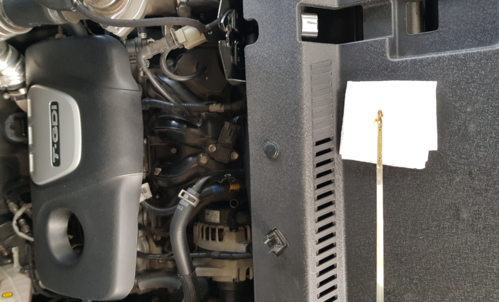

agent007 wrote:I find your oil looks good. Looking like it slightly over filled too but that may be the angle. Try Amsoil Signature Series 5W-30 if you want to go longer intervals.
It's one thing to change the brand of oil to go longer intervals between oil changes, but you have to also consider whether the oil filter can remain effective during the longer interval.
I use Amsoil oil (bought from Dave) in my car with a Mobil 1 extended life oil filter. I go for 10,000km between oil changes. But my car has a normally aspirated engine. I used to use Bosch Distance Plus extended life oil filters for the past few years, but I am no longer getting that brand of oil filter for my car, so I switched to the Mobil 1 extended life oil filter.

Okay thanks guys. It appears I was living under a rock...I never knew Dave was an Amsoil reseller. All these years I buying amsoil religiously by nearby car parts places when Dave coulda link a bess price? Nah man. One of our vehicles just concluded its warranty with massy, I will be in touch privately.
Rory, I used FRAM Ultra Synthetic for longer intervals (10k and more) with no issues in the past but genuine OEM filters can go 15k easy easy especially if the motor had amsoil in the last drain out.
