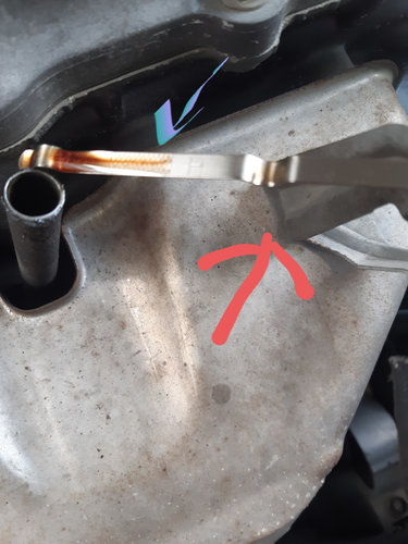

Postby daring dragoon » July 5th, 2021, 6:48 pm
[attachment=0]20210705_184615.jpg[/attachment}
What is the correct level to full in the engine when changing oil in a qg15 engine. The blue is where it full to but what is the bent in the dipstick with the red arrow? Is this the level the oil should be?
Posts: 18012
Re: Qg15 engine problem
Postby Dave » July 5th, 2021, 7:27 pm
By H or just below is fine
