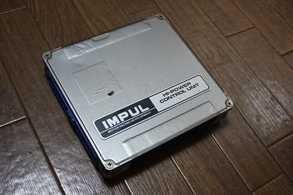

Postby coltspeed » July 13th, 2015, 9:13 pm
Thinking seriously about sourcing and obtaining on of these. Ive touched on most things around the engine but don't want to go in the direction of a piggy back, stand alone, mss etc. What are the pros & cons about this unit? Any information about this unit would be greatly appreciated. Thanks in advance.

Re: IMPUL SR20VE Hi Power Control Unit.
Postby skylinechild » July 15th, 2015, 8:24 am
the item in the pic is a slightly more aggressive ECU.
its meant for engines that have certain BASIC mods done to them( at factory) to extract a bit more power from the engine.
its a nice upgrade however you will need to ensure your engine has the necessary upgrades - ie cold air intake - full cat back exhaust advanced timing on the ignition..premium fuel...iridium plugs...performance air and fuel filters....possibly larger injectors....upgrade in the cooling system who knows...
however its an easy DIY without the headaches of a retune etc.

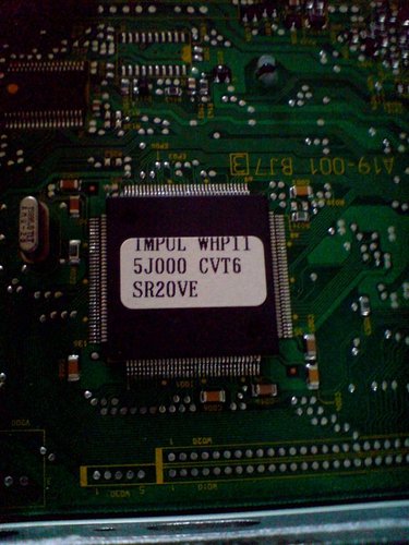

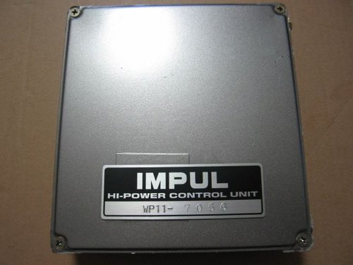

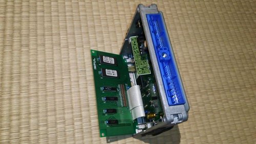

Picture #3 doesn't belong here, that is not a SR20VE ecu, looks like a regular P11 type ecu for the SR20DE (non-CVT) and utilizes a daughterboard.
It is a reprogrammed unit. It is compatible with the CVT, car stays stock and you plug in the ECU.
MINES also makes similar unit.
They are expensive unless u can get it used and that is still going to run you about $2000.
The performance of this unit can be enhanced by mods like skylinechild said, however they are programmed for premium fuel only unless u want to ping whole day. --> So that kinda throws fuel economy out the window.

Probably the best route might be one of the SR20VE units with a daughterboard. This allows you to reprogram it, you can go to the SR16VE tune if u want to go manual, you can adjust VVL activation points without the use of an external controller, you can use super, it will hold its value afterwards because anybody can use it and you can set higher RPM limits for manual use. This is a highly sought after feature because even the SR16 only goes to 7800 or so and if a guy has N1 or aftermarket cams he would need to rev to at least 8500.
