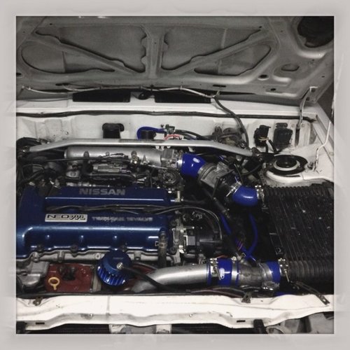

Postby THE SYNDICATE » August 5th, 2014, 9:06 am
My engine bay. So what advice I may give u is from experience and not what ah man pardna do!

Postby JesuEric » August 5th, 2014, 9:39 am
oh my ...(sheds tear) impressive. ...is that a SR16VE head or it just painted?

Re: SR20VE management
Postby THE SYNDICATE » August 5th, 2014, 9:42 am
original blue 16 cover not painted
