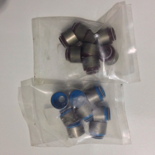

What price did motorist quote for the valve seals? And make sure that it's VE and not DE valve seals they selling you, cause they're different.

They said approx $850. I specified VE and they used the chassis number to confirm

Pretender wrote:They said approx $850. I specified VE and they used the chassis number to confirm
I figured that they would quote an outrageous price, if you interested I have after market ones.

Thnx, let me knw price and brand so I can consider
yakuza
Posts: 954
Joined: June 13th, 2007, 1:46 pm
Re: SR20ve burning oil
Postby yakuza » December 2nd, 2013, 7:32 pm
Brand: Supertech
Price: $200
