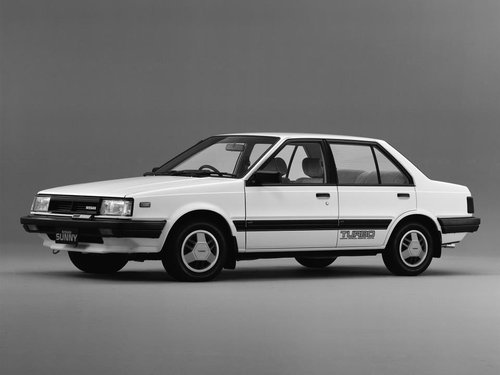

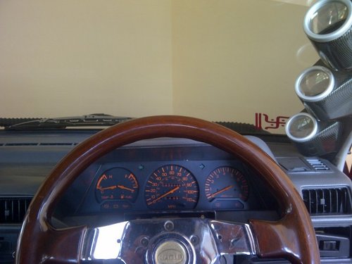

A little teaser pic I dug up.. :D

nice....!!

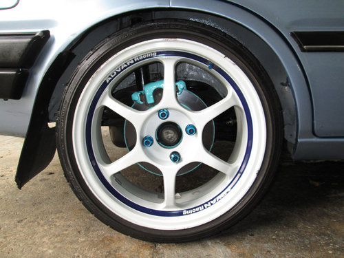

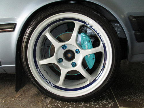

Brake upgrade:
front
To upgrade the front brakes, the user will have to change the car's front spindles to b15 (or similar). The ball joint is a bit too small, so a bushing will have to be made for proper fitment. The spacing between the bolts that bolt shock to spindle is also too small, so the top hole on the shock will have to be elongated a bit (1/4'' iirc).
With the b15 spindles, you can have a world of brake upgrades. You can use the b15 brake setup itself, the u14, p11, y11 wingroad, n16 etc. You can even install the skyline/300zx with some modification to the skyline rotors.
rear
the oem rear disc brake is almost impossile to get. User d_sunnyboi has a real decent rear disc brake conversion. i will let him give the details of this as he has already done it and knows all the details of the conversion.

my brake upgrades...

Well, you spoke to me and told me the details, but make a lil post about it so that in 2 or 3 years time, it will be around for another b11 like me and you wouldn't be as badly off as we when we started.
d_sunnyboi build. He car fresh, trust meh.

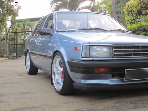

amazing build here..those rims :shock:
here's a link to thread: http://www.cardomain.com/ride/3103248/1986-nissan-sunny/

i always love a sunny eh but not so much with the side and rear flare stuff....i had a front lip till someone took it..lol...got back a skin but haven't gotten around to make it yet

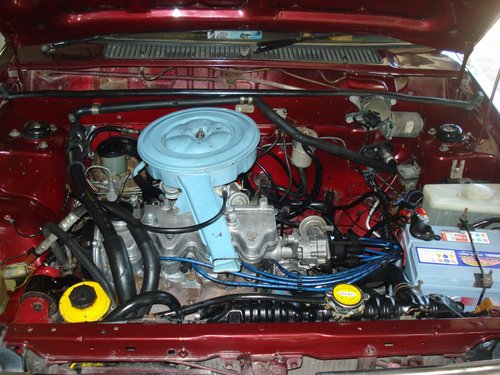

check me 5 mins work :D

I never say it was me :(
I wish though....hehehe....
I hada check you though.....

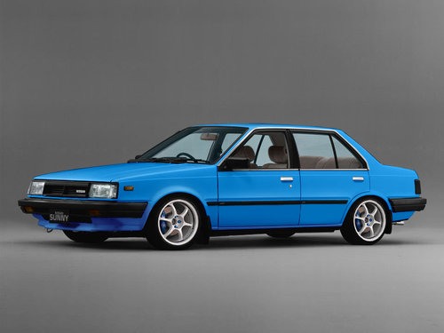

just an edit...

Do it in an charcoal grey nuh....with matte black rims..

sunny_boi yuh different jed..I notice the big brakes upgrade to the pic :lol:
