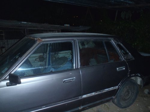

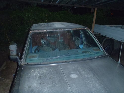

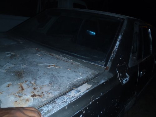

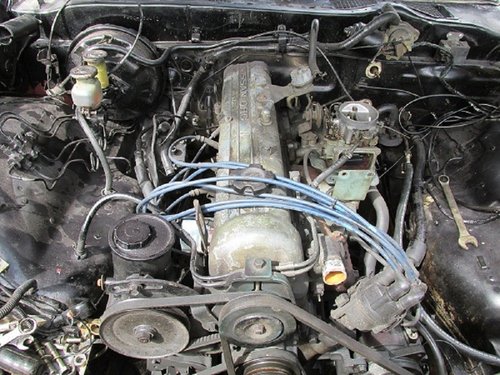

Update
Currently at
Body job 80% complete
Stock rim upgrade to 18s
Change out of front seats to single seats
Work on front dash 20% complete
Engine and tranny swap 30% complete [rb25de]
Headlights changeout 90% complete
Will update with some pictures later

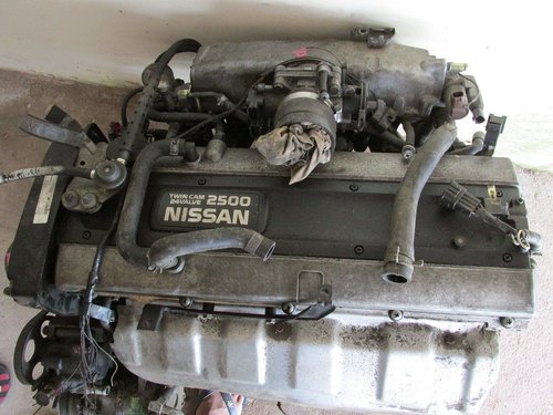

Postby killarpete » December 18th, 2012, 4:53 am
updated pics :)
new replacement rb20de
stock engine in very good condition being prep to be removed

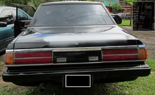

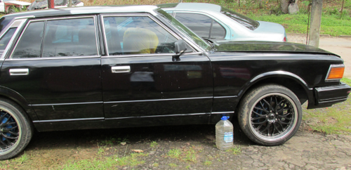

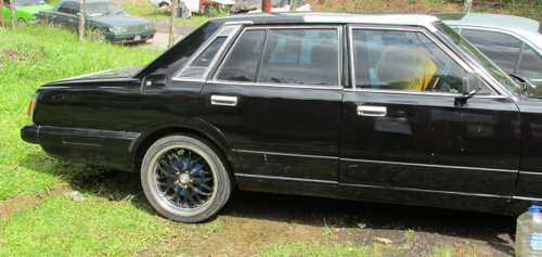

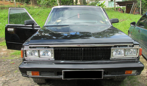

hey so ppl updated pics, let me no wat u"ll thinking and all advice r welcome,
So jus a lil more detailed run down of d wuk done thus far
EXTERIOR
-4 second hand 18" Azul Wheels - Speedmesh
-replacement rb25de engine&tranny
-replace trunk
-new head lights with super white bulbs (with home made harness 80% complete)
-cleaned all nickle strips/parts
-staighten and body work (90%)complete
-paint job (black with blue dust)
- change out of all shock
-inside and under the trunk sprayed with gravetex (rubber coated)
- entire underside painted with industrial blue paint
-new front wind shield installed
-all glass tinted 35%

killarpete the transformation thus far is excellent!! Not really loving the rims, but I'm sure it'll look better in person. Not too fond of those back lights either, but nevertheless, car looks really great!
killarpete
Posts: 8
Joined: December 16th, 2012, 12:04 am
Re: 280C (P430) restoration PROJECT HELP NEEDED
Postby killarpete » December 21st, 2012, 10:24 pm
Tarantula wrote:killarpete the transformation thus far is excellent!! Not really loving the rims, but I'm sure it'll look better in person. Not too fond of those back lights either, but nevertheless, car looks really great!

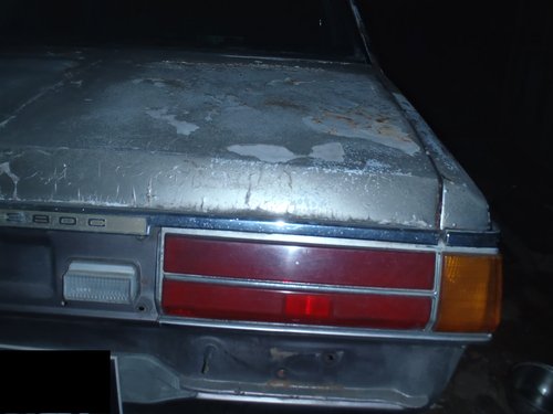

thanks, the rims i got it at an resonable deal, with respect to the taillights i plan on doing something with it wen i doing d finishing touch d body works (not sure as yet if u got any ideas let me know if u got any), Once its within my budget.

i do however like the back lights , i'm on the side of an ole school car should look old school .
you can update it with led bulbs or sumn so but i say keep the look you got .

project comin along nicely...would look a little better if u drop the ride height a bit...but it lookin good. keep us posted on progress.
