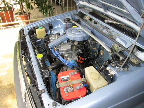

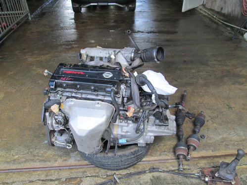

hey fellow tuners and veterans of the engine swapping world. i currently own a b11 sunny which is my pride and joy, i've begun upgrading it as my project ride, so far i've completed the brake and suspension upgrade. The brakes were upgraded to r32 4 pot in front and p11 disc in the rear and for the suspension i've used c33 tein fully adjustable coilovers in the front still stock in the rear. the last part of my upgrade is the motor in which i was lucky to obtain the sr20ve 20v out of the p12 gt which comes coupled to the 6 speed LSD gearbox. i bought the motor complete with axles, shifter, brake, clutch and accelerator(electric)pedals, harness, maf and brain box. i haven't started the install yet so if any of you guys know of previous installs feel free to comment.
thank you
the current motor still in car
new..
Last edited by d_sunnyboi on December 13th, 2012, 8:08 pm, edited 4 times in total.

No it doesn't come LSD, but the OEM HLSD from the USDM Spec V Sentra or Altima is a direct swap.
The installation will involve straight forward fabrication (bracket for driver side mount and custom crossmember), you will need custom axles also.
The electrical will be the challenging part, as this motor is OBD2, that is if you plan on keeping it OBD2.

You can also convert it to odb1 but that will involve buying odb1 distributor,ecu, harness , throttle body ECT, I have a wiring diagram for that engine somewhere on my laptop if you need it. Great engine you got there man ! Good luck
