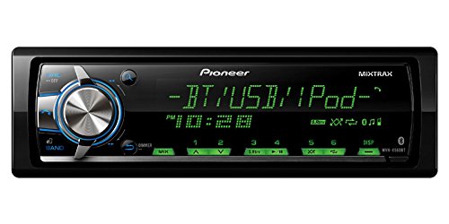

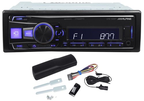

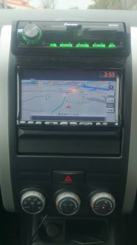

In this install the RoRo Xtrail's factory OEM deck with CD, DVD, Reverse camera display, iPod input, SD card slot, music storage was left intact.

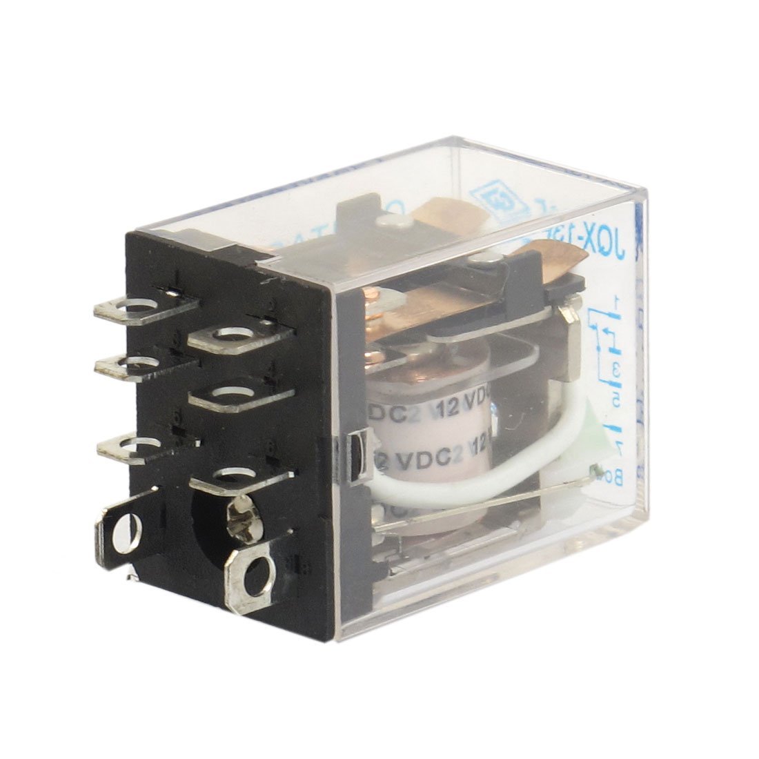

Four DPTD relays were wired to each of the four door speakers.
Take the right front speaker for instance:
The door speaker positive and negative wires were connected to the movable contactors of the normally closed contacts of one relay. The right front wires coming from the factory OEM unit were wired to the fixed contacts of the normally closed contacts of the relay. The OEM will play as usual when switched on.
(The 12V DPDT Relay has two sets of electrically isolated contacts, which are switchable, by energising the common solenoid. There are eight terminals.)
A Pioneer Digital Media Receiver (read....radio, bluetooth, mini-jack input and USB, No CD player) was fitted in the slot above the factory OEM unit. Each pair of speaker wires were wired to the normally open contacts of each of the four DPDT relays. (So the four pairs of speaker wires were wired to the four relays with the contacts in the normally open position)
The switching wire of the Pioneer was connected to the turn-on wire of each relay. The other terminal of each solenoid was grounded.
The operation resulted in this:
With the Pioneer off, you can play the factory OEM unit as usual. Even if you want, you can install a band expander in the antenna wire, and you would pull in the local stations, albeit with the lower Japanese frequency display.
However once the Pioneer is turned on, it switches the relays' contacts and the Pioneer plays through the four door speakers.

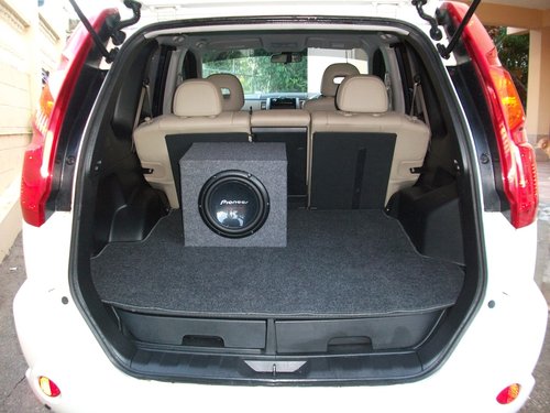

In one install, I even connected the Pioneer's subwoofer output to an amplified subwoofer.
Although I am an Alpine person, I used the Pioneer because it is cheaper, more widely accepted by the general public, and from the reviews, simpler to operate.
The Pioneer MVHX560BT sells on Amazon for US$98. Here it is about TT$1200.
The Alpine UTE52BT is on Amazon for US152.
Peace,
RR.

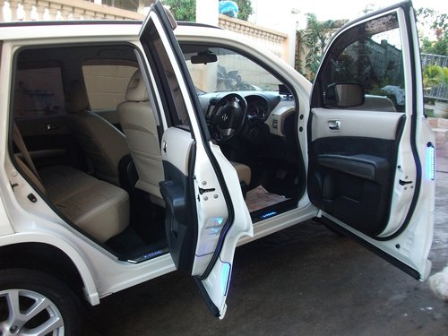

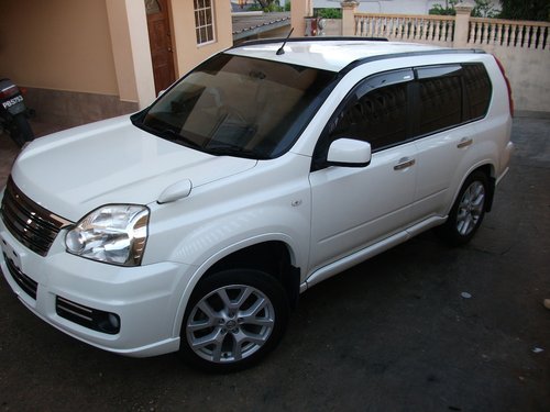

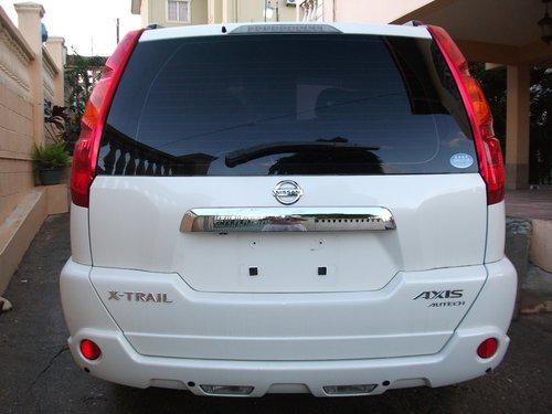

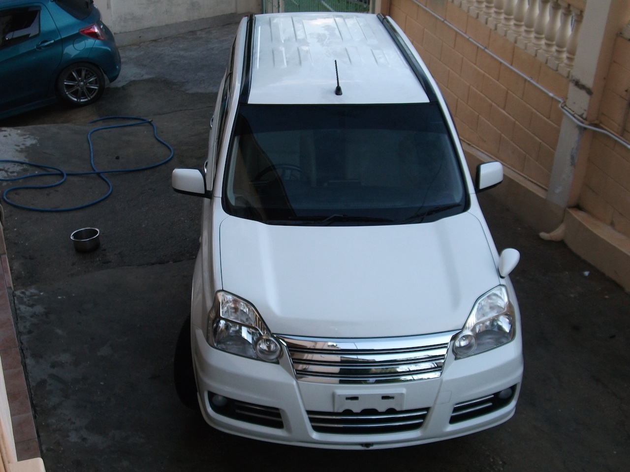

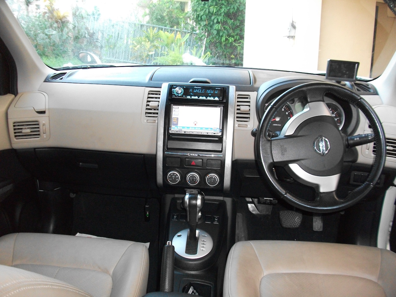

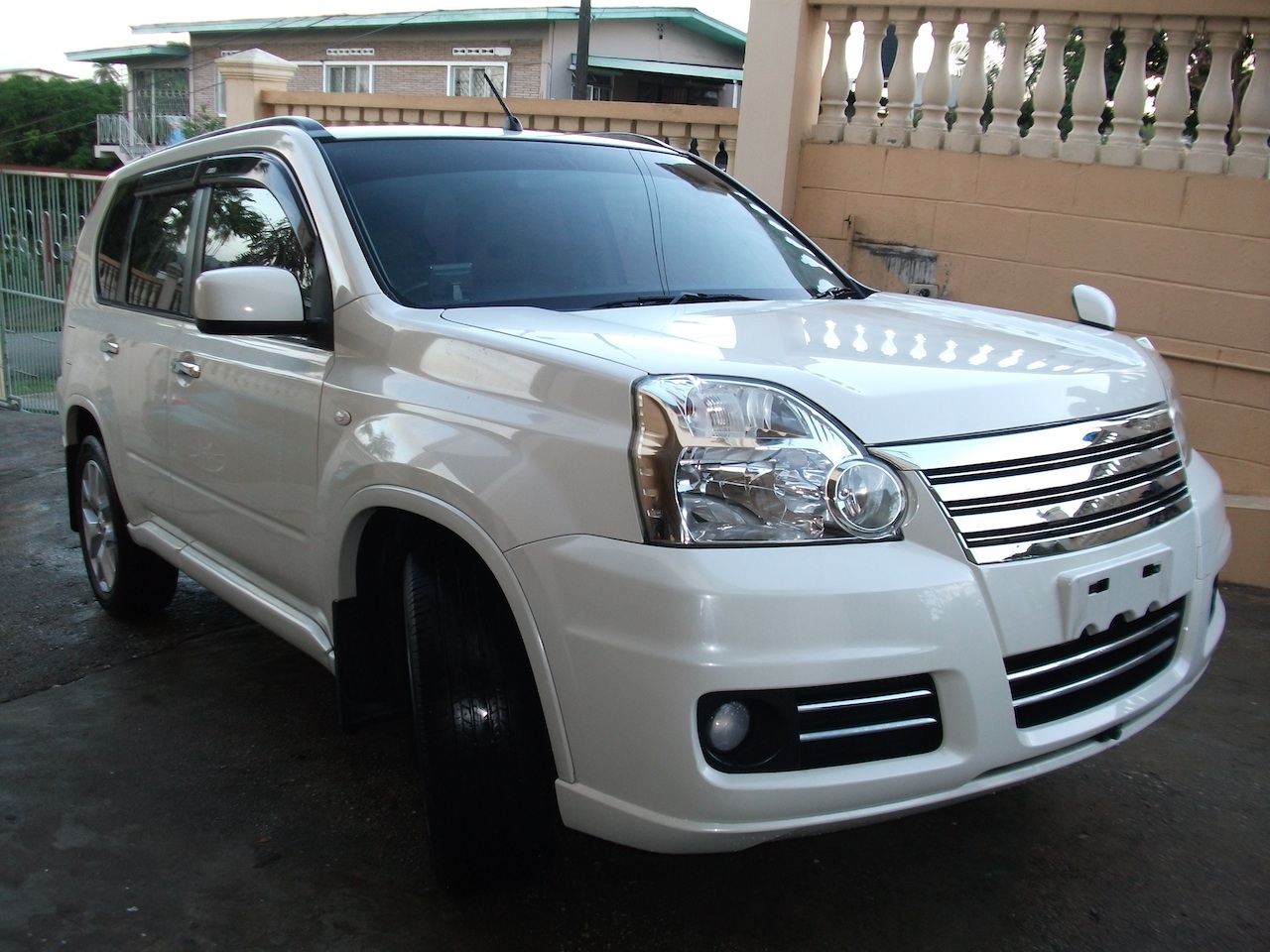

This is the T31 X-Trail Axis that was delivered to a customer in January 2015.
As you can see, a Pioneer Digital Media Receiver was installed above the OEM unit.
Both can be played.
A powered subwoofer was added.
Noticed the door LEDs and door sill covers with the X-Trail logos. There are Nissan Projection lights that cast a Nissan logo on the ground, but you cannot see them in the daylight. Real bling in the night when the doors are opened.
Running boards were installed later.
Don't forget to click on the photos for magnification.
Notice the 18 inch wheels ?
Peace.
RR.

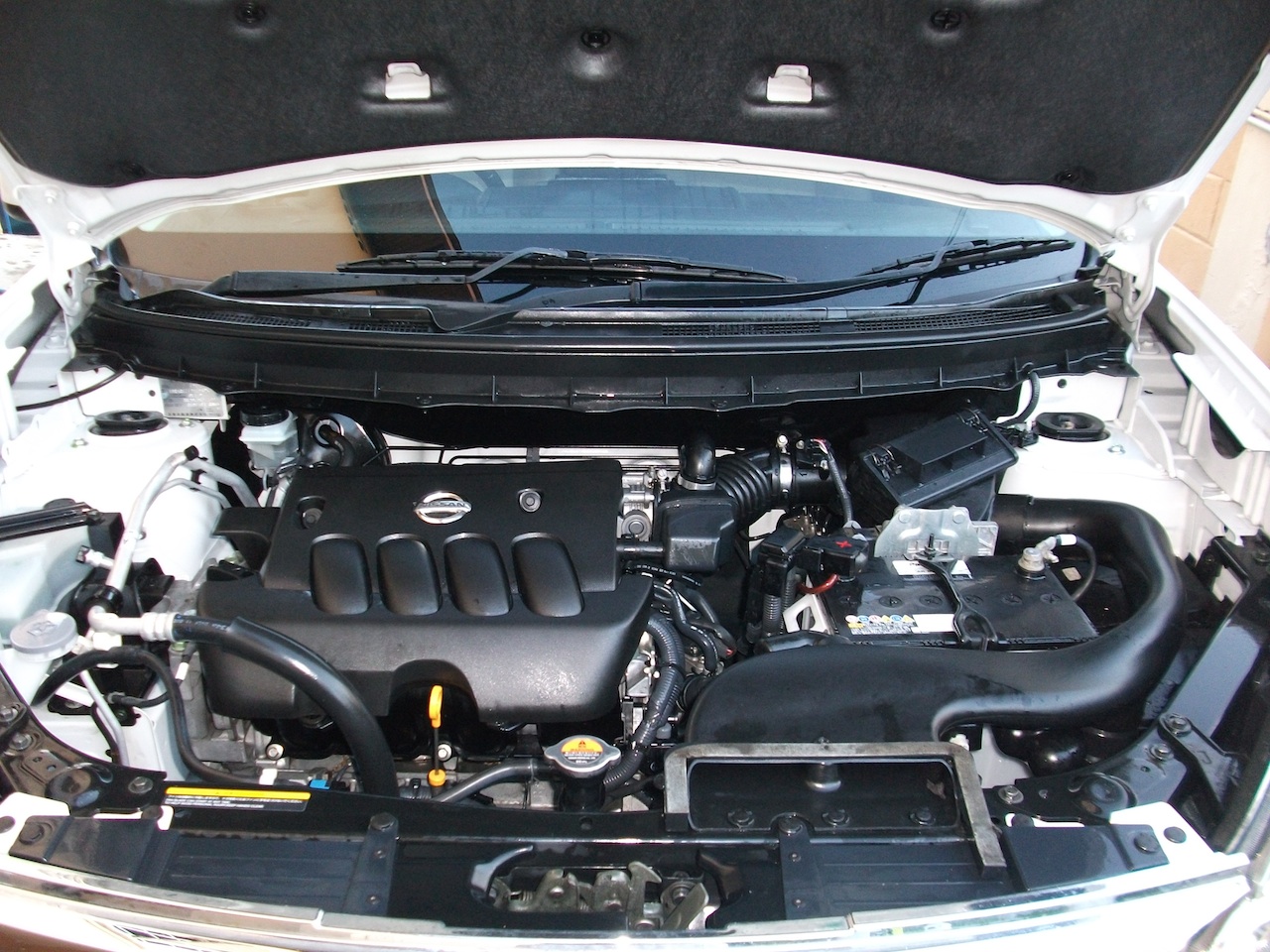

You may be interested in these also.
Peace.
RR.
