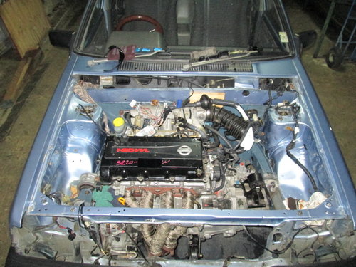

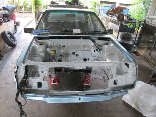

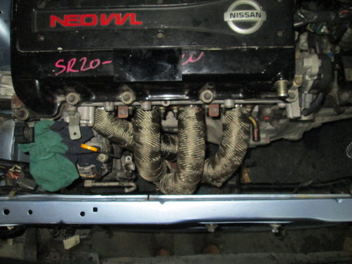

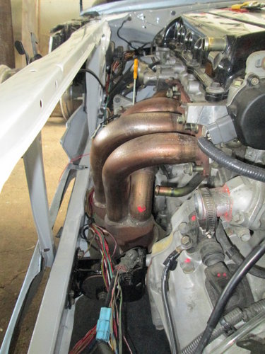

updates...first fit up..all cuts, welds, holes made...repainted today!!..looking great!!..
more pics to come soon..
the exhaust manifold that came with the engine has to be modified as it came out further than the radiator panel.

d_sunnyboi wrote:updates...first fit up..all cuts, welds, holes made...repainted today!!..looking great!!..
Progress looking good, but don't "modify" the exhaust manifold, that's how these motors make power.... instead move the radiator forward or use a thicker half size radiator.

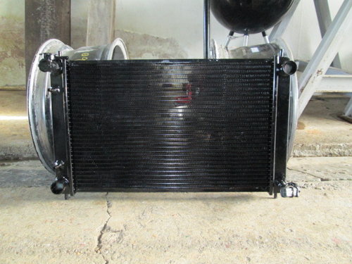

[quote="yakuza"][quote="d_sunnyboi"]updates...first fit up..all cuts, welds, holes made...repainted today!!..looking great!!..
the exhaust manifold that came with the engine has to be modified as it came out further than the radiator panel.[/quote]
Progress looking good, but don't "modify" the exhaust manifold, that's how these motors make power.... instead move the radiator forward or use a thicker half size radiator.[/quote]
well i understand what you are saying..but the modifications that would be done to it would not change the diameter nor volume of the individual runners, the runners are just going to be closer to the block and longer downwards to the collector box.
as for the radiator, that's what i wanted to do, which was put a civic koyorad but the advice i got made me make a custom made 2 core crossflow.

d_sunnyboi, someone did a swap of an SR20 de or det i believe and was gonna use a civc aftermarket radiator. the person did use it,but the cooling was not sufficient and the car overheated.
good choice on custom building the 2 core crossflow..
cross flow FTW! :P

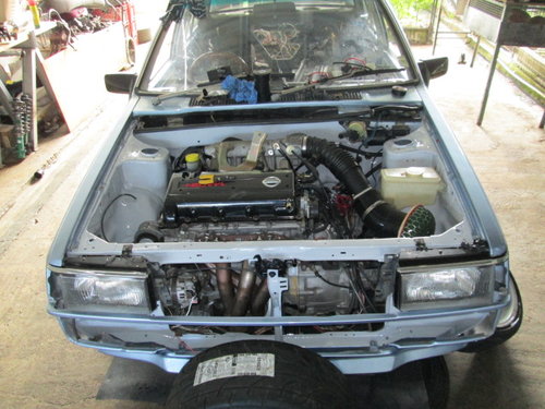

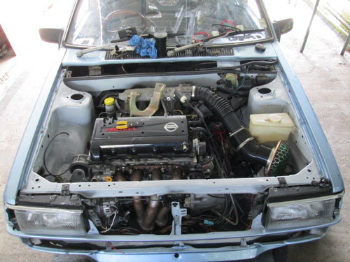

Postby d_sunnyboi » January 30th, 2013, 10:19 am
some new pics...
