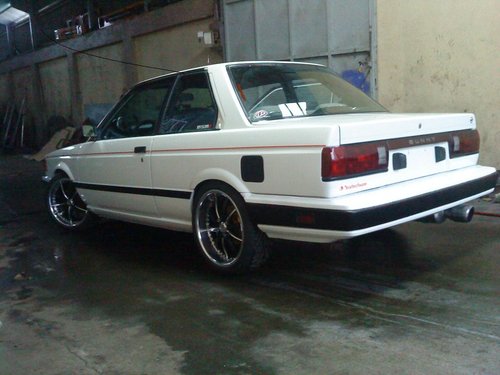

The Syndicate, this is the same guy who brought the mirrors from u and this is the car finished.

Postby black start » April 24th, 2012, 2:24 pm
concept2 car use to be ours before but not in that pristine condition. Good job dude. Saw it in west mall sometime ago and it looks even better in real.

concept2 wrote:The Syndicate, this is the same guy who brought the mirrors from u and this is the car finished.
nice nice... u weren't kidding about ur ride hoss. car looking real bess... great job!
all it missing is ah sr det.. hehehe :twisted:

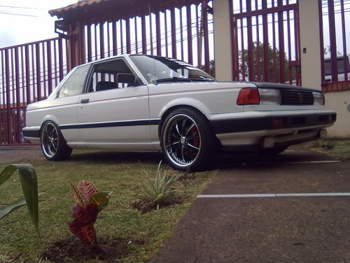

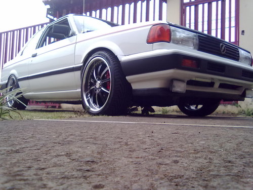

hello friends! I'm from Costa Rica. I have a nissan b12 2door . I would love one NISMO front for my b12, some of you can help me find the grill or front with fog ligth, thanks for your help!!
this my car!

^^noice.
what is ur spring/strut combo and rim/tyre size...i like the stance

chosen1 wrote:^^noice.
use rings 17 with 205/40/17 tires
are oem spring, cut two rounds of spring less from the bottom.
if you need help writing inbox!
