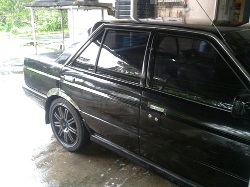

iVanhOracio
Posts: 160
Joined: July 10th, 2012, 1:31 pm
Re: ***NISSAN B12 CLUB***
Postby iVanhOracio » January 25th, 2013, 7:58 pm
the drop... looks better in person
yes, i know its dirty.... it yuh have issues come and wash it fuh meh

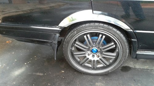

rodney117
Posts: 38
Joined: February 6th, 2012, 1:45 am
Postby rodney117 » January 25th, 2013, 8:35 pm
THE SYNDICATE wrote:rodney117, b14, ad18v and 22vf direct replacement. bolt for bolt!
pm user black start,he has a set of ad18v's for sale.
WAW guys thanks for such fast replys
BTW can u tell me where does the 22vf come from well i guess the ad18v is from the ad wagon lol kiran can u send me a pm with ur # an location much appreciated
Some picts of the car
