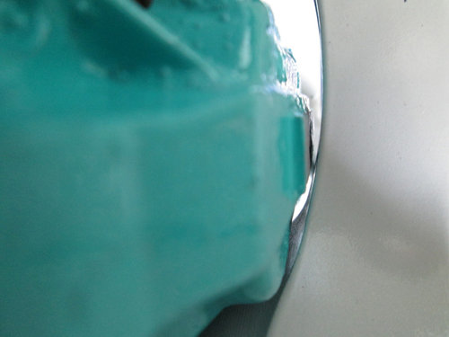

for the fellow '' serious b11'' guys...just posting up these pics of my brake upgrades..any questions you have feel free to ask!..

^real sweet set up there bro.

Postby d_sunnyboi » January 5th, 2013, 12:03 pm
[quote="black start"]^real sweet set up there bro.[/quote][quote="black start"]^real sweet set up there bro.[/quote]
yea bro..thanks...re-painted the calipers yesterday so i took out some pics and said let me post them up.

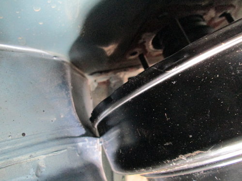

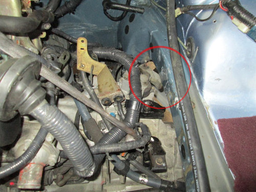

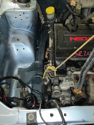

Postby d_sunnyboi » January 13th, 2013, 10:23 am
small update BIG problem...took out the e15 yesterday morning and did first test fit of the 20v into the engine bay!!..which didn't go as we thought!..turns out the 6 speed box is to long/girth by roughly 2 inches to be able to fit, so on that note gonna have to change the gearbox to the 5 speed hopefully i get an lsd one...on another note so much for being the only 6 speed b11 in the world..also tried fitting the u14 booster..with minor metal re-shaping would fit nicely!..
would post up the 6 speed for sale as i get a 5 speed lsd box!!!..

Postby .:PROZAC:.. » January 13th, 2013, 10:29 pm
I stopped by to see Riyad's install yesterday. Your 6 speed dreams may not be lost but you'll need to source a SER/Specv box out of the US which is pretty easy and cheap.
BTW Riy is a master electrical tech and the mass of spec and wiring diagrams and consults he was doing to get the pedal communicating with those TPS sensors, it's not going to be pretty if you're paying by the hour.

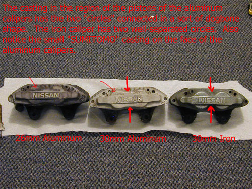

d_sunnyboi,all still may not be lost with ur box. how low is that car? if the box sits under the sub chassis,how low is it to the ground?
(i looking for a pair of 300zx calipers. do u know where i can get? need 300zx and not skyline. thanks.)
black start, the guy not from beujcal, he from warrenville.

Postby .:PROZAC:.. » January 14th, 2013, 9:20 pm
Only difference with the 300zx is that the NA calipers are 26mm(rotor and iron).
Why 300zx though syndicate?

Postby THE SYNDICATE » January 14th, 2013, 9:41 pm
^cause of offset of rims and the length of studs and not mention the height of my car.
to use the 30mm means i have to change studs and raise my car back up as the rims will touch the outer of the fenders.
with the 26mm i can use my same studs and rims(might need a 5mm spacer) but that can still apply to my application,and won't have to raise back up!
u sure the 26mm is iron and not aluminum?

Postby .:PROZAC:.. » January 14th, 2013, 10:12 pm
I'm doubting myself now, let me double check.
Good points to note with the offset, how much thicker is it when mounted? The trick isn't so much the offset actually, it's the spoke. I had +45mm clearing a brembo bbk.

Postby THE SYNDICATE » January 15th, 2013, 6:09 am
the caliper is aprox. 3/8 wider. meaning it will push out more than the 26mm ones.
i have on Advanti tuner 6's.the spoke design looks like it will clear but i haven't tried it yet to verify. more than likely i'll need spacers!
i'm sure you'll tell me it's aluminum calipers. lol

Postby turbosingh » January 15th, 2013, 6:55 am
Syndicate You might have to use R32 but depending on your offset you might still have to use spacers.Only R33 an up are aluminium.

Postby THE SYNDICATE » January 15th, 2013, 7:04 am
according to the thread and the pic,the 1990 300zx n/a calipers are aluminum!

Postby d_sunnyboi » January 15th, 2013, 11:36 pm
Update on install..got a experienced guy to look at the situation and the clearance issues are solved!!!
What was done was that the shifter arm was raised upwards to clear the chassis..
The engine is in the car on its four mounts, onto seeing about the axles!!
Syndicate..got them from deon or ''on the inside''..
was reading about the clearance issues..these didn't clear the wheels, but what i did was placed a washer between the caliper and spindle..so it pulled back in the caliper and cleared the wheel spokes.

the r32 u used, were the iron or aluminum ones? the spacers/washers were my plan B! :oops:

Postby d_sunnyboi » January 16th, 2013, 10:25 pm
correct..these are aluminum...from the 300z.
