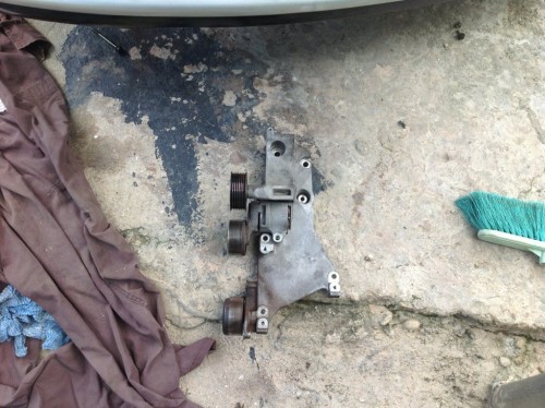

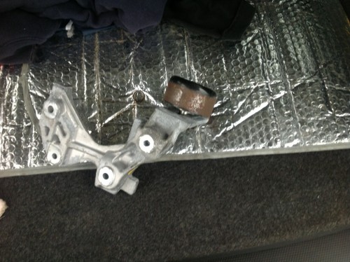

Btw any of the pics you posted is of the bracket

Nah...the bracket is much smaller...shorter also....didn't take a picture.....the air conditioning compressor will be bolting directly to the block now instead of the bracket...

Yeah..that's it...bolt that to the block...install a.c compressor...your good to go

This wasn't as hard as I thought. Once you got the right tools you're good too go. Works like a charm now and only cost $410, $300 for the bracket and 109 for the belt. This is a great DIY project. Only prob now is that you have the 4wd light on in the dash board but that's sum you could live with, instead of the unbearable noise of a generator gone bad. Thanks Densil.

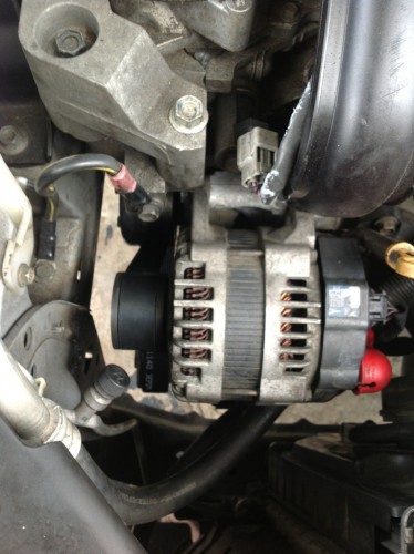

Buy the bracket for the 2wd remove the 4wd bracket also the alternator will have to come off. Replace with the 2wd and bolt back up the alternator by a 2wd belt upkeep sum I think and you're good to go you'll just end up with the 4wd light staying on.

Hey guys i know this is an old thread.. but im in need of some advice on this same problem with the generator pulley sticking and causing the tensioner to rattle. I tried the conversion but used the my same alternator and it didn't line up properly with the other pulleys. The mistake i made was not taking the altenator from the 2wd hr15. I only realised it after i returned the bracket and belt to the foreign used place and was lucky to get my money back. I also got some advice from a mechanic working in massy and he said that even if i did use the altenator from the 2wd the car would eventually cut off since the 4wd is wired to the epc which im assuming is the same as ecu. So before i go and do the conversion again i want to know how it's still working for you guys. And instead of changing the bracket could i just use a shorter belt and leave out the generator and the pulley below it and just use the pulley infront of the generator basically keeping the same belt layout.

Thanks for replying. Glad to hear it still works. Also is it that the pulley actually sticks or is it more likely the generator it self is sticking and is there a way to just let it freewheel? And how come the 4wd light doesn't come on when it does stick. I find it weird that if there is something wrong with the generator or just the pulley the light on the dash would come on but it never does

I think it's probably the generator... I could be wrong.. But after the conversion..It will be free wheeling... The belt does not go on the generator

Can you give me an idea why when i tried the conversion it didn't work the altenator seemed to be a slight bit sticking out more than the other pulleys. But the belt that i got from the 2wd hr15 fit perfectly on my alternator and everything else such as ac and crank pulleys. The only thing is the belt just had a slight twist and would jump off the ac compressor by one groove. Was i supposed to use the altenator from the 2wd hr15 even though it had the same amount of grooves as my alternator.. because what i noticed too was my alternator had basically no play at all on the 4wd bracket it was hard to get off and even harder to get on .but on the 2wd bracket it wasn’t as hard it could just slip on and off it didn't have any kind of play but was alot easier to move around on the 2wd bracket.
