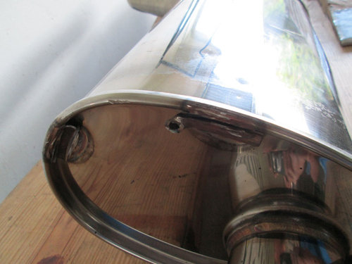

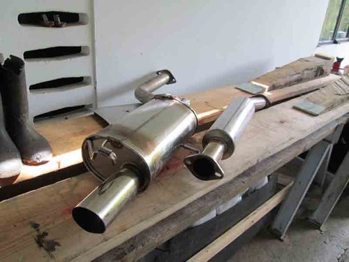

Postby d_sunnyboi » December 17th, 2012, 12:51 pm

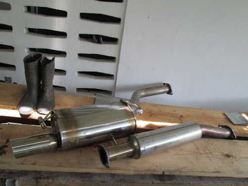

got the exhaust system for when the install starts, fujitsubo 2 3/4 inlet silent and a 350z flow through resonator also 2 3/4 inlet/outlet both pieces stainless.

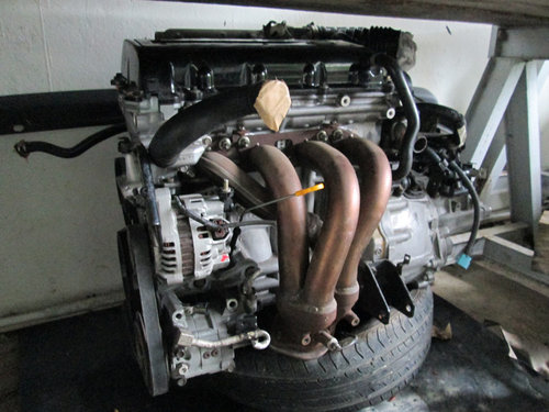

Postby d_sunnyboi » December 25th, 2012, 10:35 am

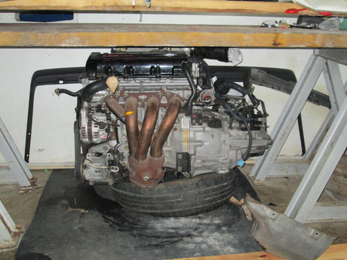

just removed that big ugly heat shield over the manifold to find this!!..huge 1 7/8'' individual manifold pipes, kinda looks like some sort of stainless also..not sure though.
black start
Posts: 7974
Re: project sr20ve 20v 6 speed install.
Postby black start » December 25th, 2012, 12:01 pm
not stainless steel.
SS has chromium in it which gives it that distinct silver/chrome look.
but the manifold looking hard none the less.

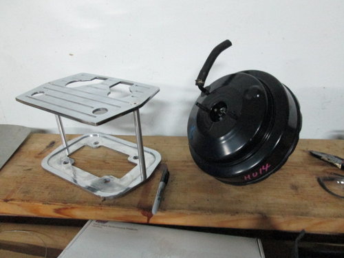

just a small update..nothing to do with the swap really...brake upgrade...u14 double diaphram booster and summit racing optima battery holder.

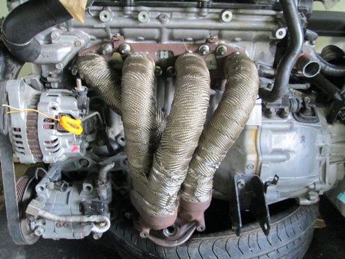

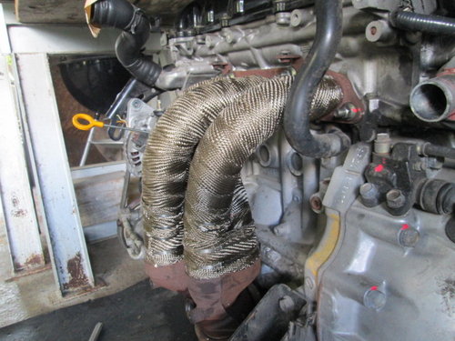

Postby d_sunnyboi » December 29th, 2012, 7:54 pm
titanium DEI heat wrapped the runners plus used the stainless steel zip ties..much easier as it being out of the car..
