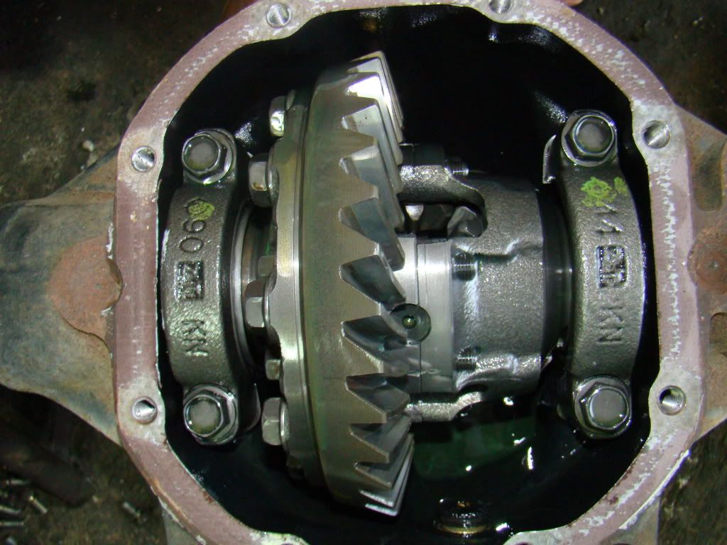

280c is usually 4.1, DONT go 4.6 on a rb , trust me , unless you into drifting.
to know the 4.6 check for 2 things,
1. The diff housing is Aluminum , scrape it and see if you see silver,
2. Then check the around the lip where the bolts go and look for 2 Half Moon or two Thick C looking things , if theres none is a 4.6, if where the driveshaft bolts has a square flange its a 4.9
The 4.1s and 3.9.s have the 2 Half Moon or C like looking things , 280 ones has a steel housing and is much more heavy.

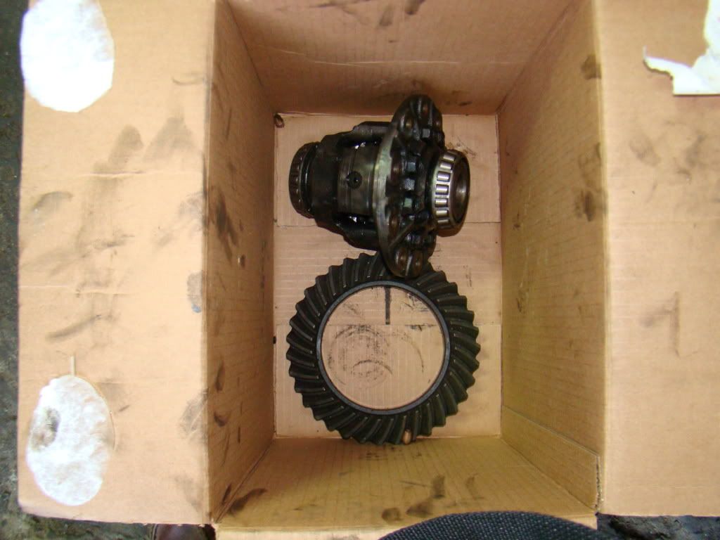

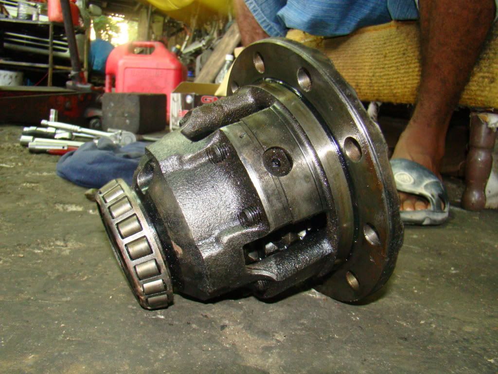

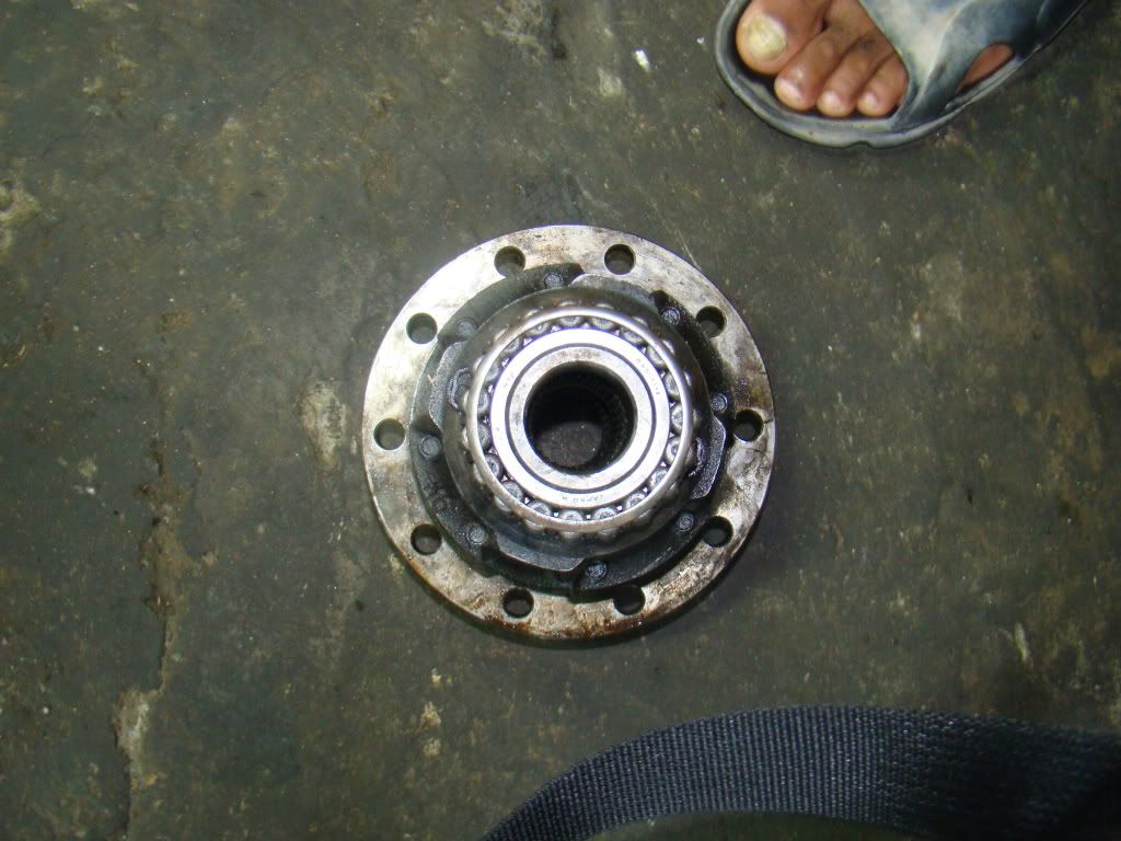

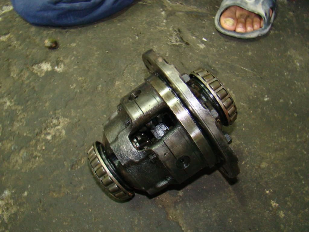

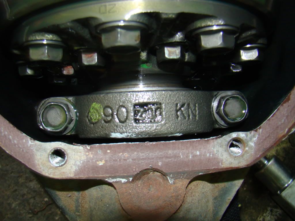

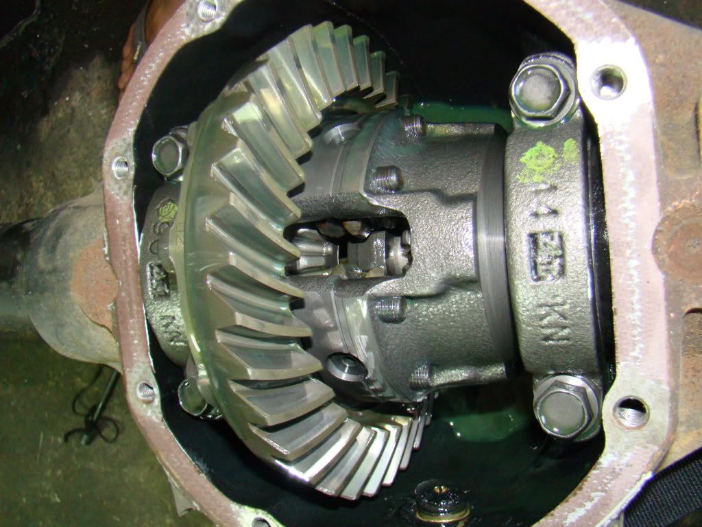

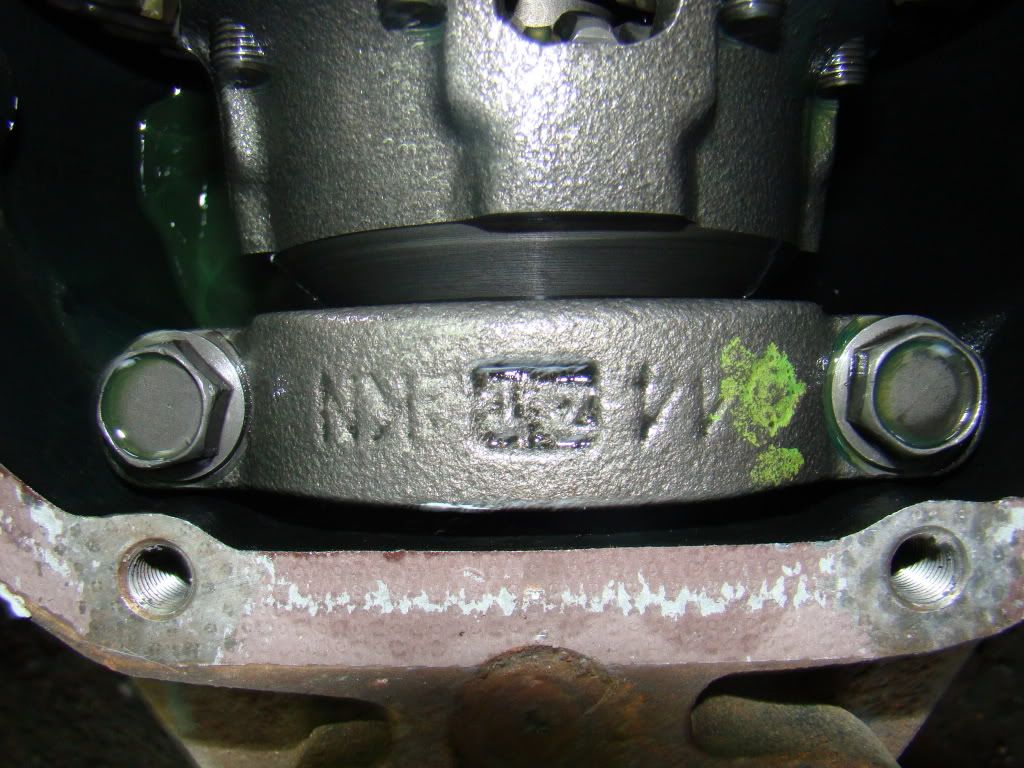

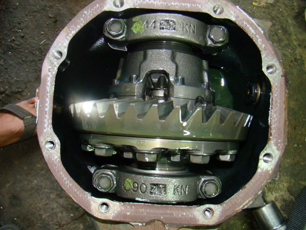

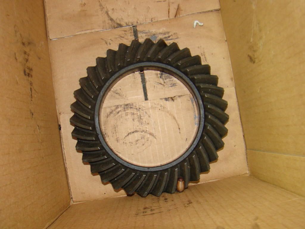

Postby miguel granville » June 27th, 2009, 10:02 am
ok fellaz man get ah d22 frontier diff free
its lsd and also get extra lsd guts
but the thing is the crown wheel runnin 35 teeth and the pinion has 9 teeth so thats a 3.9 ratio
dont know if that is any good for an rb tho
And the extra guts
rx80
Posts: 679
Joined: September 12th, 2007, 5:13 pm
Location: TOYS "R" US !!!!
Postby rx80 » June 29th, 2009, 9:37 am
Good, i'm so scared now last time i saw a diff scrapped like that i ended up changing three complete 'pumkins' because the guy could not set it up correctly.
Is there any one in TRINIDAD that can set up a diff correctly?
3.9 is actually a good ratio for a daily driver didn't the skyline come with this ratio.

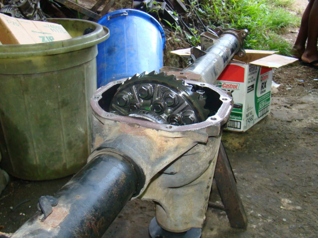

Postby nilgoat » July 14th, 2009, 8:34 am
610 rear with p11 brakes
been done already... and proven to take the power
