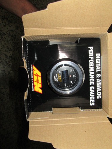

Postby d_sunnyboi » March 14th, 2013, 5:17 pm
new..''proper goodies''...AEM wideband kit..

Postby black start » March 14th, 2013, 7:53 pm
tuning with wideband an thing :)

d_sunnyboi wrote:new..''proper goodies''...AEM wideband kit..
wah help to install it? :mrgreen:
i bought mine recently.... worth every penny! :P
Re: project sr20ve 20v 6 speed install.
Postby Ted_v2 » March 15th, 2013, 12:55 pm
How much did that run you?
d_sunnyboi
Posts: 299
Joined: April 30th, 2010, 8:13 pm
Location: trinituner.com
Postby d_sunnyboi » March 15th, 2013, 3:34 pm
1350vi for the wideband kit...tuner imports.

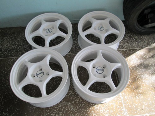

Nothing at the moment...just some new staggered wheels...enkei RP01...the ride was rough with the low profile tires so I down sized to 16 with 50 series tires

Postby d_sunnyboi » March 24th, 2013, 6:18 pm
enkei RP01
.:PROZAC:..
Posts: 4195
Location: Mississauga,Ont.
Postby .:PROZAC:.. » March 24th, 2013, 7:03 pm
hahah , love the rim choice. The over 20V swap is running the same shoes.
