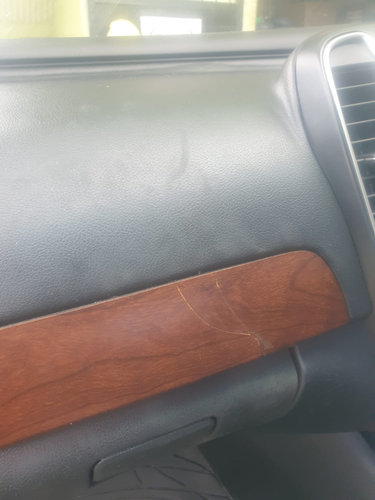

nav123
Posts: 3
Joined: April 23rd, 2024, 2:27 pm
Re: Blubird Sylphy Owners club
Postby nav123 » August 3rd, 2024, 2:43 pm
Good day anyone knows where to get nissan sylphy g11 wood grain finisher thanks set or the piece over the glove box
