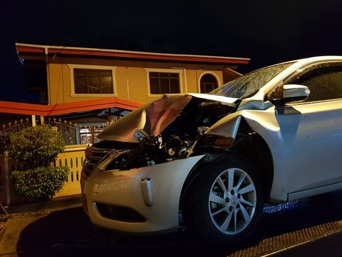

Good day, I'm in urgent need or help. I'm looking for a front shell for the new model Sylphy/Sentra B17 (2014) preferably with the HID lights or any body parts I can get to repair this car in the picture below will be useful. You can whatsapp me 715-5051. Thanks.
