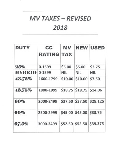

Postby ramishrrr » January 28th, 2018, 4:20 pm
Sorry Peter.
Since January this year the government has even further increased the taxes on ANY motor-vehicle with an engine 1600cc and above, be it Hybrid or not.
I am attaching a sheet showing the increases.
Peace.
RR.
